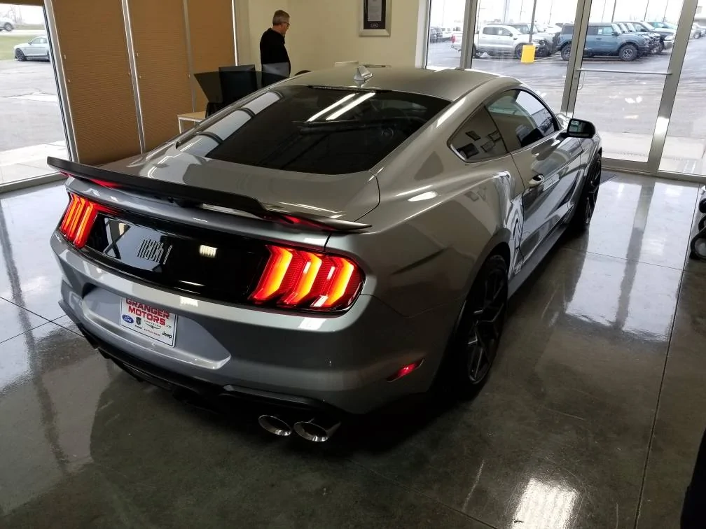

Nice Mach 1, congrats! Also, Granger Team rocks! Such great folks and always willing to help on these forums.

Thanks for letting us help you out Victor. The Mach 1 looks great and I'm glad you had an opportunity to stretch it's legs on the way home.
Thanks for letting us help again!
