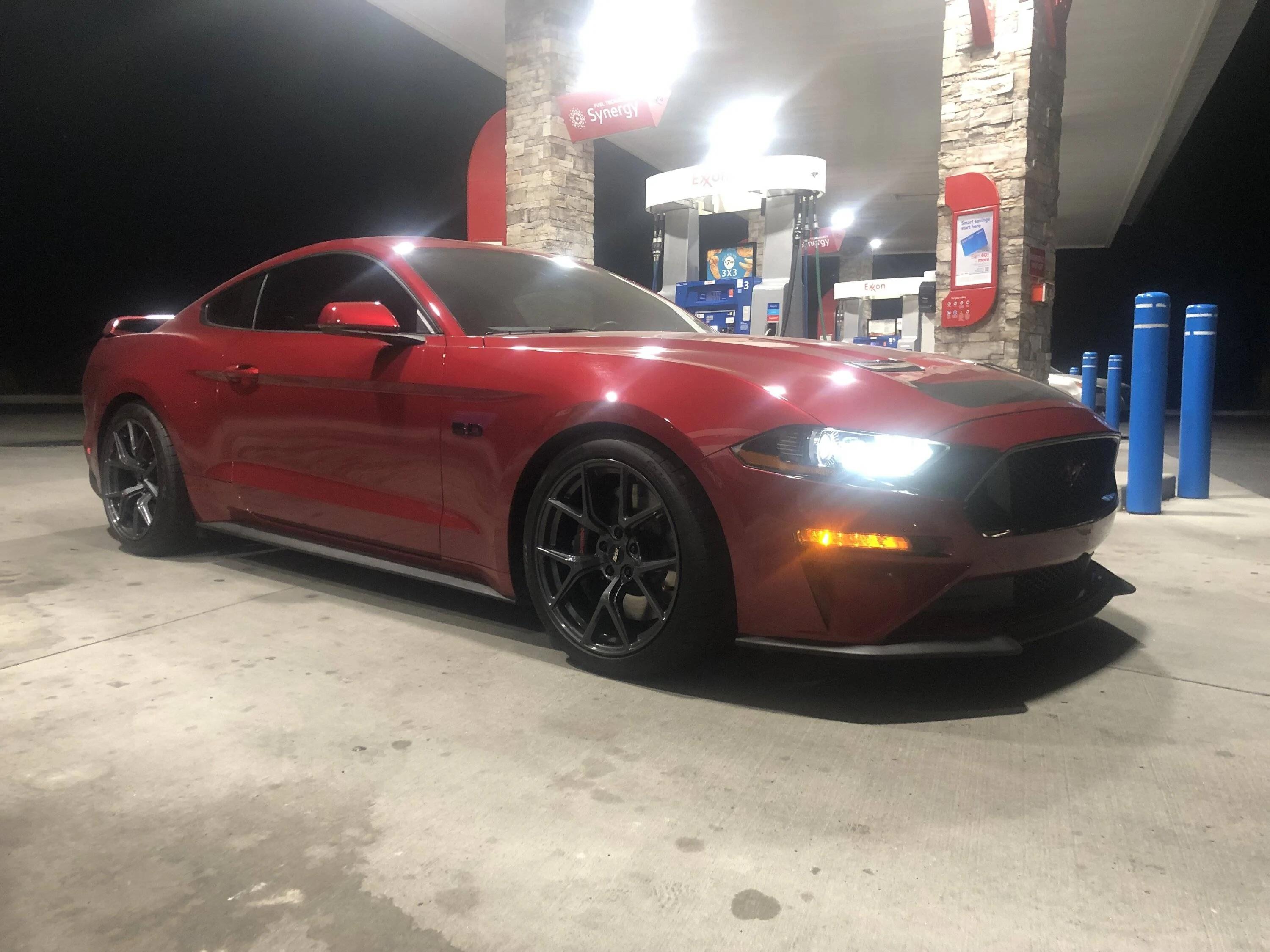

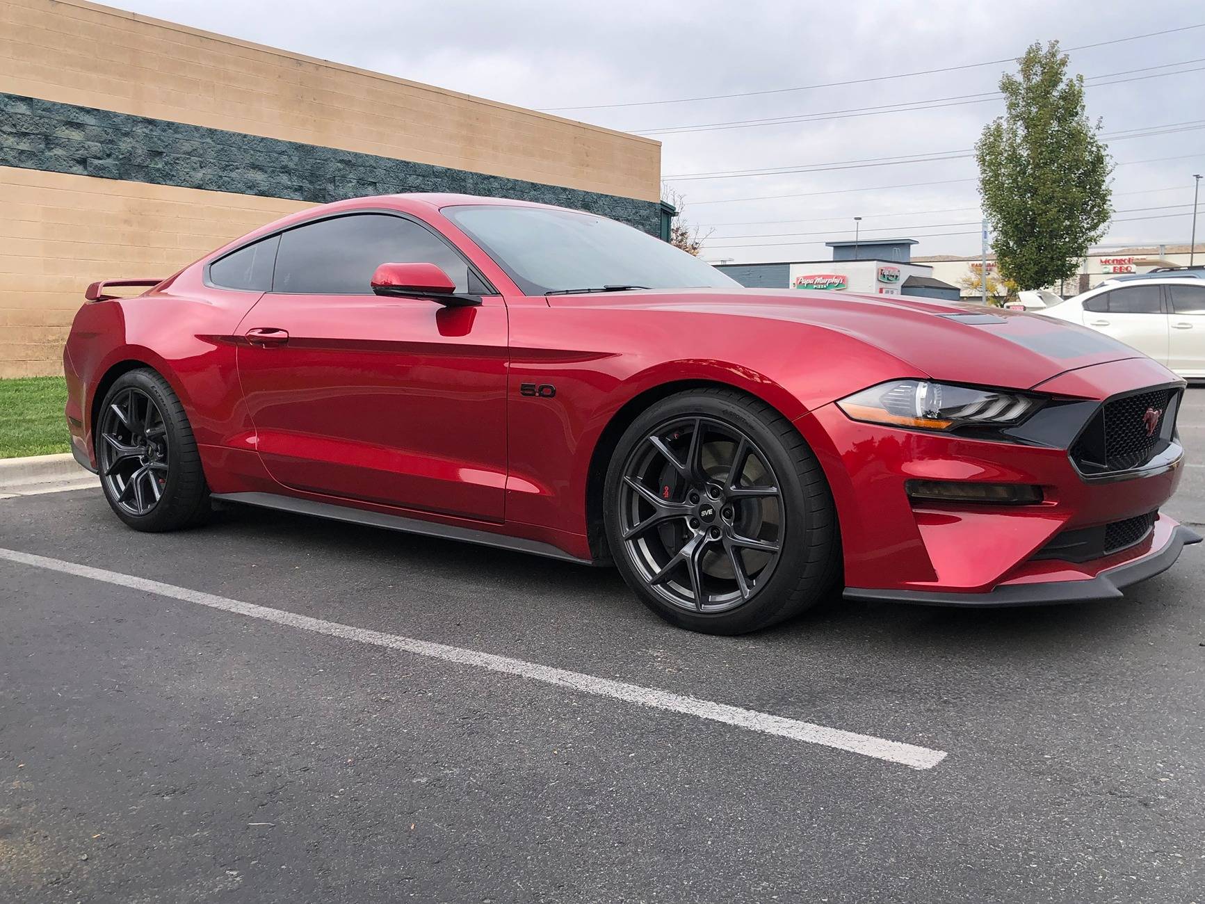

Before and after.

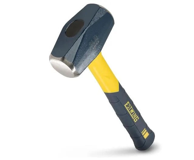

I'd also recommend a good short sledge hammer for the bottom front strut bolts. In the vid that I watched, the guy had one like this. I have a pretty big construction-type hammer, long handle and pretty heavy head, but I had to hammer on it literally hundreds of times. It was wearing me out because there isn't much space to swing, so it took quite some time for the bolts to come out.

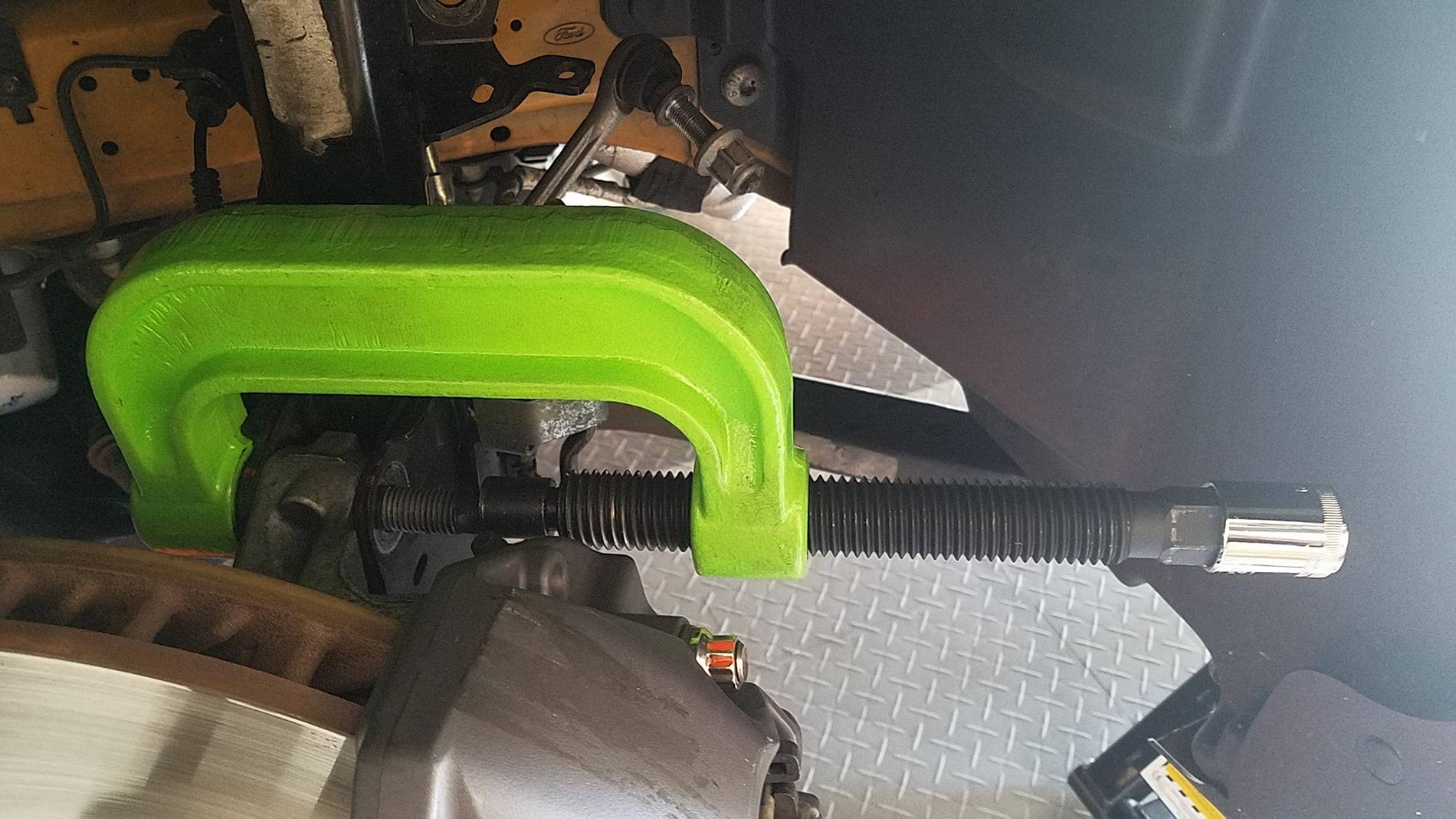

I switched from short-handle sledge method to ball joint press method. Works great and is easy.
Great idea! Funny, I had a bearing press that I rented for the job (didn't use), so I had one of those but didn't think of that.

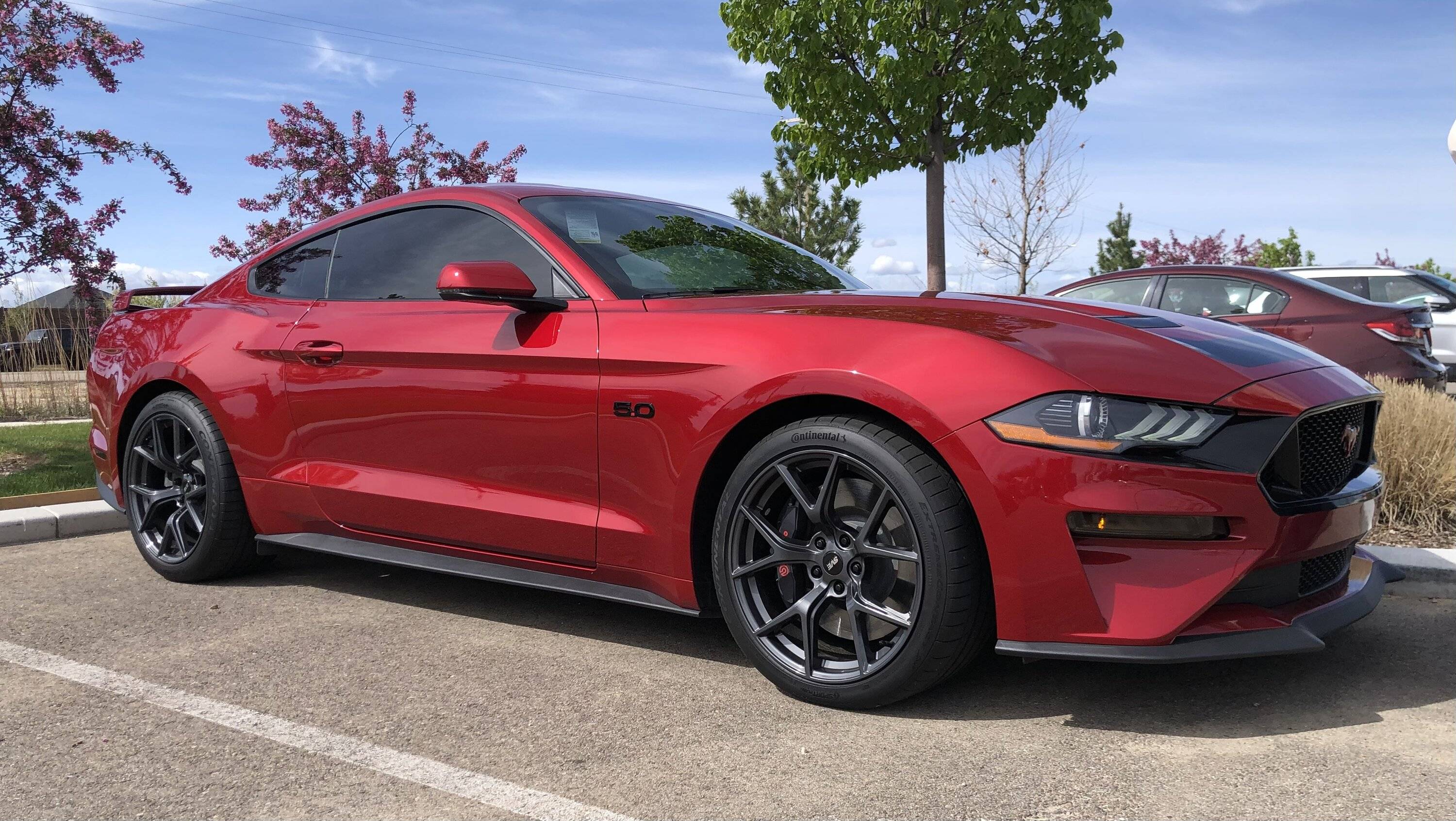

Here's a before/after with a better after pic.
I'm not young anymore, so the drop is perfect. I didn't want it slammed.

It really is a great drop for a daily. Nice not to have to worry about scraping.
