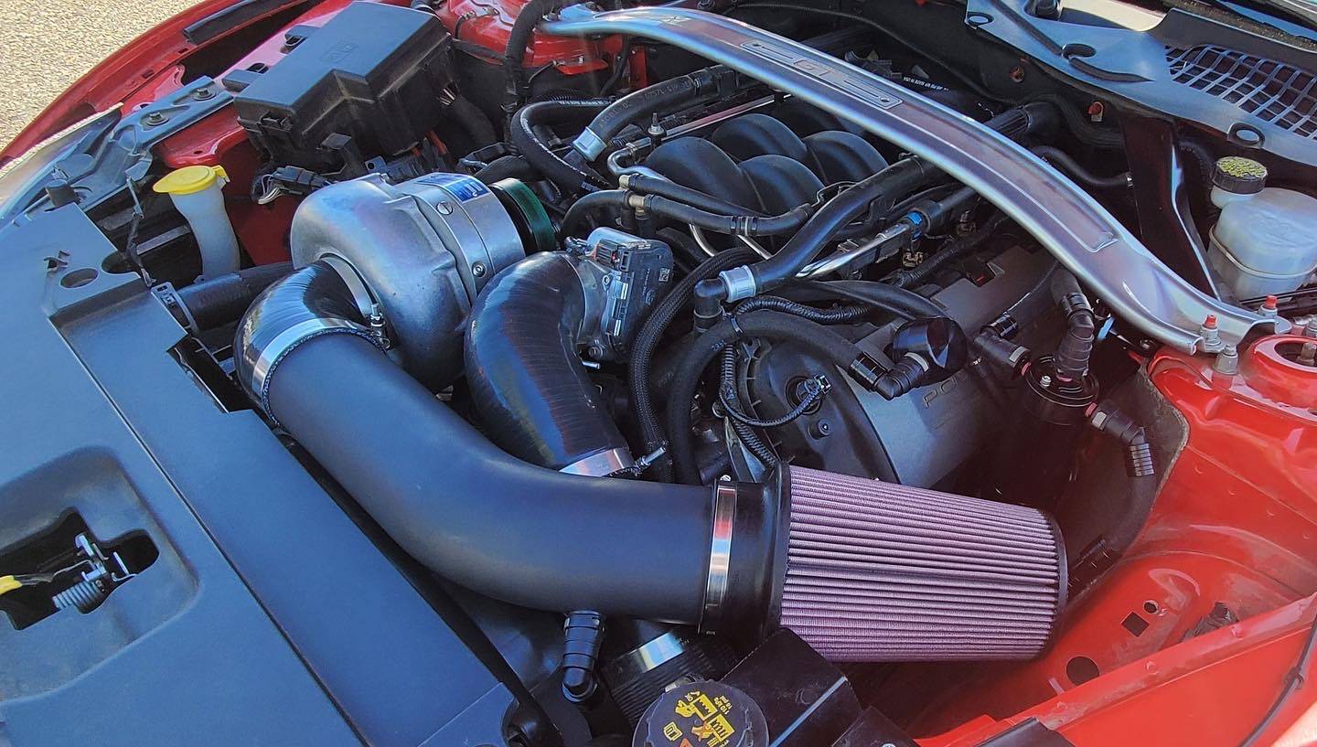

Hi all,
I’m ready to make more power and ultimately have my car run better. I have a 2015 Mustang GT, manual and 3.73’s. It does have boost from a stage 2 Procharger P1X (3.8” pulley 6-rib, passenger mounted), in addition to FIC1000cc, 2018 manifold, and little odds and ends engine wise - OPG/sprocket, and catch can, as well as a recently added twin disc.
Currently, I have a tune by PBD but would like to get it retuned but by either AED, Lund, or someone else; any suggestions? Unfortunately, I don’t leave near an E85 station so I’m limited to 92 pump and octane booster which is plenty for the standard 3.8” pulley (rated at 9psi) but I do rev it out to 7500 rpm’s which feels decent; obviously right at the peak -as any centri should- although what can I do to make more ‘mid-torque?’ Is it wise to pulley down to get more umph out of my midrange or is that mostly a tune thing? I’m not looking for a TVS feel but would like it to pick up just a bit more In that area.
What modifications should I do or would others recommend to help achieve more mid-power and hopefully see mid 700s wheel?

What does it make now? If your only running 8psi you could probably bump the boost up a tad but on 91 octane it seems like you'll see danger zone pretty fast. Honestly where your at its basically fuel system and E85 or just leave it alone.

No clue. I’m thinking low 600s. I originally used 91 until I moved to Washington where it’s 92 octane.
