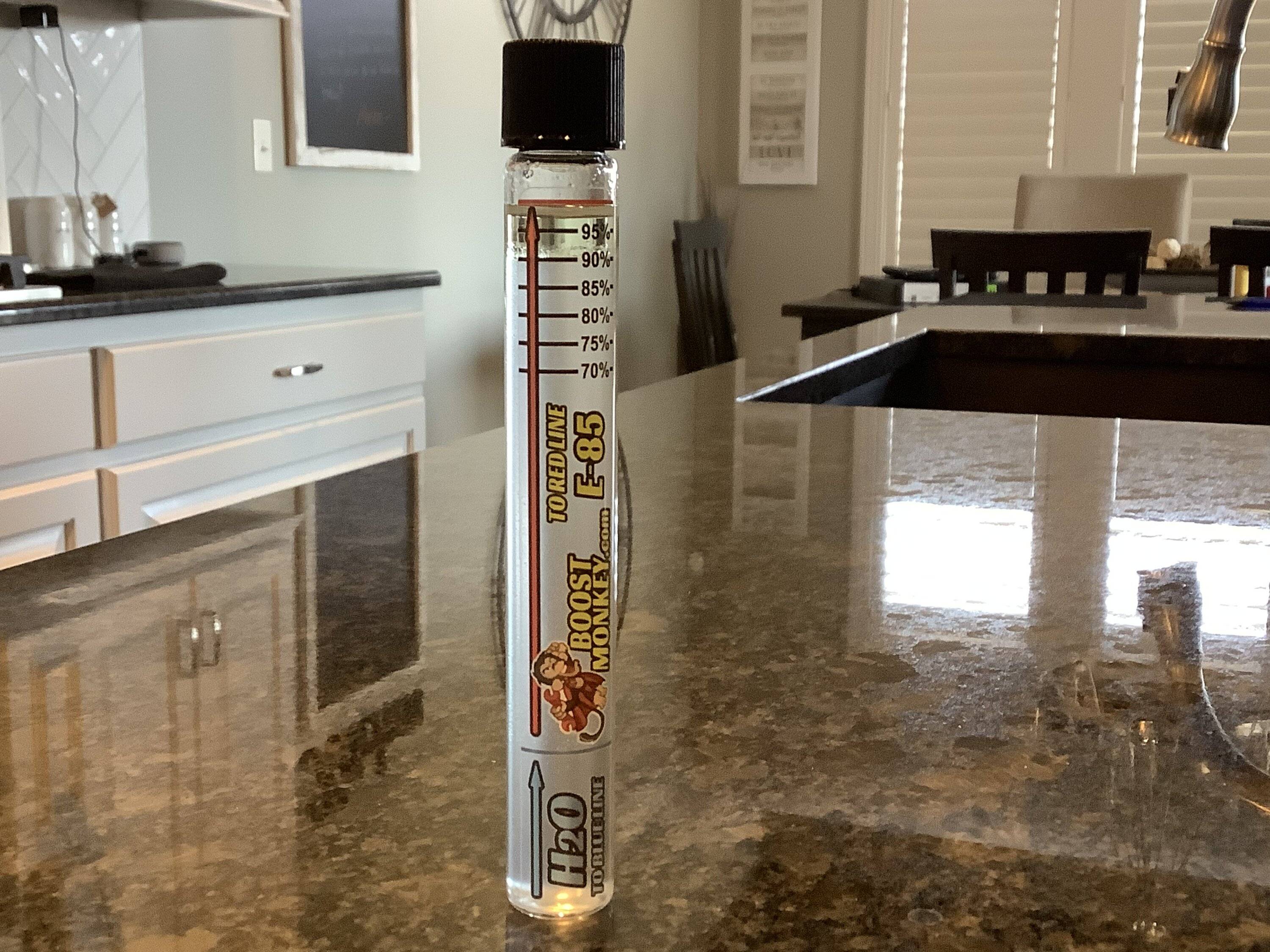

I ordered One Ethanol S from Real Street Performance and it arrived on a pallet, via truck with a lift gate and a pallet jack. This was very convenient for me. It out at 90% ethanol content too, so it’s good stuff.
There are also a few other companies that sell E85 by the pail.
looks like good stuff but for $10+ per gallon the biggest advantage of E85 over high octane Dino juice pretty much goes away.
