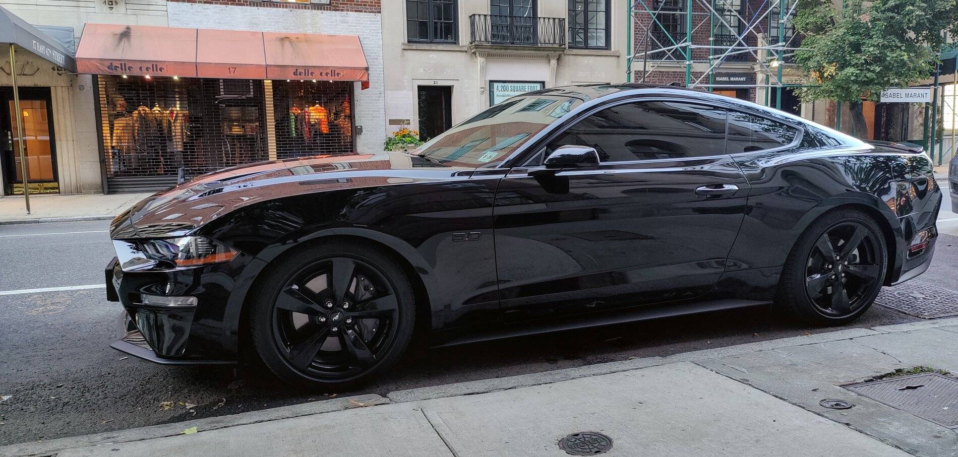

I ended up just getting Steeda Progressive lowering springs installed. Ride seems the same, handling a little better changing lanes and on turns but definitely not dramatic. Like the lowered look. Any suggestion of what to do next except for shocks and struts?

What are you looking to accomplish - more power or more handling? IRS support?

Handling and support, just want to know what would be my best bang for buck without changing my stock shocks and struts. Daily driver for spirited street and possibly on the track. That picture was taken in Manhattan so that has to be considered.
