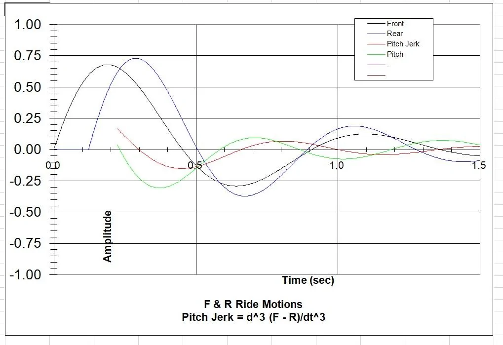

260 lb/in front (about 1.55 Hz undamped)
220 lb/in rear (about 1.62 Hz undamped)
FWIW, those are roughly where the GT350 wheel rates and undamped ride frequencies fall.
At about 25% critical damping, frequencies drop to about 1.5 Hz Front and 1.57 Hz rear.
Here's a plot for the soft OE springs (roughly 130/140) at 25% and 21% critical damping, respectively, at 50 mph (typical street speed). Undamped ride frequencies roughly 1.14 and 1.33 Hz. At the above dampings, 1.10 and 1.30 Hz.

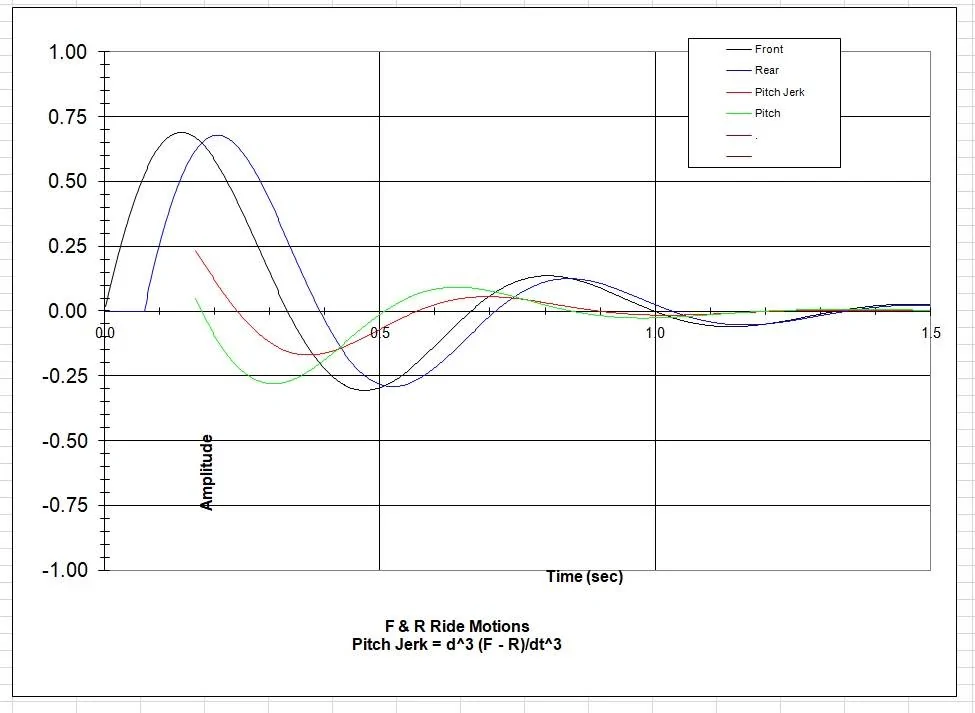

And a plot for the current setup at 85 mph (a more typical track speed).

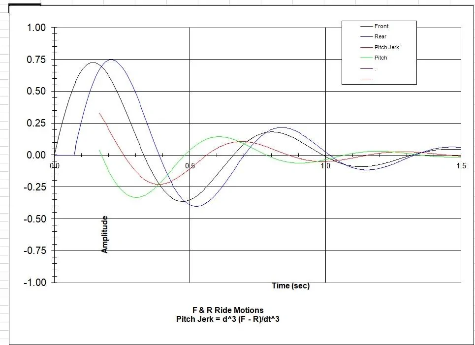

Just so you know, some years ago I was sent some Koni yellow shock force data for the front and rear S197 dampers, with force measurement data taken at every quarter turn of adjustment. Easy enough from there to get a good estimate of Cc for the known spring rates and car weight data, and from there, C/Cc.
I've made a couple of simplifying assumptions in arriving at those plots, but I feel that they're representative enough for the intended comparison purposes. I did go through that spreadsheet and made a couple of minor revisions that didn't change the plots enough to matter here.
