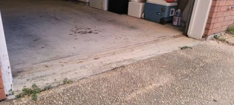

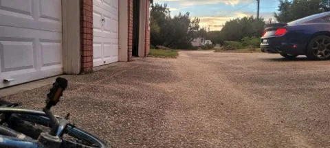

Here's a couple pics. The lip looks higher in the pic, it's around 0.5".

assume this is a townhouse row and pics don't tell the whole story but my .02..
-your real estate agent should be able to tell you if there's any recourse from the sellers but my gut would say you are on your own no matter what they checked. bought and sold a TON of houses in my life and that disclosure really only helps in houses with prior flood damage or unlicensed work done not to code.
-if there's a noticeable difference in concrete to asphalt height a good inspector should have seen it(half inch in my book should have been seen), noticed rot on the trim around the garage indicating further inspections or if the trim wood is newer compared to front door trim, another flag.
-before spending a bunch of monies on drains, I'd first figure out how the water is getting in. is it coming from street runoff further up, off the roof without gutters, etc. if you are getting standing water across the whole garage, that's a lot and should be easy to pinpoint and maybe there's a different/better solution. a puddle in the middle and maybe a simple edge would suffice: https://us.garadry.com/products/garage-door-seal-1-and-1-4inch?currency=USD&variant=31563402674253&utm_source=google&utm_medium=cpc&utm_campaign=Google Shopping&stkn=25b18ebdaa93&tw_source=google&tw_adid=&tw_campaign=17457591077&tw_kwdid=&gad_source=1&gad_campaignid=17457613640&gbraid=0AAAAADfmRz_lCeAFzei7toLMm3xFO-lMW&gclid=CjwKCAjwq9rFBhAIEiwAGVAZP11Pu_dHXzLP5022s_EweNUXjrRvcmxVciicTVqA9fzBvEb6wly8JxoCcakQAvD_BwE
