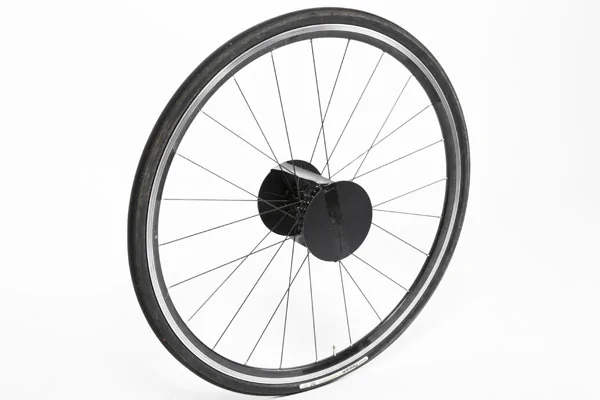

FWIW both boxes of Steeda struts I ordered came with a liiitle bit of damage. The flange that holds the spring had cut thru the box. Scraping on the floor had scraped off some of the paint.
Everyone can do a better job packaging these. Double walled boxes and caps on the strut ends would be nice.
For instance bike wheels come shipped like this:
