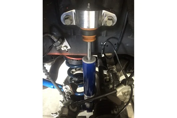

As the title states, one of my rear shock mounts has completely failed. I need a replacement ASAP. Ordering an OEM one is problematic.
Right now I'm leaning towards the BMR shock mounts. Will they directly bolt in, and work with the factory shocks?

I have the Steeda ones and they are perfect.
Simple dimple to replace, I recommend !! :D
Yes they work perfectly well with them.

Steeda, J&M, BMR and Vorshlag all have rear mount options, a few others may too

On the steedas is the bearing user replaceable fir shock rod diameter changes in future like 10mm to 12mm?
We have spacer kits if you change from 10mm to 12mm.
