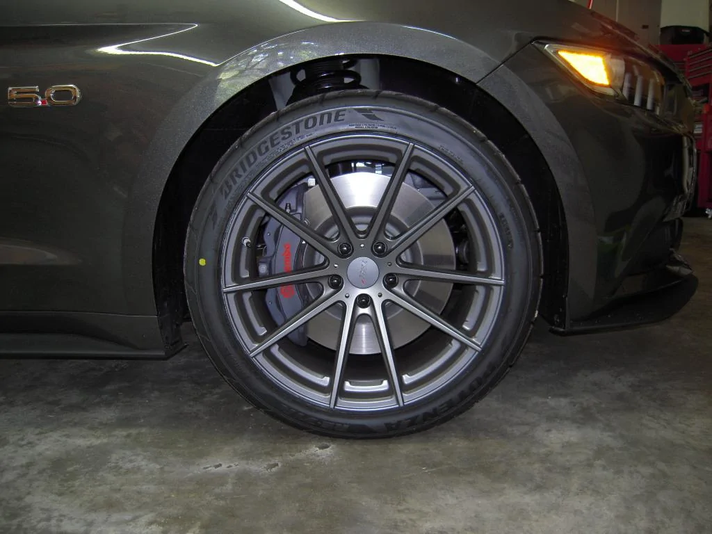

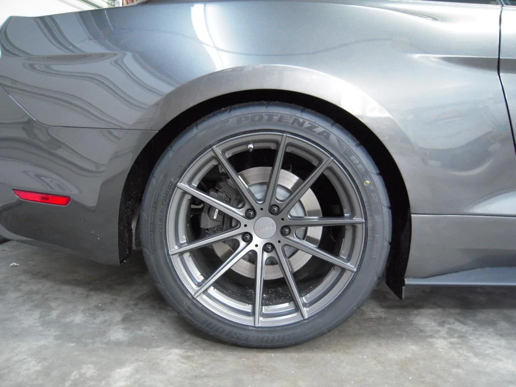

Here's a before and after... stance is perfect for me. Before it felt like the front end was higher than the back. Now it's got a very subtle rake.
Has it settled at all since the after shot? Looks like barely an inch at the front and less at the rear. What are your tire sizes?
I think it's the difference in camera angles (unintentional) that makes the after shot look less than it is. I'd say the 1" drop is about right, maybe a little more than that up front. Running square 285-35-19.

Mine dropped more in the front than in the rear. Definitely a noticeable rake.
Oh sure, these things can be hard to capture in the photos. Car looks great nonetheless.

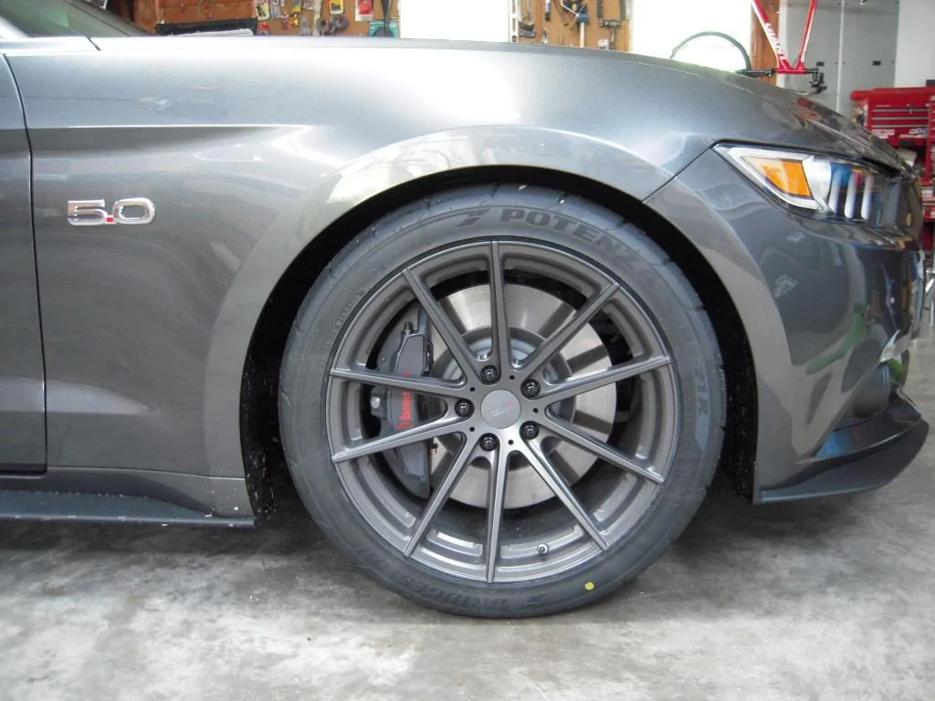

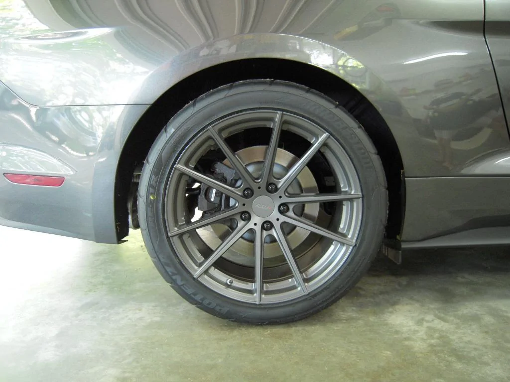

Here's a few more better before and after shots from a similar camera angle.
