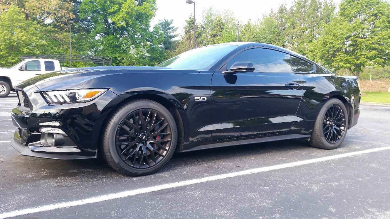

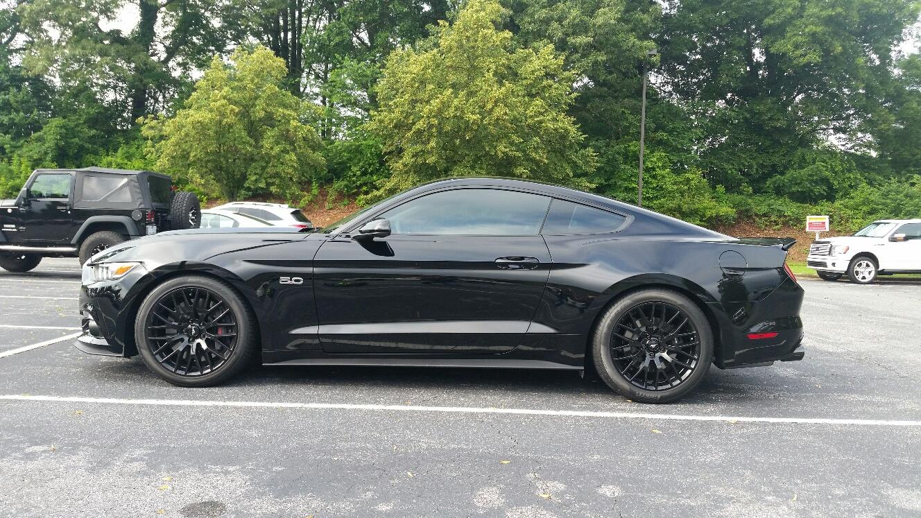

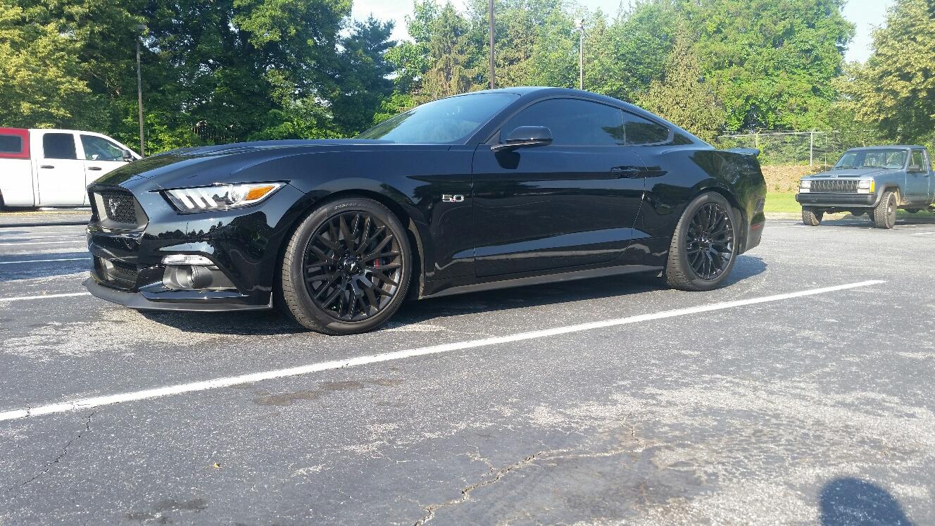

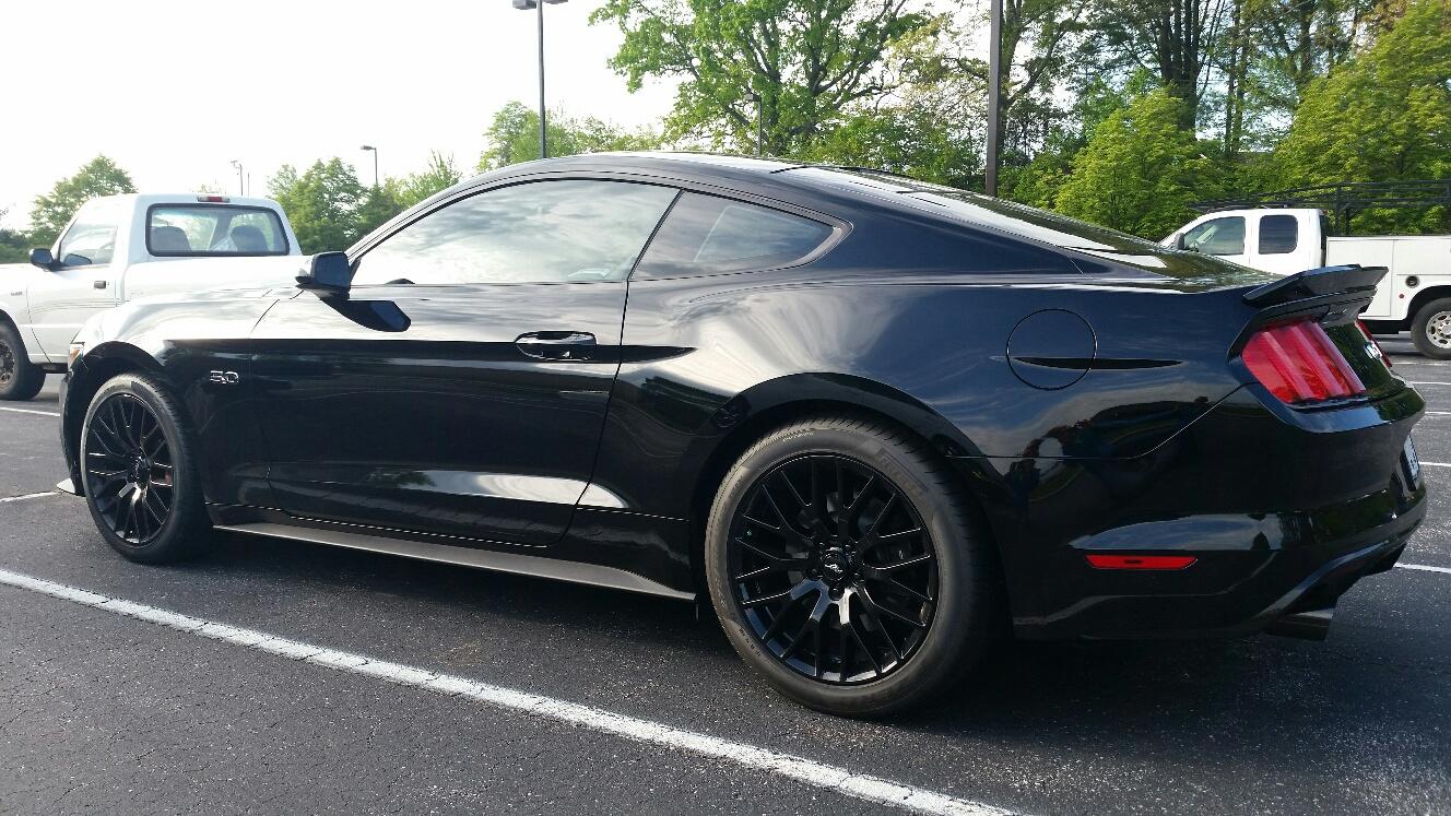

First 2 pictures are before and 2nd two pictures are after.
