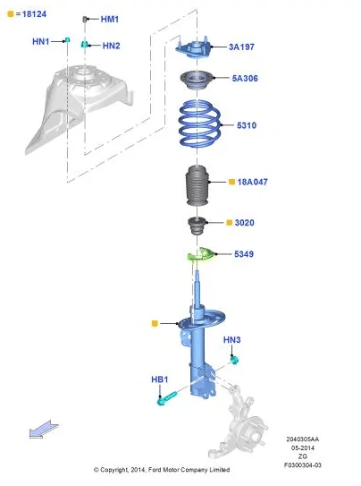

As this thread covers, you can get clunking noises from a number of spots in the front suspension.
Strut top nuts
Swaybar endlinks
Strut to spindle bolts
etc.
The frontend should not clunk, and if it is clunking, that's a sign something is not right. If can be a sign of a major issue or something minor. Best to have it checked out.

I wanted to provide an update as this post ultimately helped out.
TL-DR it for me it was the 21mm nut and 10mm post at the top of the strut tower. Tightening this completely resolved the clunking sound. You need either a special strut tower socket, offset wrench, or do what I did and use an angle grinder to cut a window in a 21mm socket and use a 10mm wrench..
One dealer thought it the shock and was going to charge me $500 to replace it. This would have fixed it by virtue of totally replacing the nut.... and the shock. Another dealer was convinced it was brake pads... which it also wasn't
Feel free to contact me if you need assistance. This post saved me a lot of money.
P.S. The reason the nut loosened up is unknown. I have a sneaking suspicion parts are either prone to stretching or the threadlocker partially failed.

I also have the clunking. My car is a non-PP and the only thing added to the front is the BMR K-brace. I am highly suspect of the oversized holes allowing a shift as stated earlier in this thread. I have a big pile of suspension bits coming and I will go over everything while I'm in there. I have the Steeda camber plates on the way, do they reuse part # 5A306 or replace that part?
