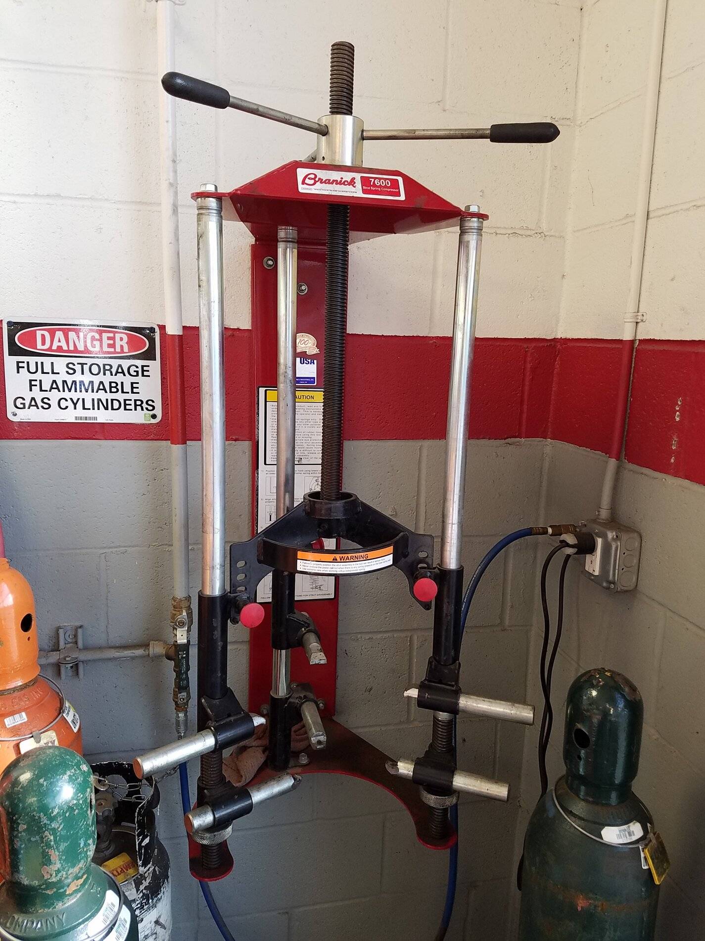

I saw the Mother of all Spring Compressors bolted to the wall of a tire shop today. If you could get use of that for cheap, I'd recommend it over borrowing the tool from the auto parts store.
