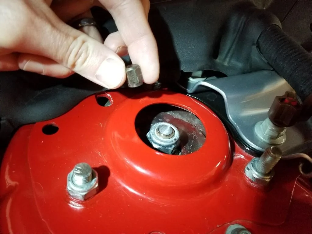

I decided to take off both sway bar end links again to see if the noise changed. It did not. At this point I got really frustrated and tried to shake the front end by violently pushing back and forth on the strut tower brace. I was able to barely hear the clunking noise come from the passenger side corner. I tried shaking it again and just happened to have my hand on the top strut nut and I was able to actually feel it clicking up and down.
So I attempted to tighten the camber plate to strut nut again. I think it tightened a little bit before I snapped off the 10mm part of the factory PP strut that's used to keep it from spinning.
The noise is now reduced, but not gone. The camber plate must still be loose.

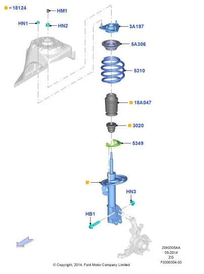

Here is the part number. It rests between the strut top plate and the spring.
5A306
Ford
Coil Spring Housing
RH/LH (Front)
$28.15

I have in the past, many times, but this weekend was different.
So I guess I should get new struts at this point if the noise gets worse again. Does anyone know if the Steeda Pro Actions (fixed) would pair well with BMR performance Springs? I'm also thinking of going back to PP spring retainers/strut mounts instead of the camber plates. Think it would be able to be aligned without them?
5A306
Ford
Coil Spring Housing
RH/LH (Front)
$28.15
Is it possible to tell if this part is broken without disassembling the whole assembly?
I would say no. That plate is under spring pressure.
