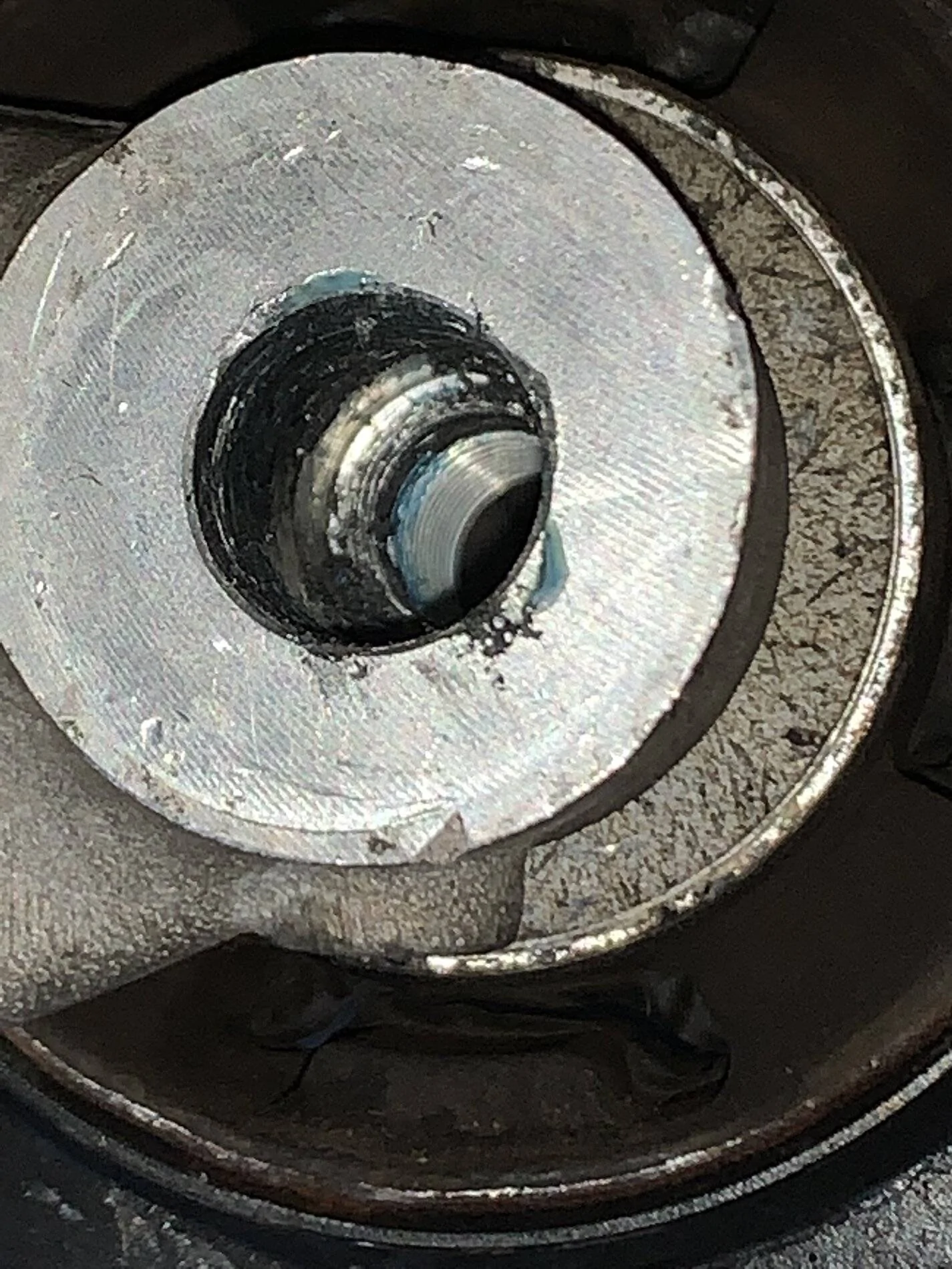

I’m in the process of adding a new differential. I have the front bolts in fine but the rear are giving me tons of resistance. To the point where it stops and I’m afraid it will snap the bolt. What are my options? I think both threads of the bushing are stripped. Can I get a tap to make fresh threads?

It’s a little hard to see where the threads start so they may be boogered up. You can try and tap them and see what happens. Are the front diff bolts tightened? If so, loosen them up. The rear threads may not be aligned and that could be part of your problem

I think the bushing housing was stripped from the factory. I’m going to try tapping them first. If that works great, if not, I’ll drill out the threads and use the bolt through method. This gear swap struggle is real.

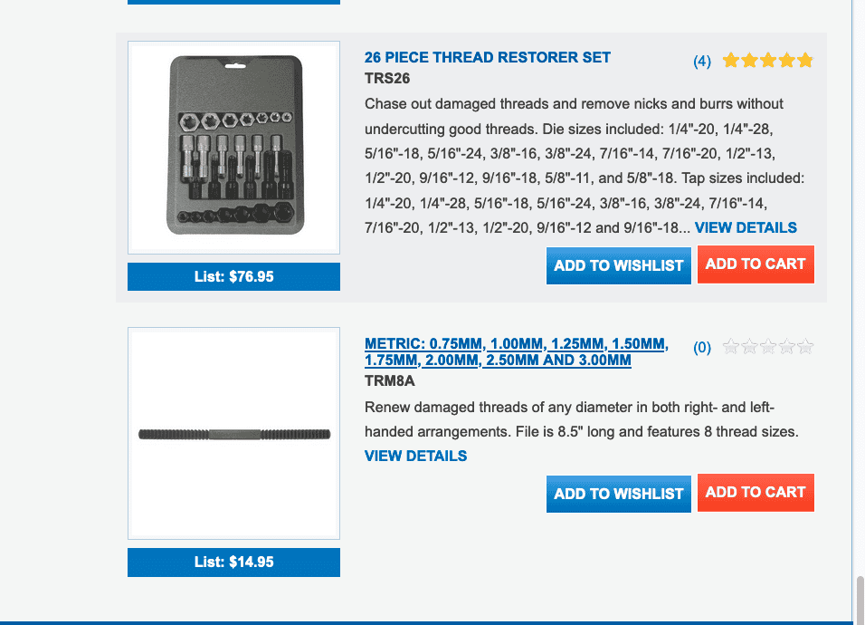

Tap magic the best .....
There is a tool called a thread chaser, does not cut like a tap.
It repairs the thread, pictured is a set, the bottom, shows you can also buy single sizes.

The only problem is I need m14x2.0 that’s an odd size and I had a hard enough time finding it in a tap. Still though, I’ll look for this.
