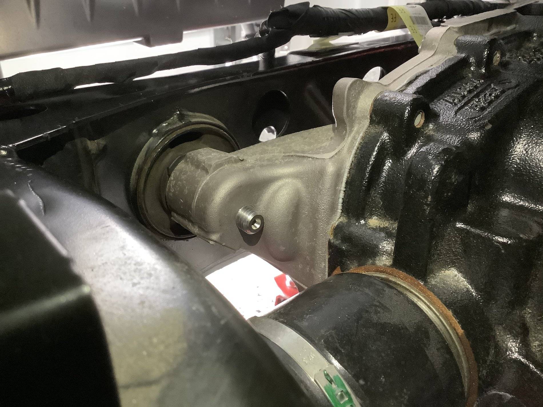

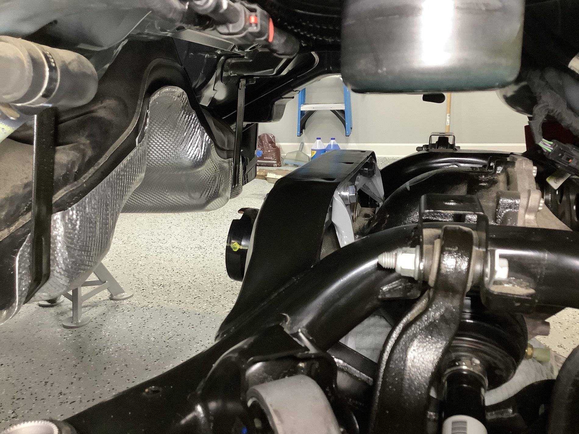

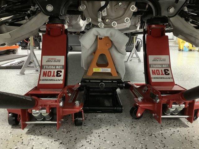

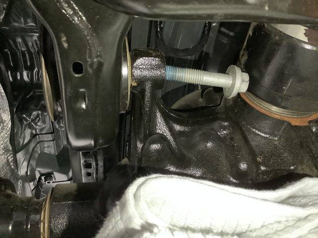

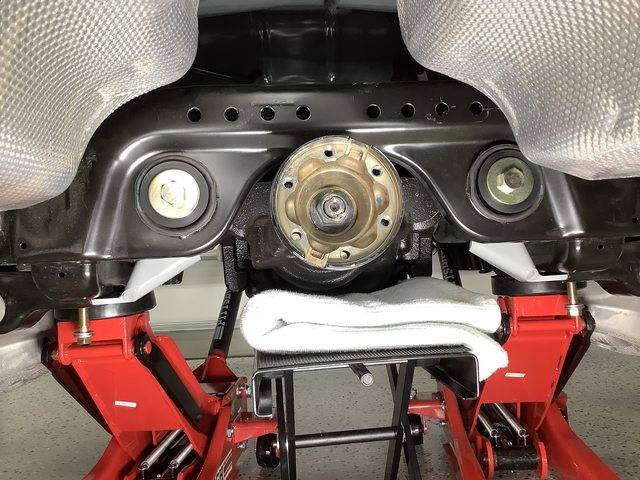

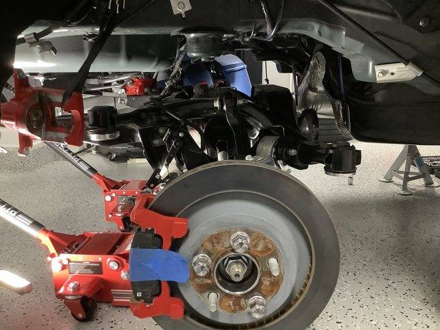

I think I can help here, as I dropped the entire subframe in my 2019 Bullitt to install Steeda through bolt differential bushing kit and differential Support bracket. I used two floor jacks and a scissor jack to carefully support the differential and subframe While lowering and raising to reinstall it. Here are some pics that I took when doing these mods. Hopefully they will serve as
a good visual reference for you. When you drop the subframe, you will be able to easily access the bolts to torque them down with a torque wrench.

Thanks! I don’t think you’ll be able to lower one side at a time, as you’ll need to drop it about 12” or so, in order to work comfortably. If you have a buddy that has a floor jack, I’d ask to borrow it. The scissor jack also made it easy to manage the pumpkin. I laid on my back and alternated twisting the handle on both floor jacks, as well as the scissor jack a little at a time and kept repeating the process until the subframe was low enough to work comfortably on it. Note: Don’t forget to unclip the differential vent line from the subframe and unplug the sensor on the differential cover before lowering the subframe.

I didn’t remove my pumpkin, I just supported it with my motorcycle scissor jack and lowered the entire su frame using all three jacks one at a time until I had it low enough to work comfortably. If you don’t use the three jacks in unison, the pumpkin is going to want to pivot up or down and make it hard to control the lowering and lifting of the subframe. Also, my jacks (got them at Harbor Freight for $109 each). have a max height of 19.75” and the tree jacks that are holding the car can go just as high.
Wait a minute, here’s a thought regarding your question about using the MC scissor jack on one side. Can you modify a car scissor jack (weld a small 1/4” thick flat plate to the top of it and use that to support the pumpkin while lowering the subframe. That might work for you, but you will still have to go very slow and really control the lowering and lifting (don’t go too far on one side at once.
