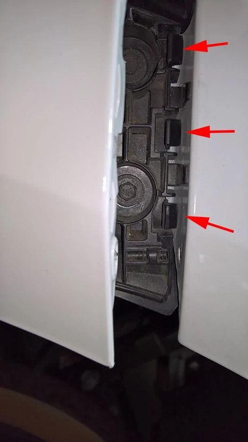

Below is a pic of the driver side after pulled from fender. Notice the very solid and unyielding tab/hooks that slots in the bumper cover snap over when the bumper cover is installed. Those tabs are far stronger than the bumper cover material so don't understand how you are supposed to get the cover off those tabs without tearing the slots in the bumper cover those tabs are grabbing.
I found the service manual page for removing the bumper and someone has a great sense of humor telling the tech they have to examine that black plastic part with the tabs to make sure the tabs weren't damage by the bumper cover and explaining how to replace the black part if it was damaged.
I'm going to throw something out. Obviously if that black part with the tabs was unbolted, problem solved. But you can't get to those two screw heads in the picture until the bumper cover is already off. BUT what those screw into appear to be between two sheet metal ears. I wonder if I could bend those away from the threads or alternately cut the screws before they contact those arms so the black part comes with the bumper cover?
When and if I get this bumper cover off, I am definitely going to take the edges off those tabs on the black part so the slots in the bumper cover have a fighting chance to ride up over them in the future.

Its off and in one piece. I did pry those arms away from the screws that hold the part that the bumper cover slides between it and the fender, before pulling. For some reason, that part did not come out with the bumper cover but I think it let it move enough for the slots to ride over the tabs in that part. Was still a lot harder to pull off than the driver side. I'm going to smooth the edges of the bumper cover slots and round off the edges of the tabs on that other part before reassembling.
