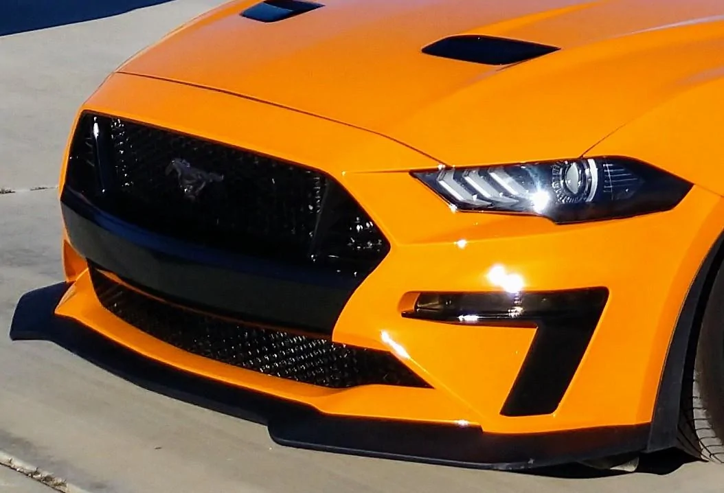

2019 mustang GT ..2014 Camaro ..72 Chevelle ..67 LeMans..97 4runner..2001 tundra
I hear you. I didn’t realize the Bullitt one is gloss. Do you have the part number for those? Save me the headache ha!
You can buy the bullet style setup on eBay top and bottom I just used the bottom one to match my top grill

Rash
Sep 8, 2016
126
1,056
328
Cary, NC
2018 Mustang GT Magnetic/Showstopper Red, 401A, Active Exhaust
What is that black insert in the front triangle? Any more pics?
