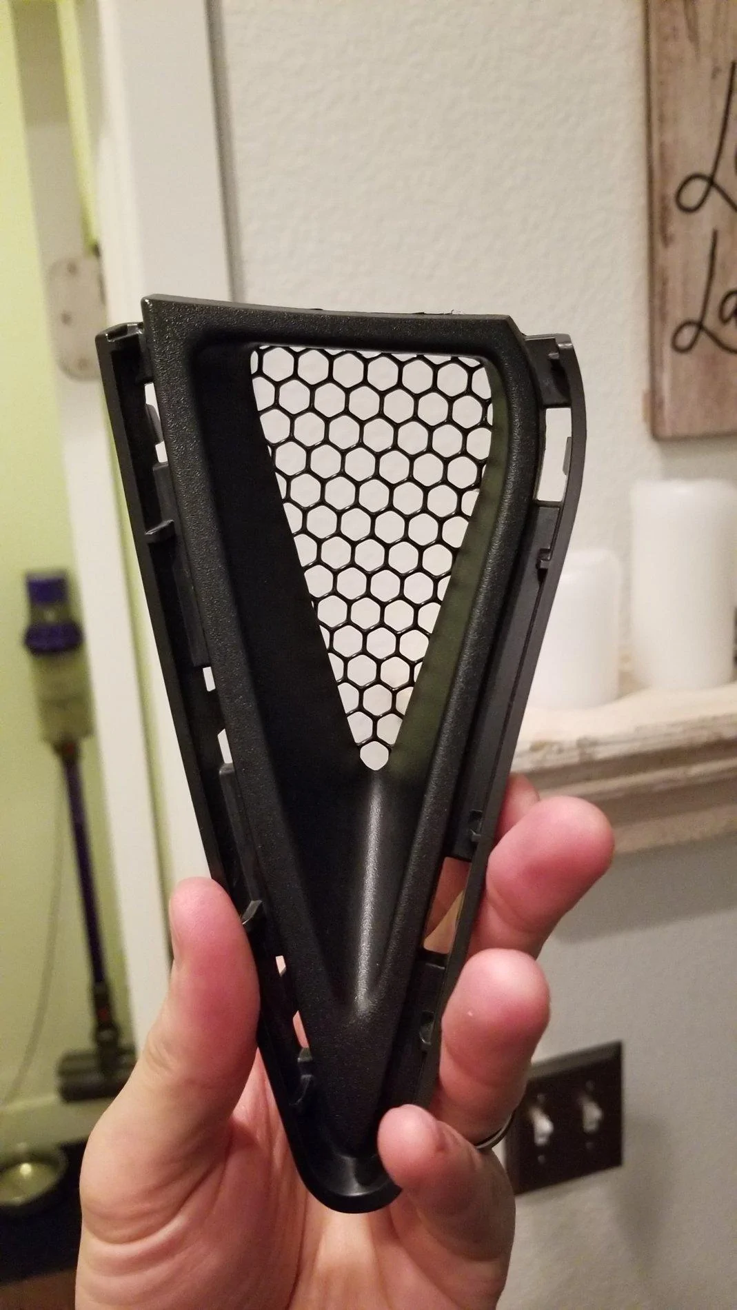

It can be done ...just a pain in the ass
Not on this particular one. There isn't even close to enough clearance to slide them over the clip.
I should have it all back together Sunday, I'll post a pic of the finished product then

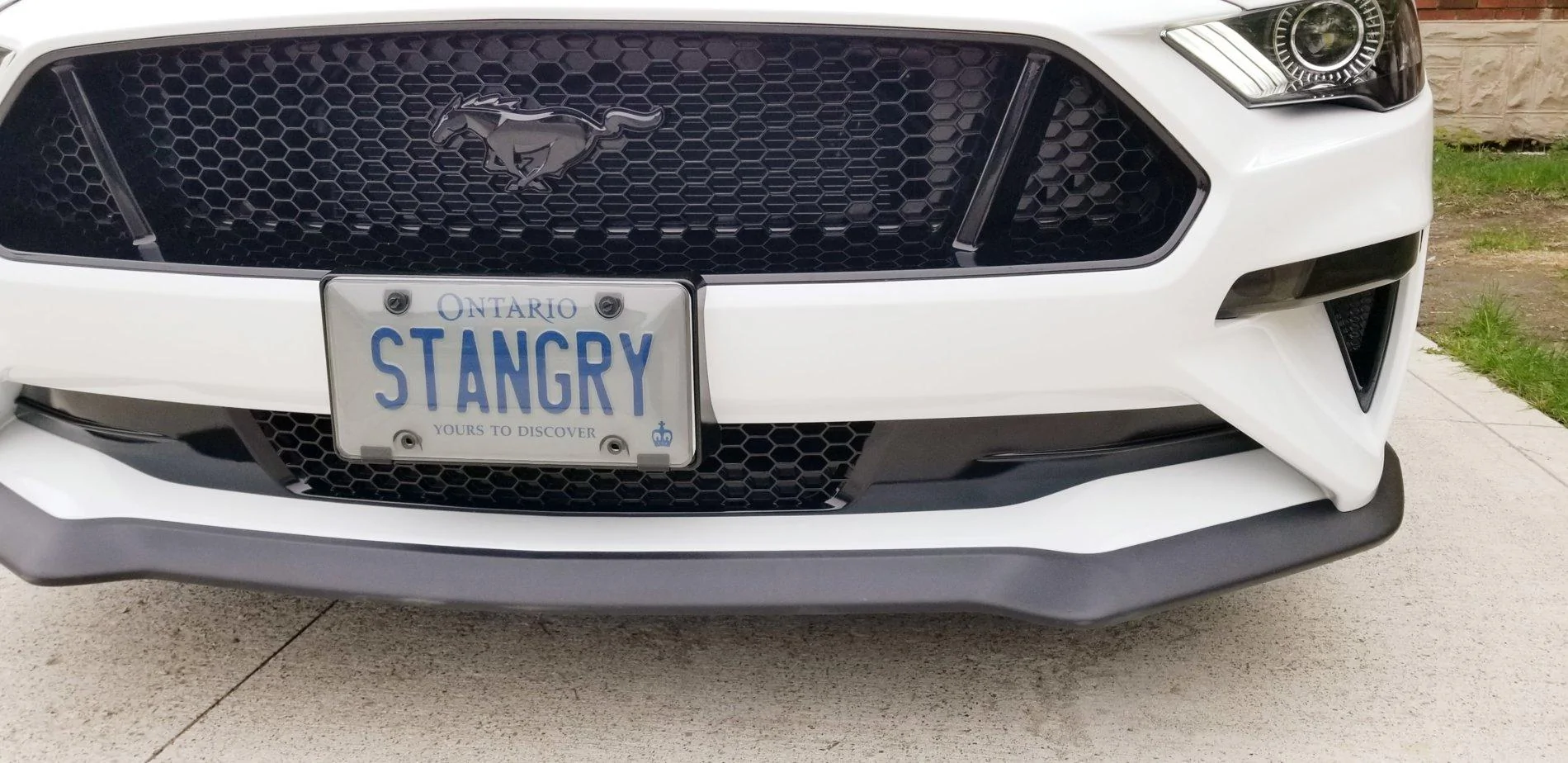

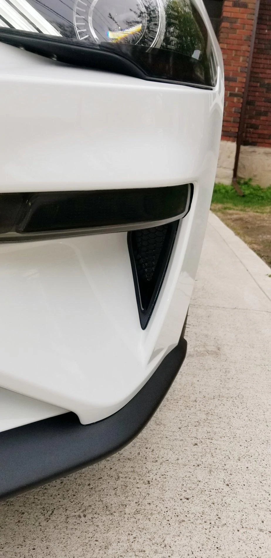

Finished up the painting today and reinstalled. There's a bit of contamination in the lower grill that I'll have to wet sand out. It's all back together though.

Very nice!

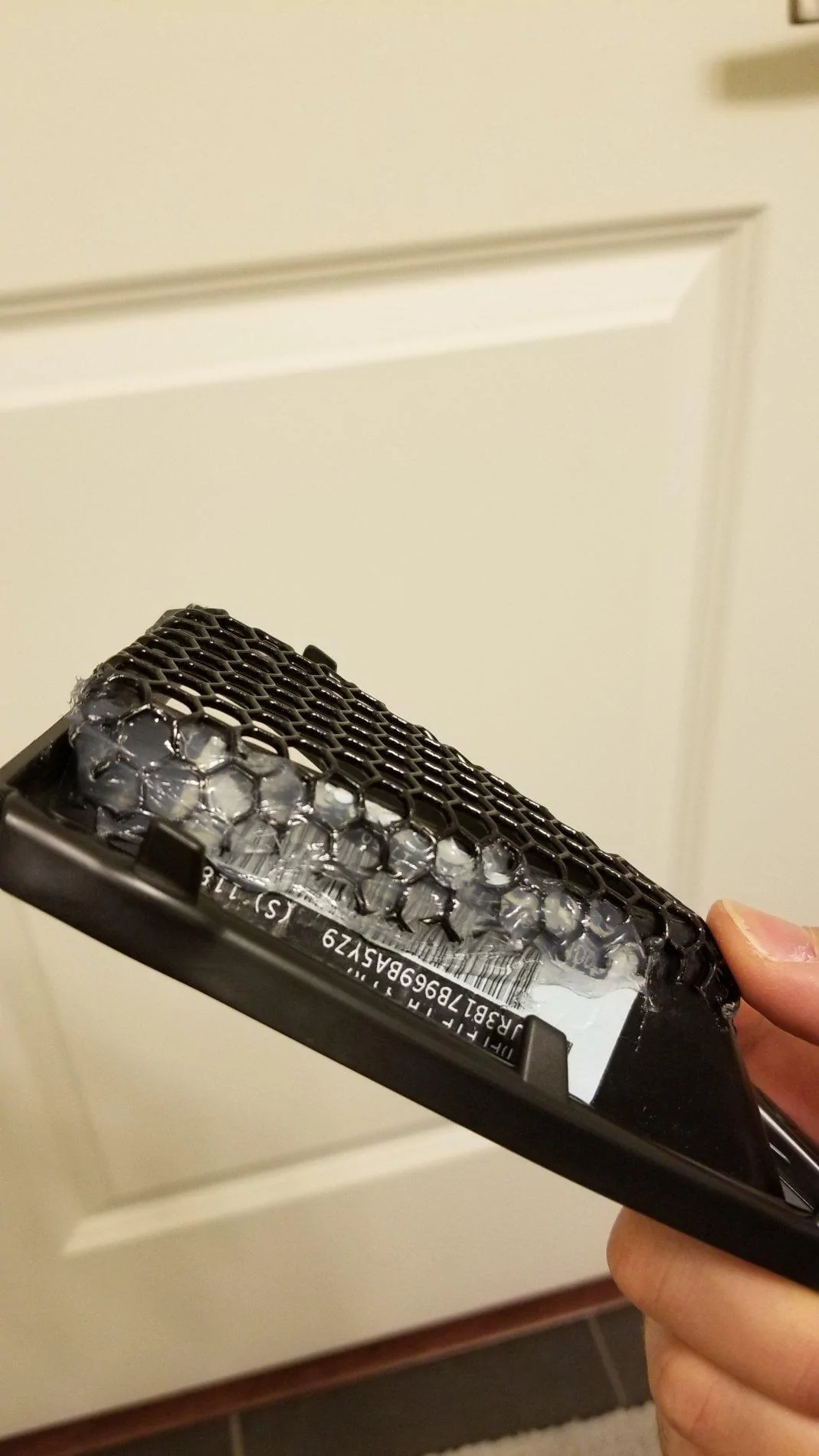

After removing mine, I decided to dremel the back off and put wire mesh on to match the cervinis upper and lower grill I'm installing.
I used heavy duty silicone on the back to keep it in place.
Looks great! I still don't know how you guys are getting your pockets out. Mine were not coming out unless I cut the bracket.

I used a heat gun on the plastic and a flat head screwdriver to bend the tabs back and wiggled it out. Just keep at it!

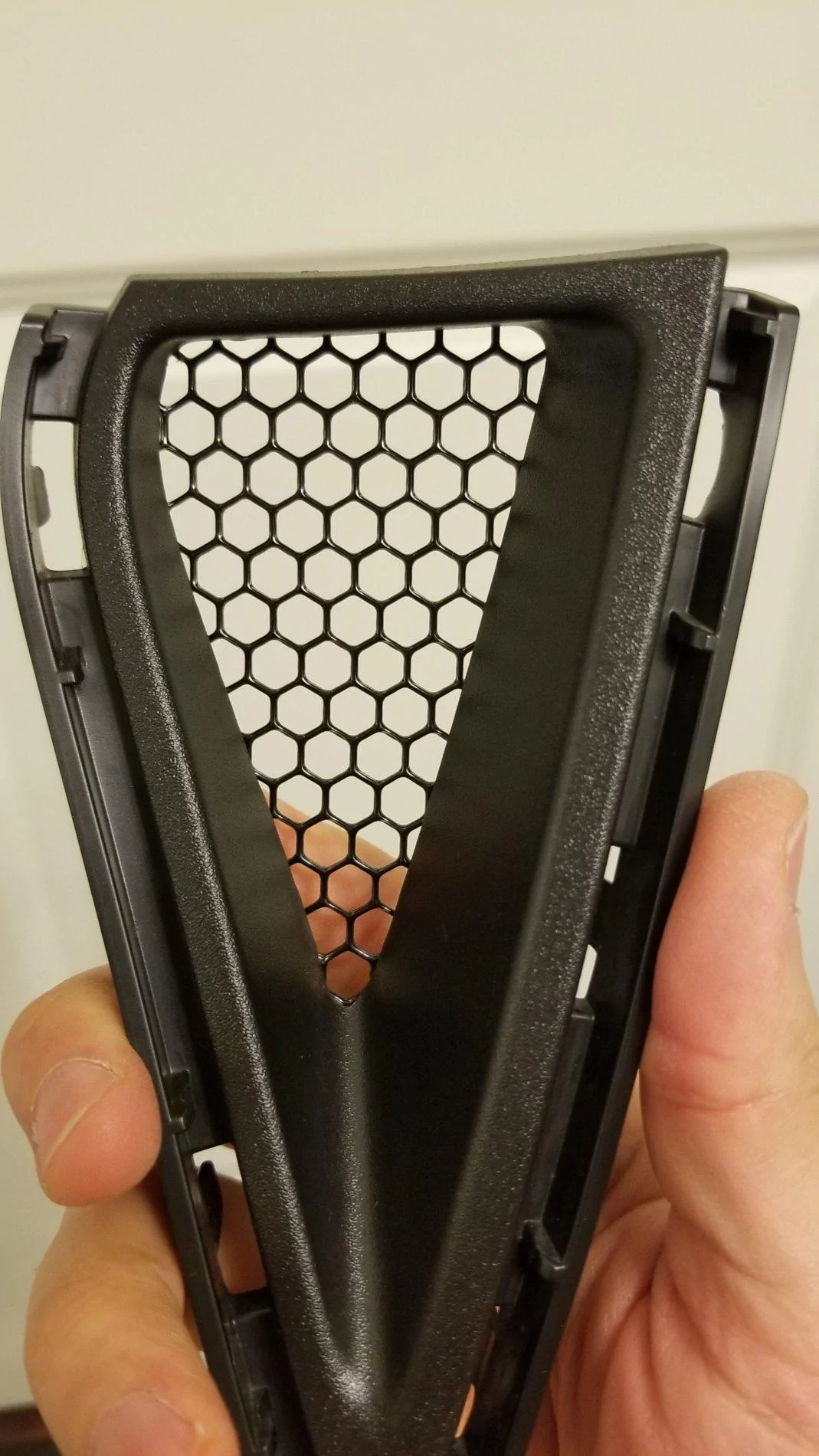

My vents are blocked, I ordered new vents to paint gloss, they're also blocked. My bumper does however have venting track.
