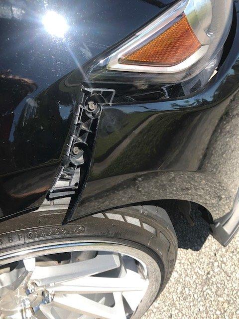

So I was going down my buddies driveway and the bumper clipped the driveway and the passenger side clips came off /:
If someone could give me a solution instead of getting a whole new bumper please!

Are you talking about the tabs? Where the upper rear corner of the fascia meets the fender?
Marked in red:

You’ll want to grab a pair of QuikLatches to put in. Maybe paint match em so it doesn’t stick out too much.

Yep, OK, so like [MENTION=28654]Nagare[/MENTION] said, there's a product that's pretty easily installed, and fixes this in addition to being a better solution:
http://www.quik-latch.com/
However, when I recently removed my fascia, I broke the passenger side tab. You can pry it out of the connector and try to glue it. I was successful, but I had my entire fascia off, so the attachment point was totally accessible. I used automotive Goop, got it positioned perfectly, it snapped right back in.
Next time I remove it, I may go ahead and just upgrade to the QuikLatch.

Have you tried popping them back in? you didn't say if they were broken.

Quicklatch..paint so they wont be too noticeable?
.why not do the same with some pop rivets

or go full ricer, drill hole, zip tie ;)!
