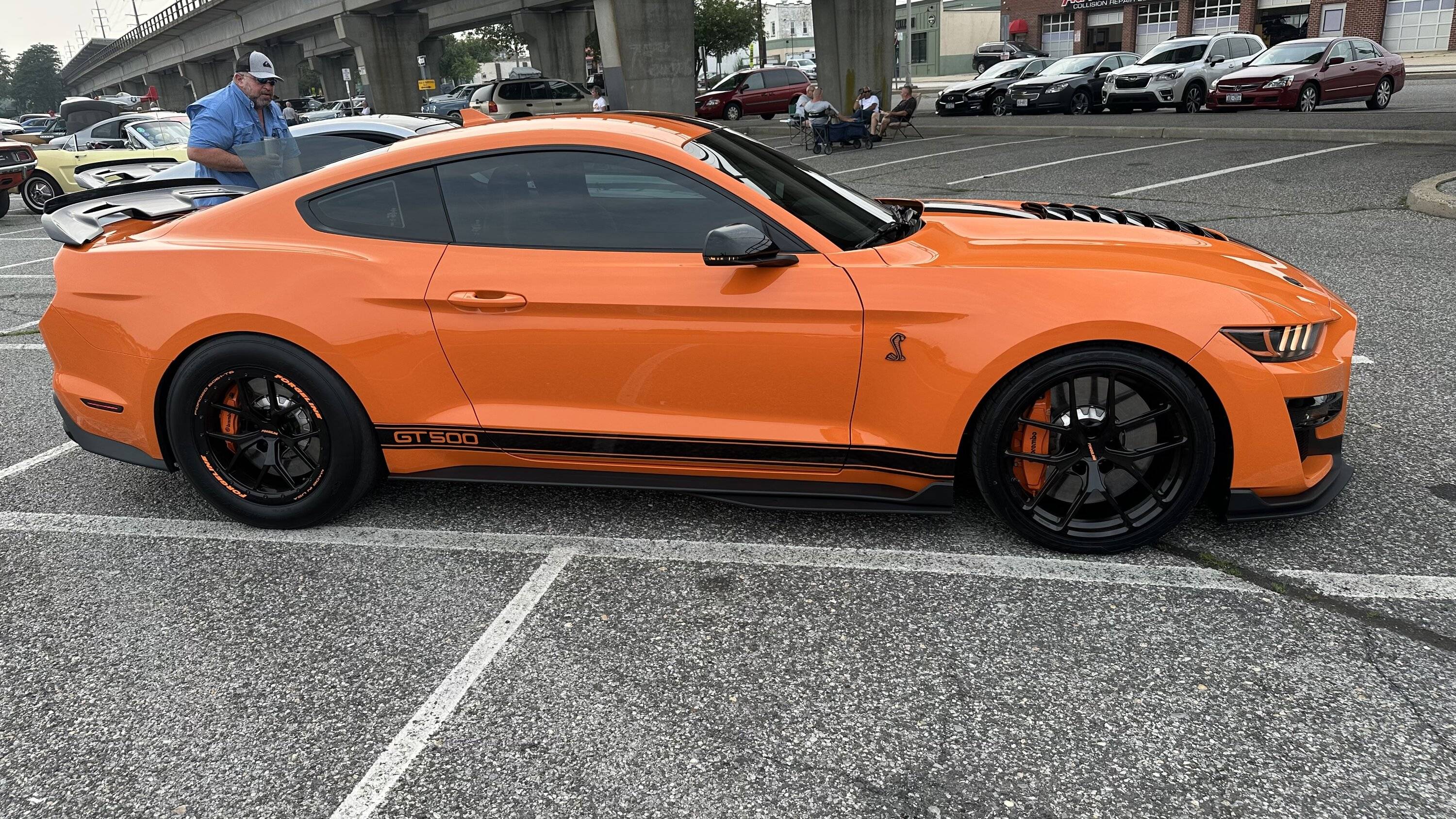

I have a 2021 GT 500 with a Whipple and Lund tune, I recently swapped out my OEM tires for a drag setutp with forgeline rims, nittos up front and MT ET Street R in rear. 275/35/20 and 305/45/18 in the rear. I also have an MSS adjustable suspension and needed to install a stiffer black spring in the rear to get more lift to accommodate the taller MT tire in the rear and then had everything aligned.
I was expecting to get the famous lightning bolt after I did this and sure enough, I did. When driving my MPH were lower by 3MPH, You don’t get the lightning bolt until you drive it for 10 mins or so and it clears when you shut off car. Anticipating this would be an issue, I already purchased an OBDLink EX unit and forscan software with a full license.
