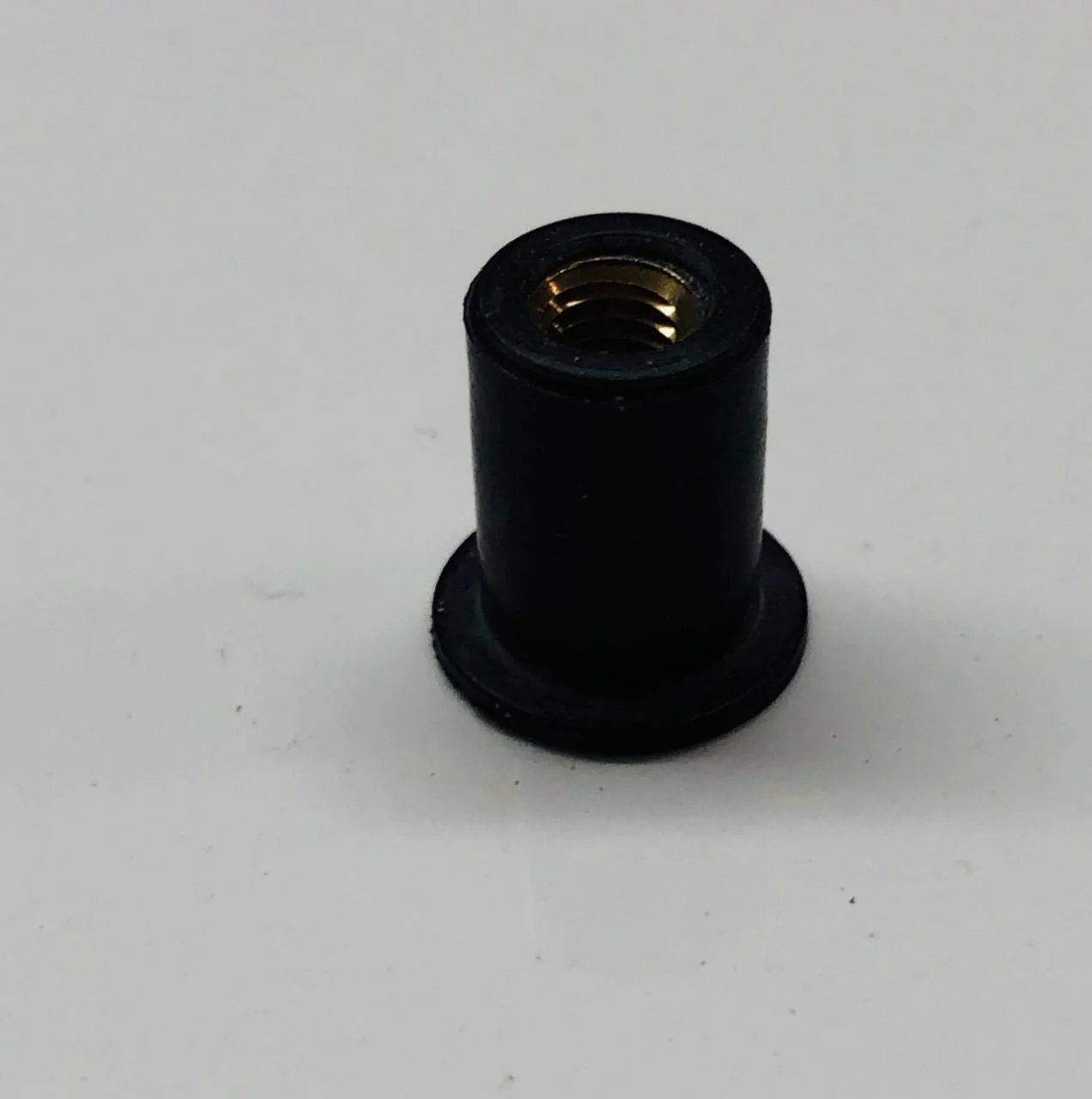

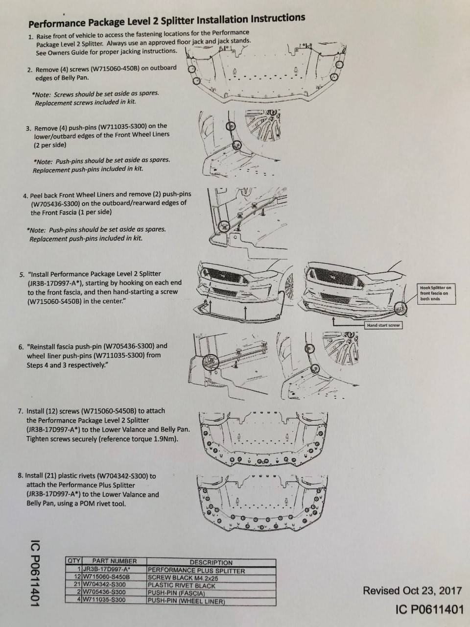

Yes, they are different, but not by much. I have a PP1, bought the PP2 from Ford for less than $400 which I thought was a good deal. There are only 6 holes where you have to drill into the PP1 splitter...I used wellnuts/rivet nuts and if the plastic rivets come out, I'll use wellnuts/rivet nuts after drilling the plastic rivets out. Just to be clear, the PP1 bellypan is basically the same at the PP2. When you install the PP2 splitter as the instructions indicate, all of the rear holes in the PP2 splitter line up with PP1 bellypan. We'll see how it holds up to a couple of 3 digit high speed runs.
It's not rocket science and although the PP1 and PP2 upper splitter have different part numbers, when I was drilling through the PP1 upper splitter, I ran into what looked like rivnuts in some areas. Mine is 19, so maybe 18's are different, but it worked perfect for this old guy.

When I was drilling my PP1 upper spoiler using the PP2 as a template, I ran into what I thought were rivnuts, and also steel plates...I assume these are stiffeners inside the PP1 upper spoiler, I drilled them out and use the screws supplied with the PP2 spoiler from Ford. If they don't hold I'll use the wellnuts and drill them out to 3/8".

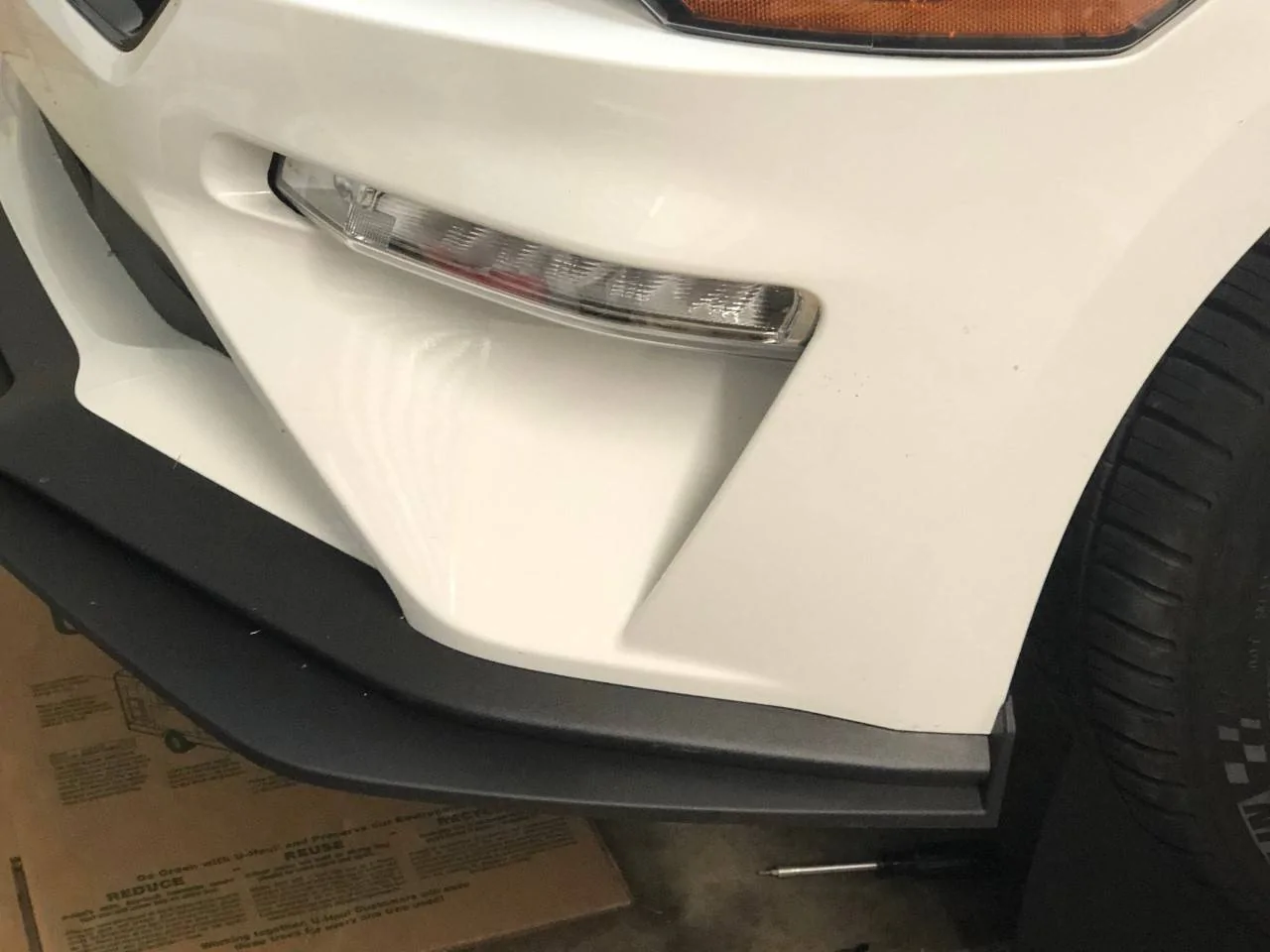

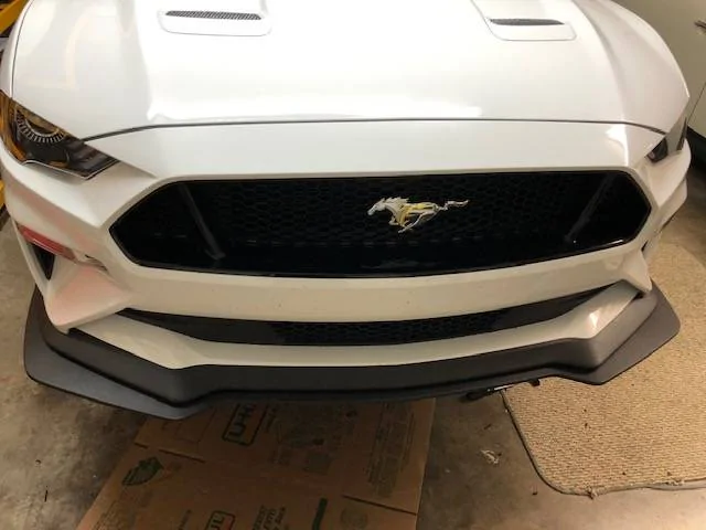

I installed mine today. I cut off the three locating pins and used the supplied hardware. No real issues and it seems attached better than I thought it would be. I really love the looks of it on the car.

I’m about to try this same thing on my PP1... can you tell me what fasteners you had to use/buy? I have a used PP2 splitter that doesn’t include any fasteners.
Cody5.0
Apr 30, 2019
71
Nebraska
Cody
2019 GT Performance Pack
The instruction sheet posted above has a fastener list at the bottom.
