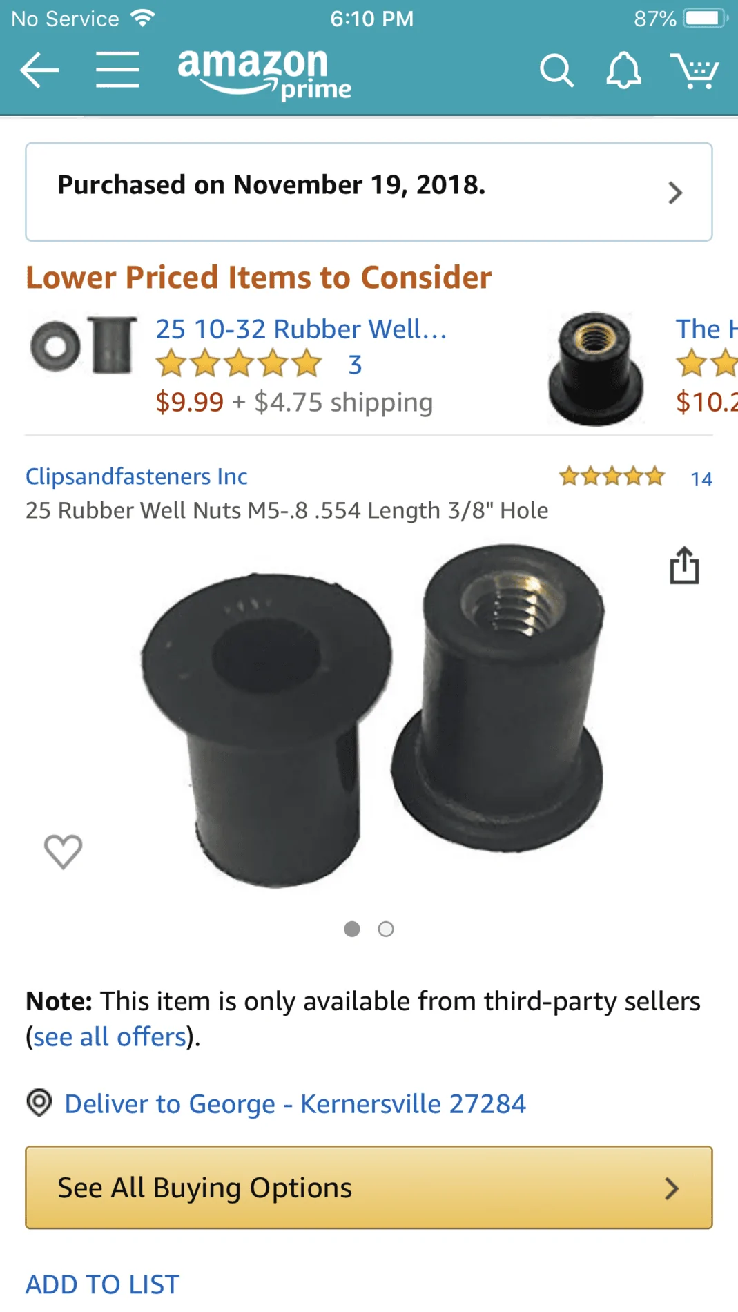

I wouldn’t suggest using the plastic rivets, after several races on the track with my PP2 I noticed several rivers where missing. I drilled out the rest of the rivets and removed the lower splitter and the lower panel that the splitter is attached to.
I found that the lower panel has extra structure inside where the rivets are located, some of the structure is so close to one another that it’s not allowing the plastic rivet to spread out to properly secure the splitter (rivets falling out or hanging loose).
To solve the issue I used M5 rubber well nuts, this would require a slightly larger hole but worked out well in securing the lower splitter properly. M5 screws (black) along with washers (black) for hardware. Doing it this way I can remove the splitter along with the lower panel anytime should I need to work behind the grille/radiator area. I have had no issues with the splitter since making this change.

This is great advice, I'm going to take it myself for the reinstall of my pp2 splitter. I've been dragging my feet because I didn't want to rivet until I was sure that I was done in there. I'm guessing you just got the well nuts at home Depot?

Amazon, I don’t remember the total number of well nuts used. I included a snap shot with more info. Do not use a drill bit, instead a uni bit which was a a safer way to increase the size of the holes in the plastic panel.
