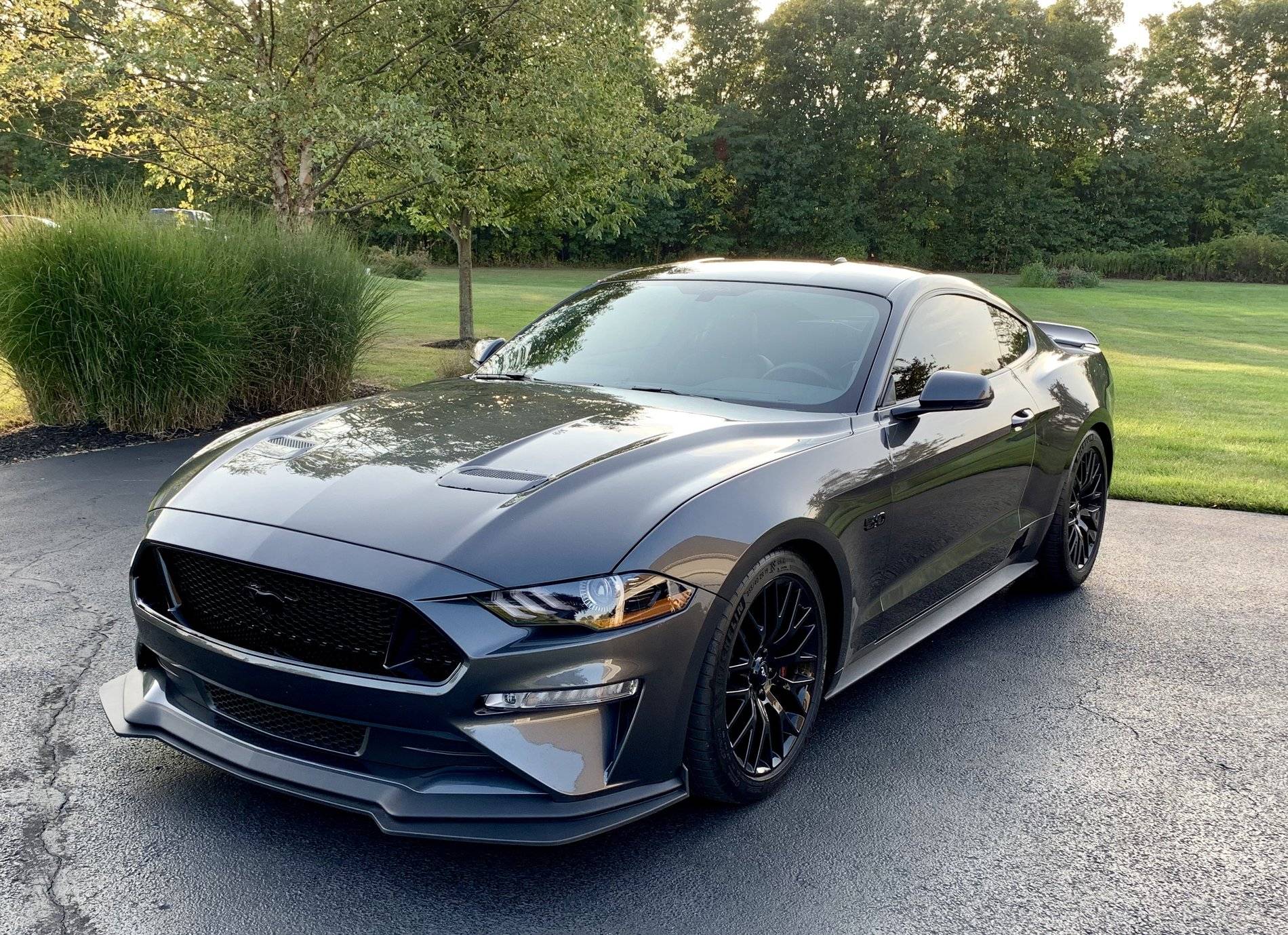

I have a PP2 splitter on my PP1 car so it does fit with the PP1 belly pan and splitter. Easiest thing would probably be to order the belly pan, upper splitter, and lower splitter using a PP2 VIN.

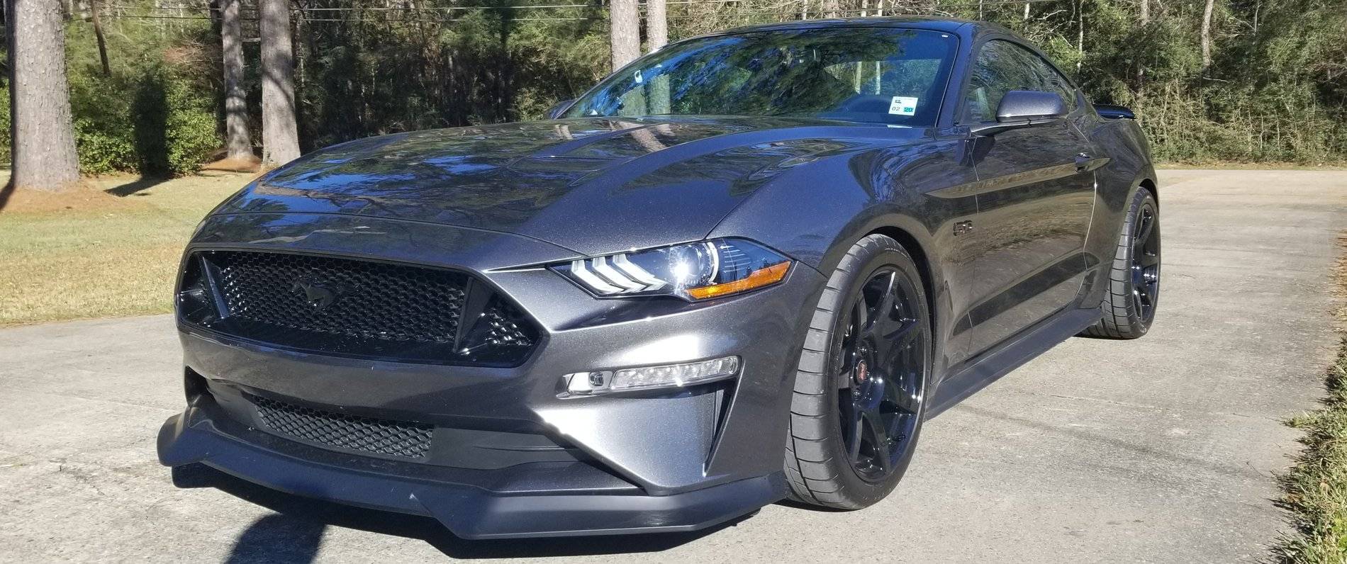

Can confirm that you need the PP1 belly pan/rock shield when you change to the RTR, Roush or PP2 Splitter. There will be small gaps on either side if you don't. You can also see the gaps if you watch the install video on the AM website for the RTR splitter.
