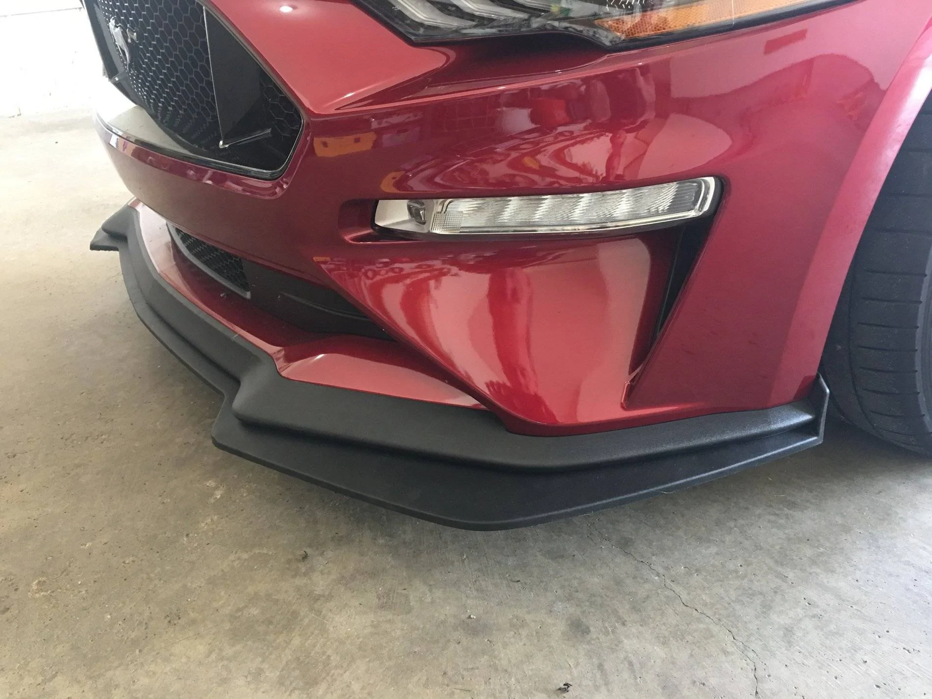

I installed mine today. I cut off the three locating pins and used the supplied hardware. No real issues and it seems attached better than I thought it would be. I really love the looks of it on the car.
hey mind sending us a picture of the car with the PP2 splitter ?

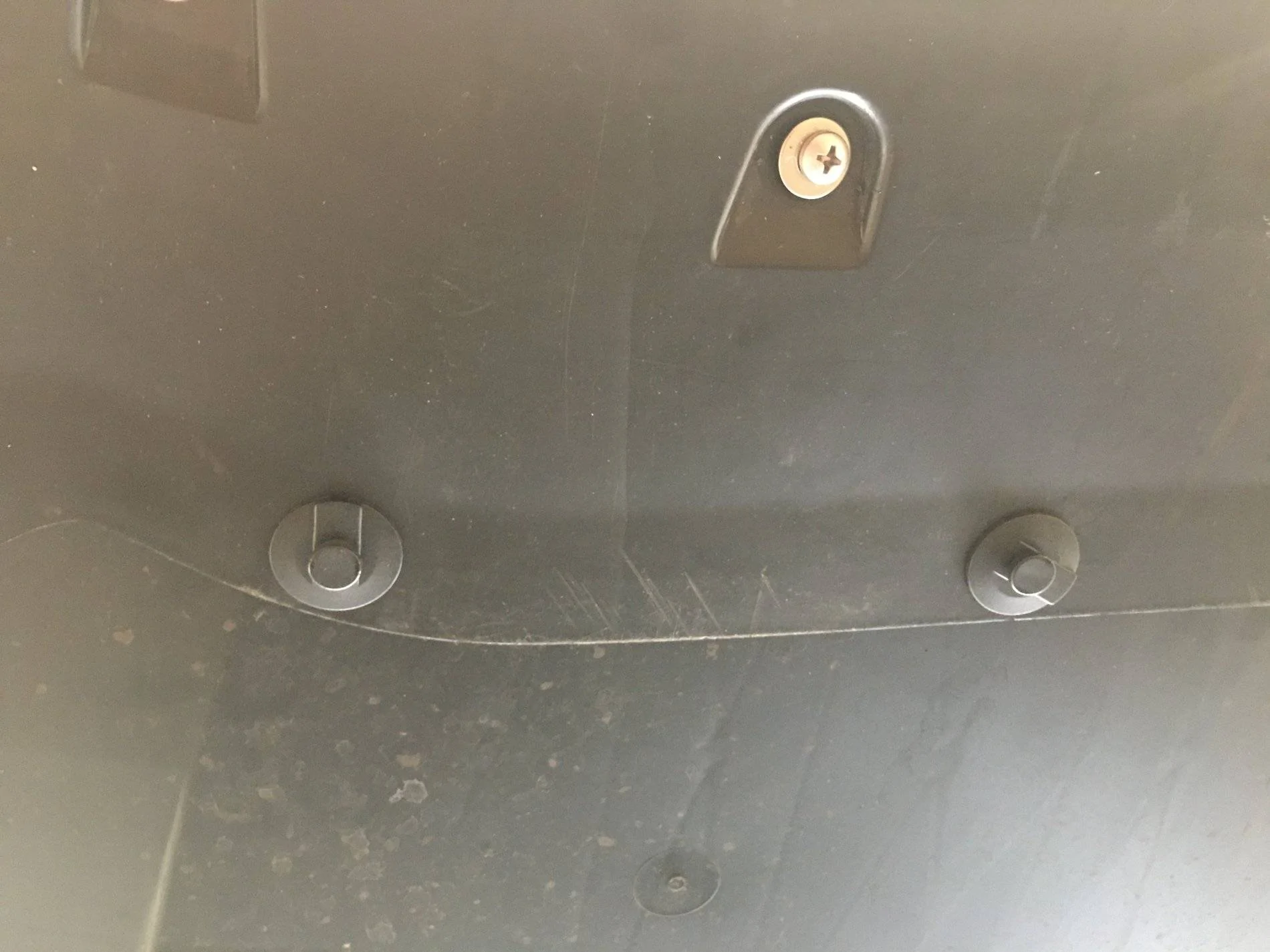

Update... so tonight I tried to install the splitter using the 21 rivet / 12 screw instructions from Post 7.
The 4 existing PP1 screws (2 on each end near the wheels) worked in the PP2 takeoff splitter.
The inner ring of rivet holes in the PP2 splitter lined up with existing holes in the PP1 belly pan. I had a bunch of 1/4" diameter push pins with large flanged heads and used them instead of rivets, they worked great. Very tight fit.
However, the outer ring of holes is where a combination of the remaining 8 screws and the rest of the rivets go, according to the Post 7 instructions, but I have NO holes in the PP1 splitter that line up with them. There are two hole diameters in this ring and the smaller diameter is about .260". It's about .350" deep from the PP2 surface through the holes to the PP1 splitter surface. So I'm ordering stainless steel thread forming screws (97975A131) with washers (90107A013) from McMaster-Carr for about $18 plus tax and shipping to try in these holes.

Got the screws and washers and finished the install...it went OK but not great. When I drilled into the PP1 splitter to install the 15 new screws, probably 1/3 of them drilled easily through into the splitter, and the screws went in fine and tightened up. The rest hit something REALLY hard inside the splitter. I tried to drill through whatever the hard thing was but it didn't work very well, then when I tried to install the screws they wouldn't screw in all the way. But it seems to be on there pretty good, here's a pic of the screws and push pins I used.
UPDATE: Didn't like the way those #12 screws were not going in all the way so I bought McMaster-Carr 97975A133 thread forming #14 screws, 410 stainless steel. These are a little bigger diameter but 3/4" long instead of 1" long. Using the same washers and a 5/32" drill bit these went in all the way - much better.
Also - I'm wondering if the hard things I was hitting with the drill are rocks. If I was going to do it over, I'd check up in the PP1 splitter and clean it all out first.

Are you sure you weren’t hitting the j-nuts on the belly pan? The PP1 pan has j-nuts for the PP2 splitter. The upper splitter just doesn't have holes yet.

Not sure what I was hitting but it's installed now with the self-tapping screws. Wish I had known there were nuts in the PP1 splitter that just needed holes in the plastic to reach, I had bought the Ford screws but then realized there was nothing to screw them into.
