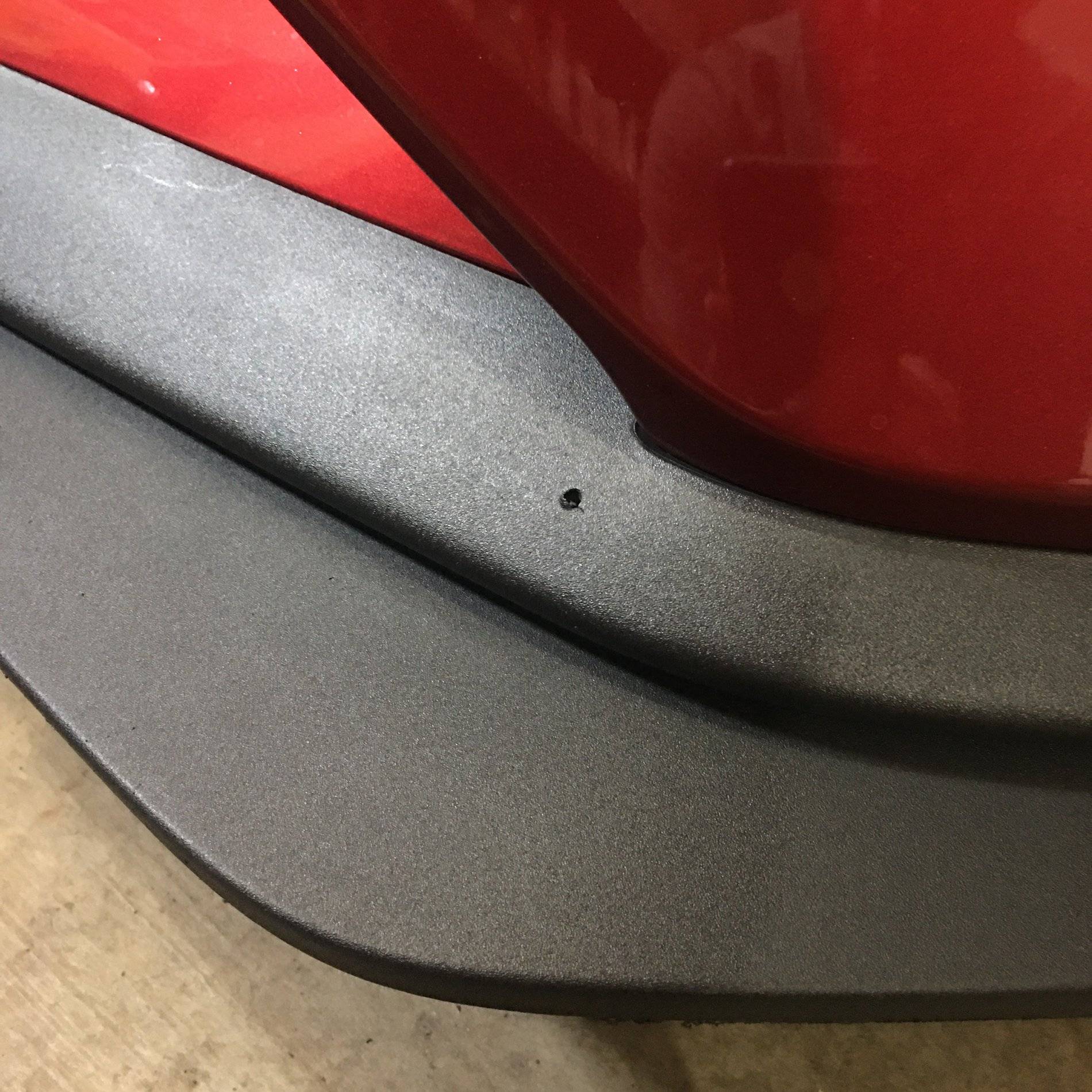

Oh and for God's sake pay attention when you drill the holes up into your PP1 splitter so you don't do something idiotic like this!!! :curse::angry:
I did the same exact thing to mine when drilling the first hole LOL. Super annoyed with myself.
Did you end up replacing the whole PP1 splitter? I was going to run to Ace to pickup some black plastic welder or black silicon adhesive, but wasn’t sure how it would turn out. Was curious if you fixed it or just ended up leaving it.
I smeared a dab of gray electrician's clay putty into it. Was very happy with the free 5 second repair!
