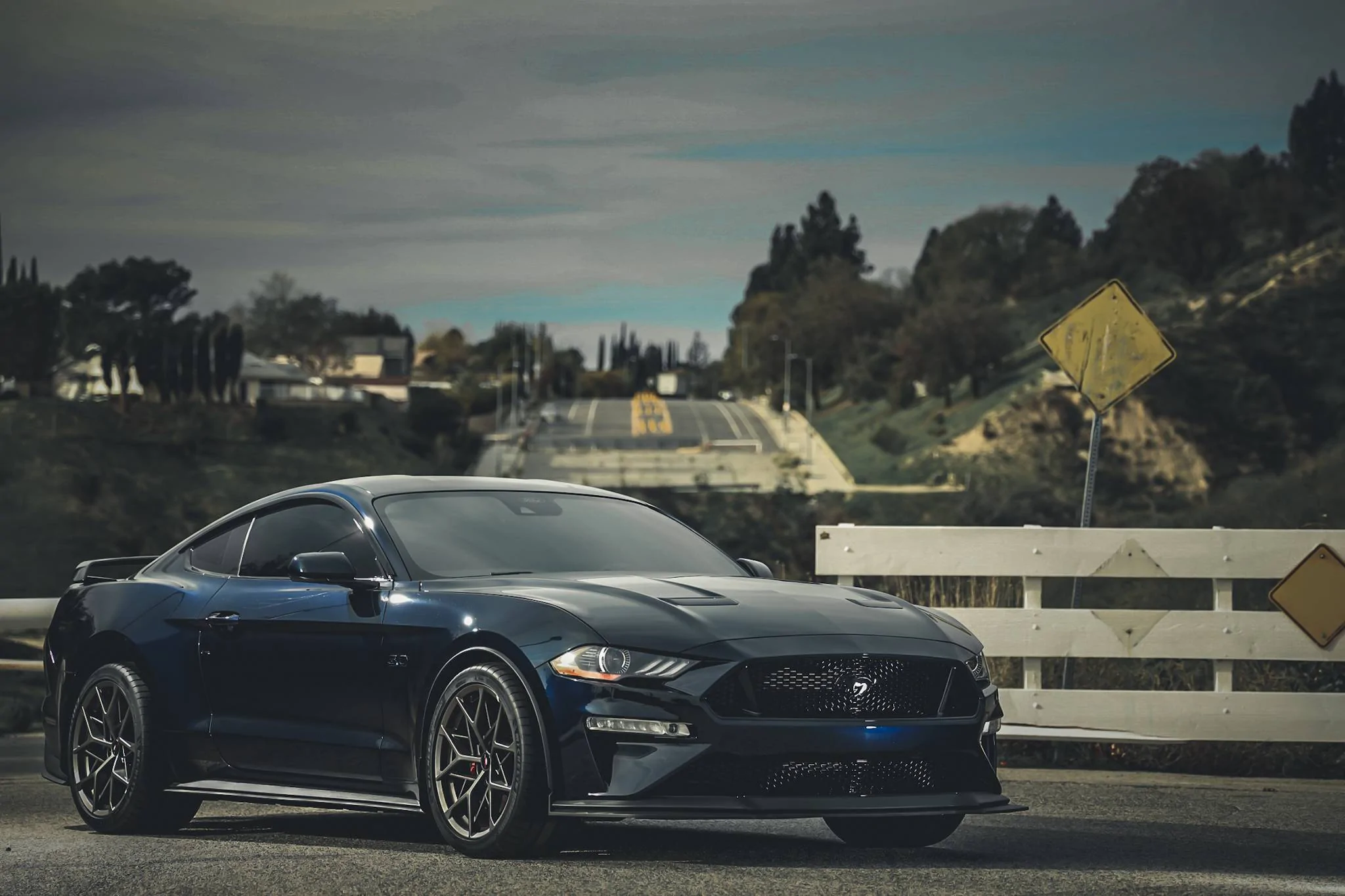

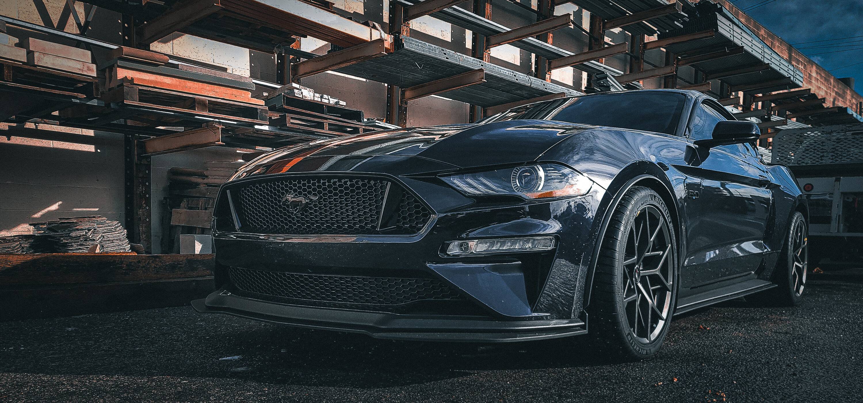

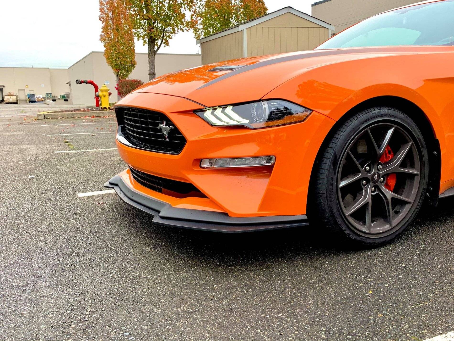

Oem pp2 chin spoiler and splitter installed on 21 pp1. Worth every penny!
Sweet! Are those the Mach 1 fender extensions, too? Everything looks perfectly integrated!

Awesome! I will be adding the PP2 chin splitter and the GT500 rear diffuser kit to my PP1 in the spring. The look is really growing on me. Nothing beats the quality of OEM parts.

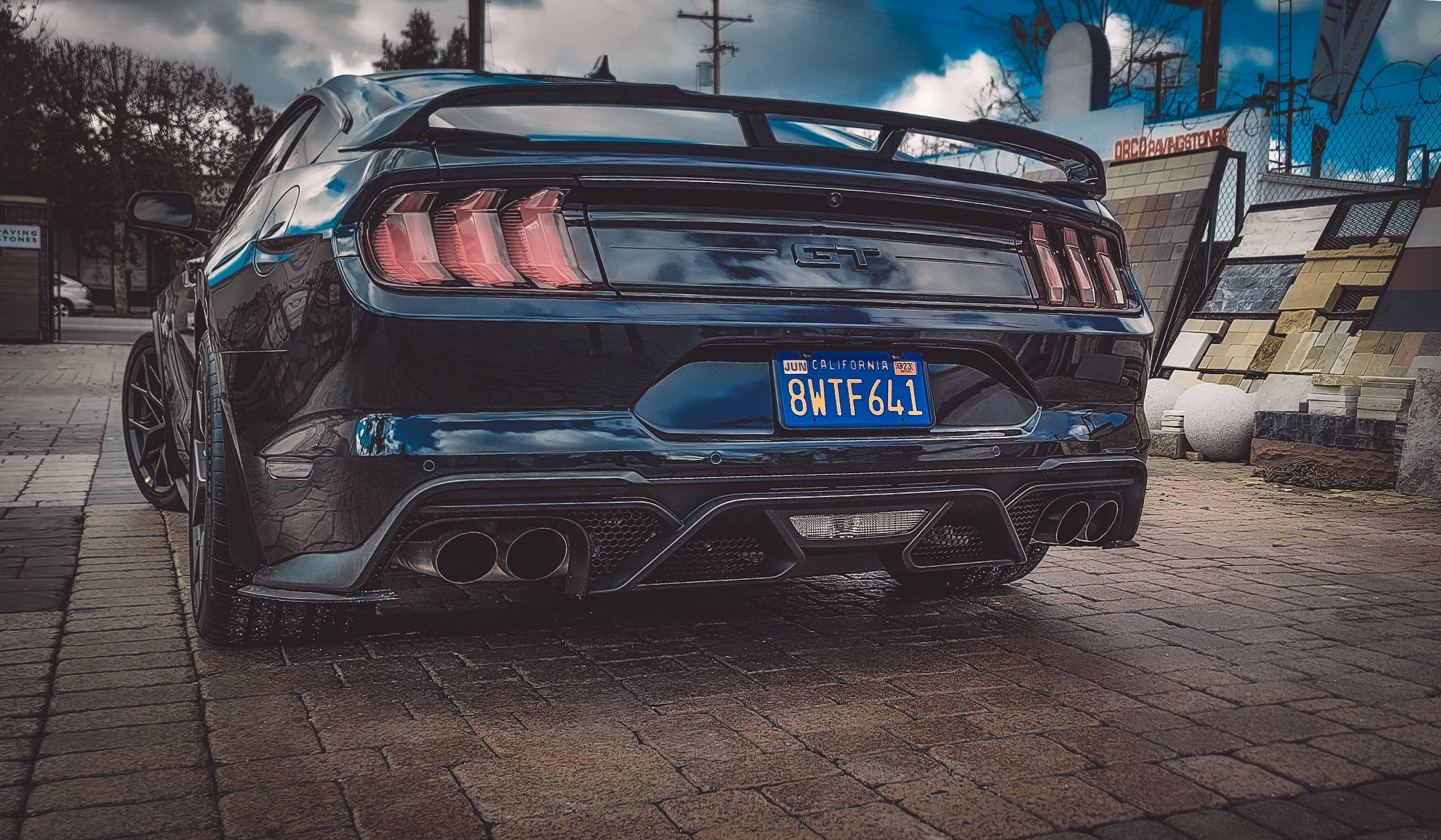

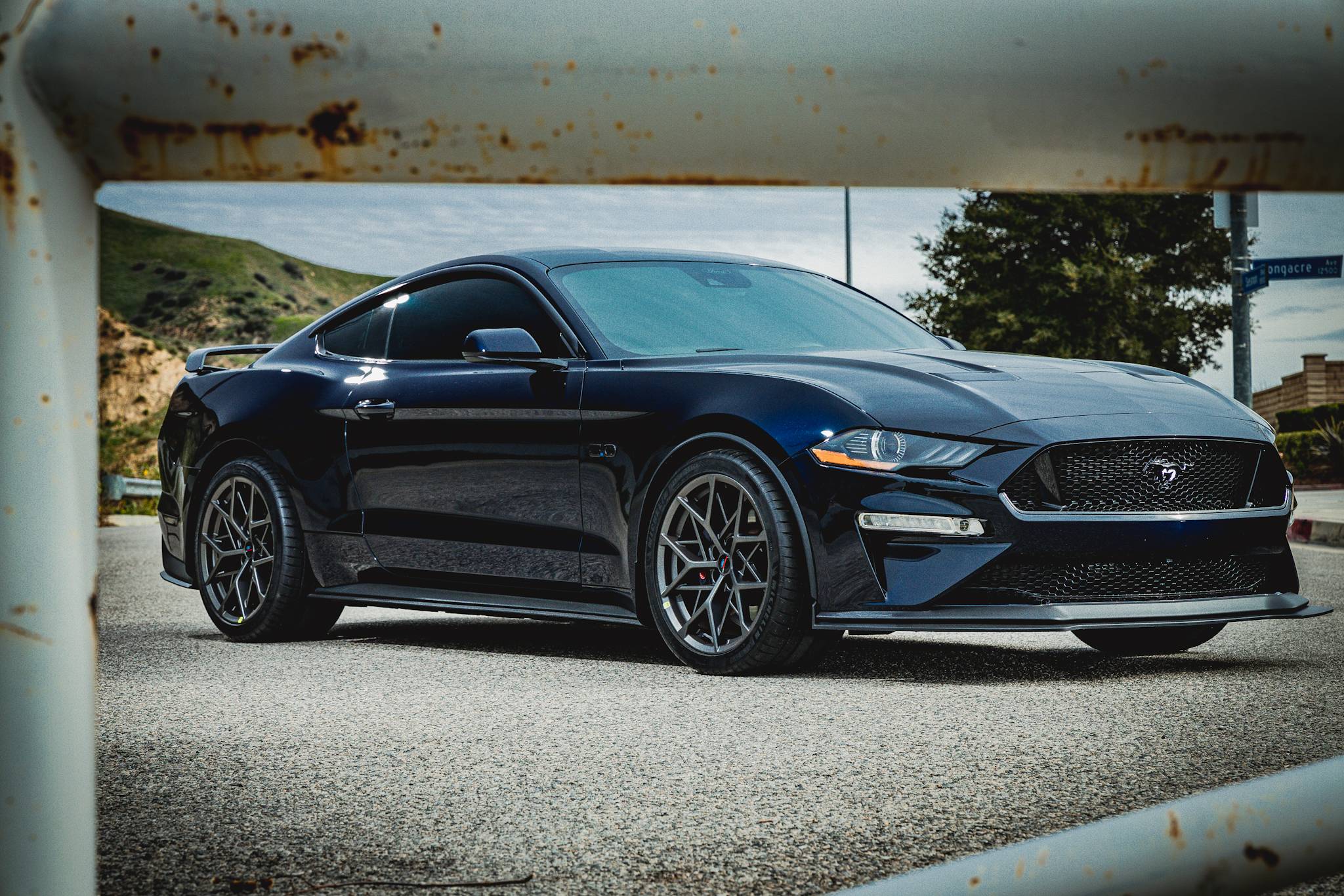

Oh yeah! Mach 1 hp wheel trim freshly installed! Along with gt500 rear valance close out package!

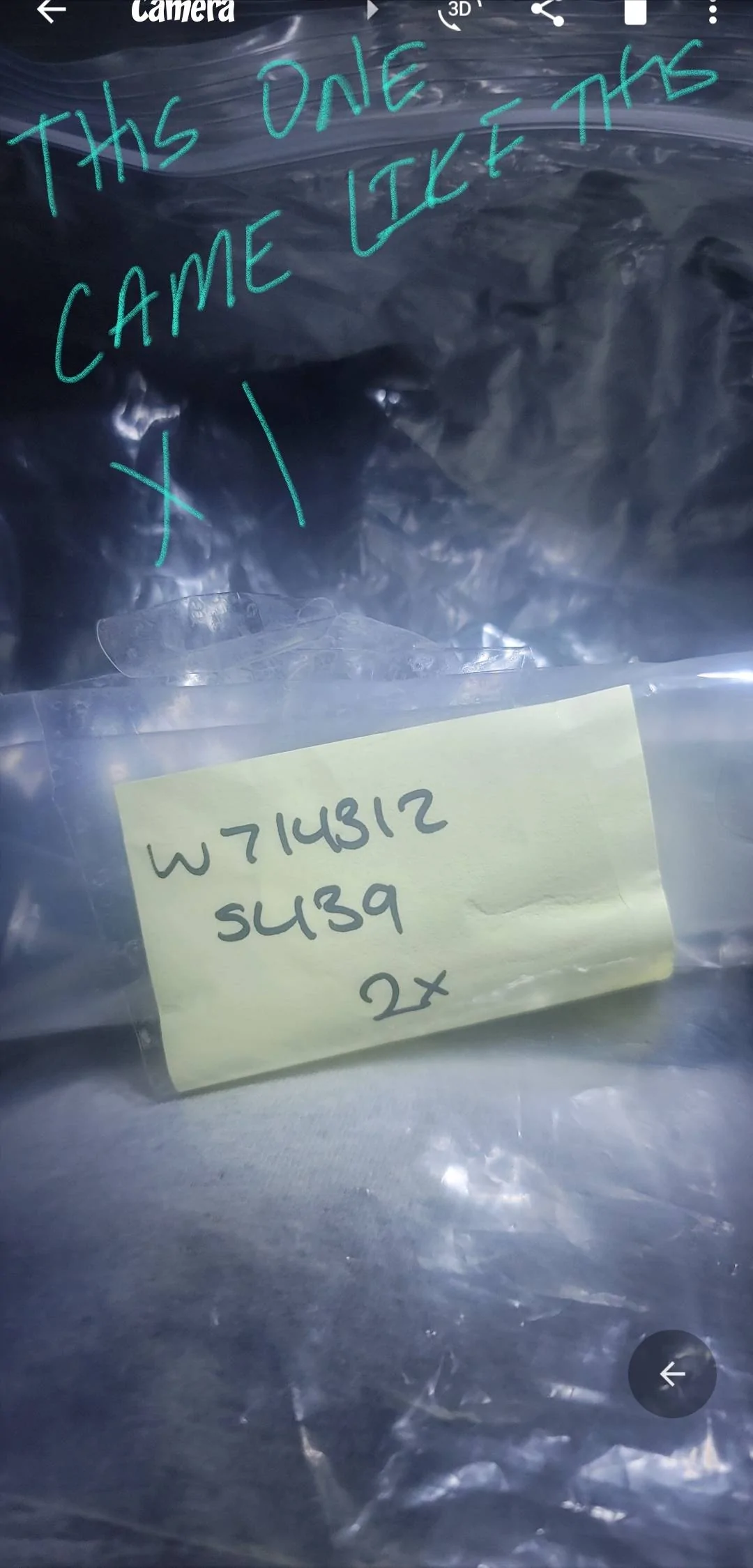

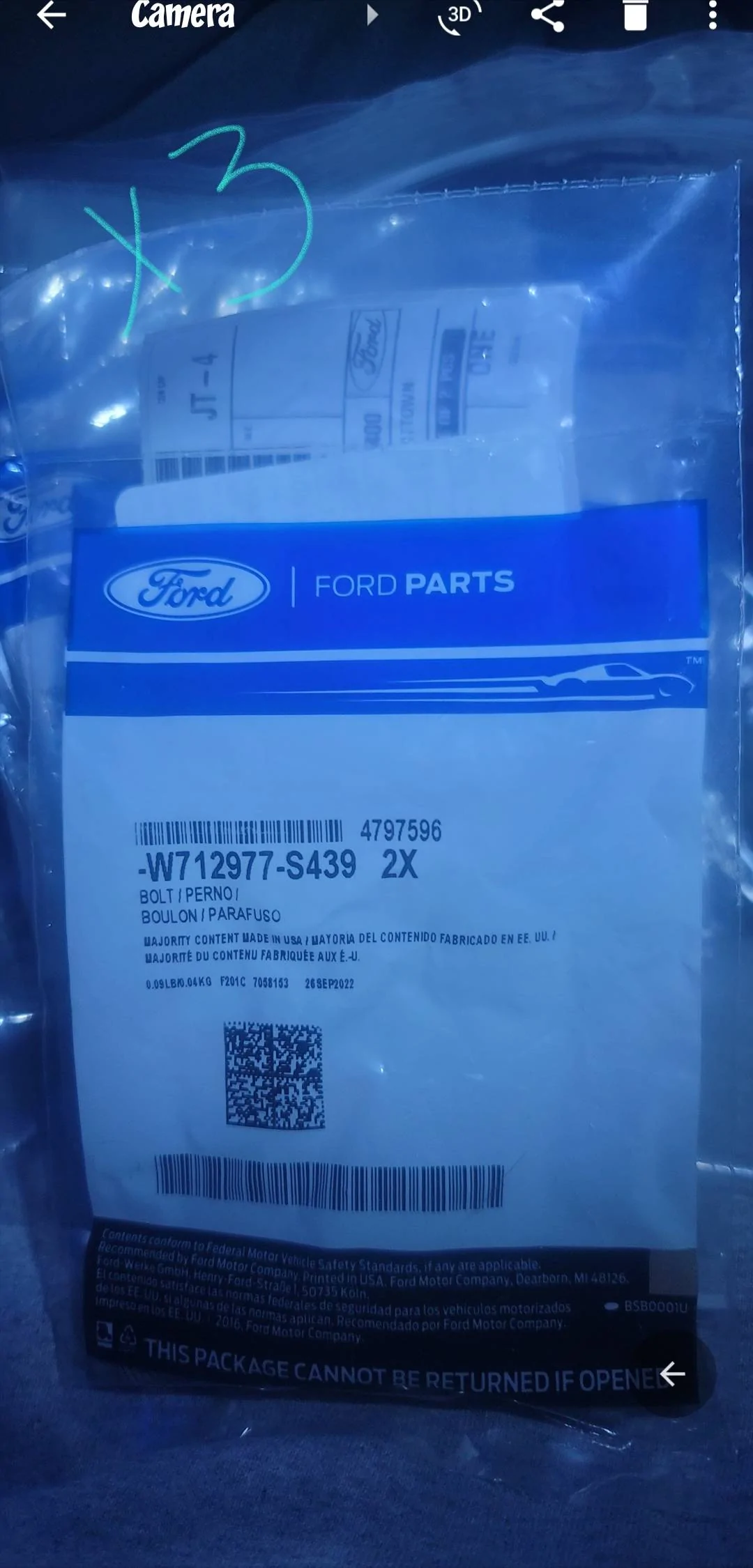

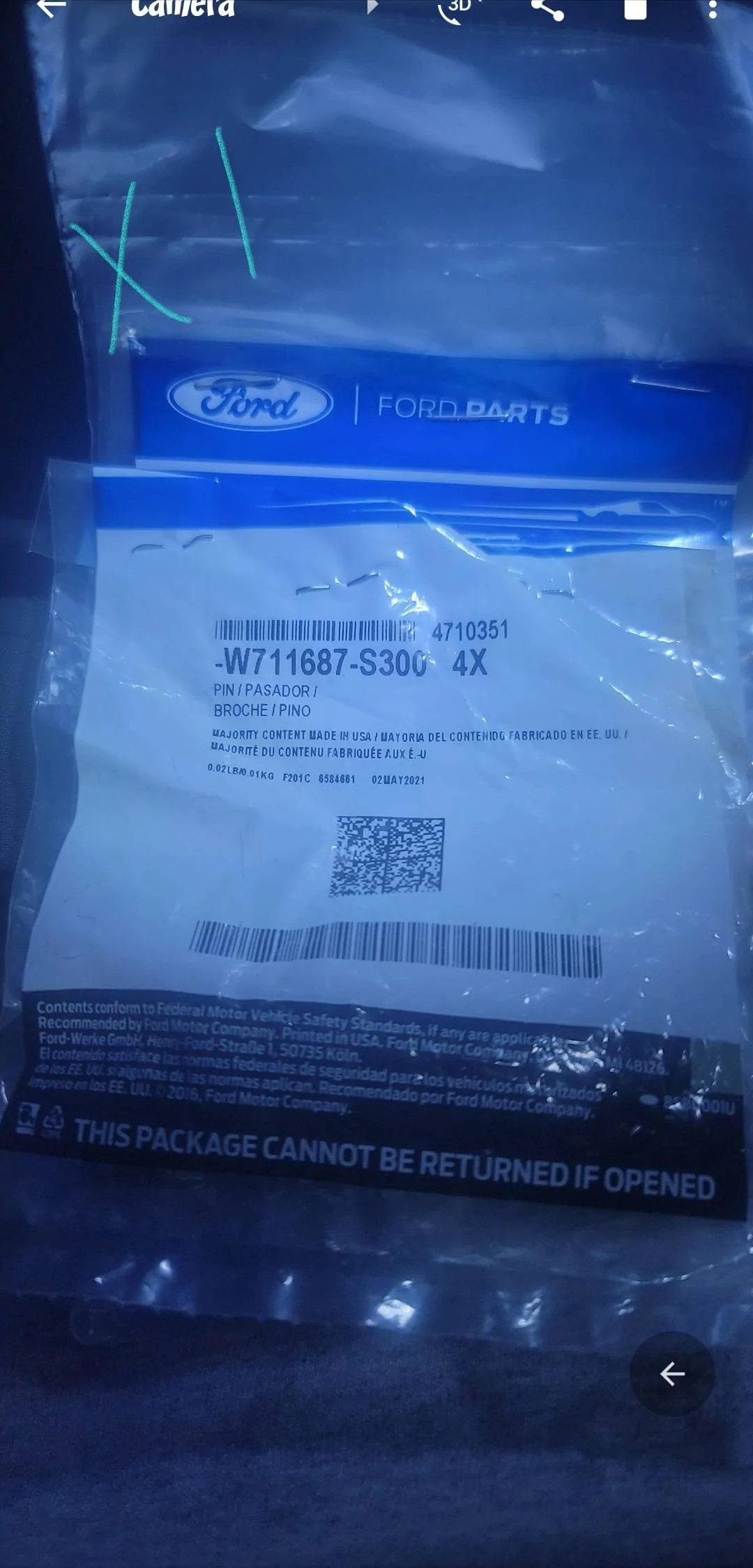

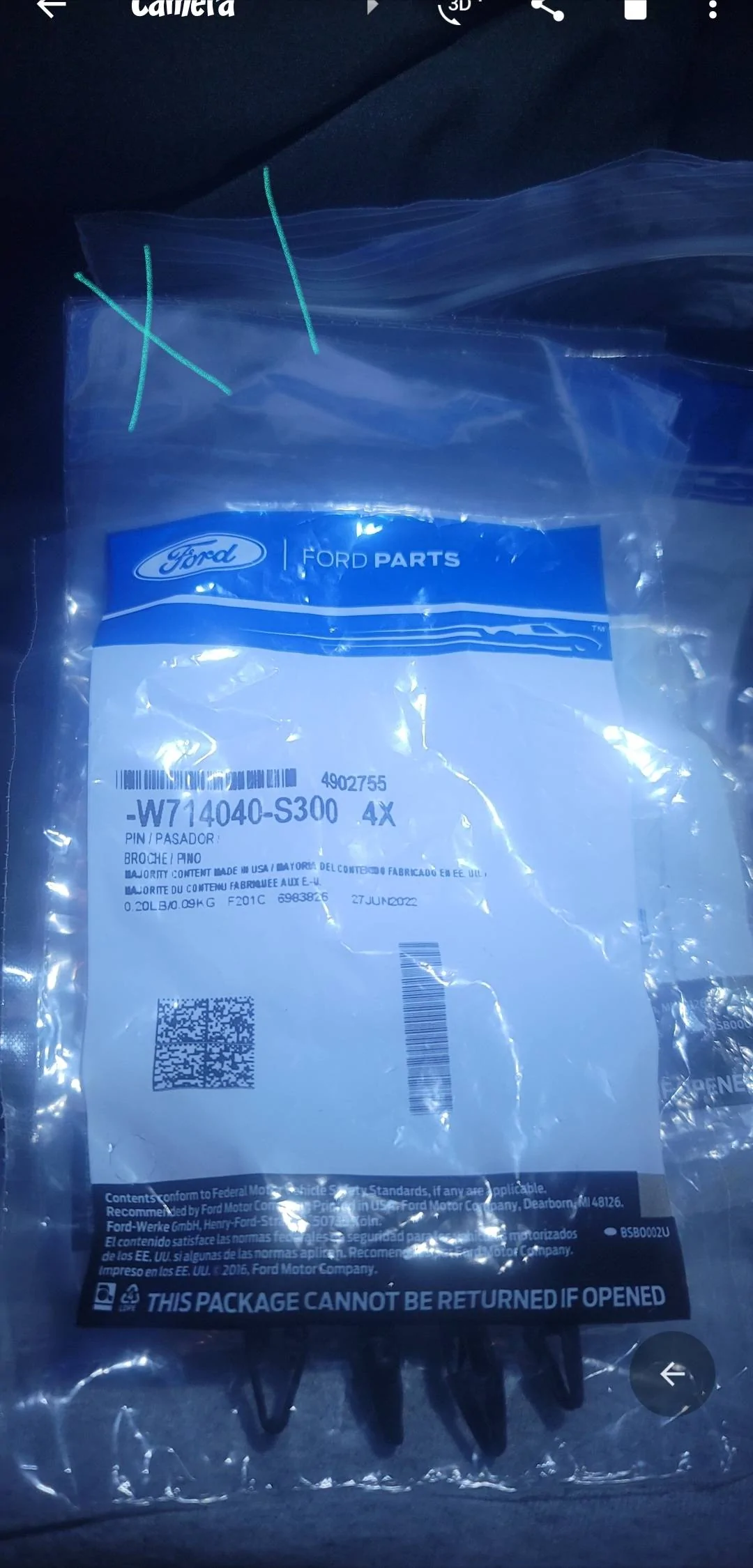

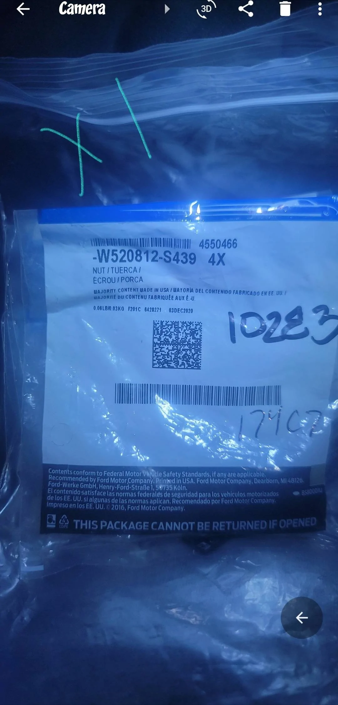

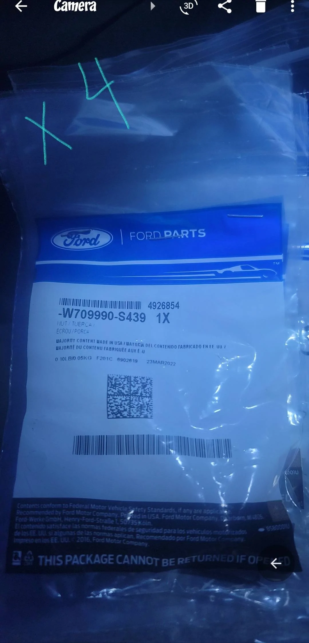

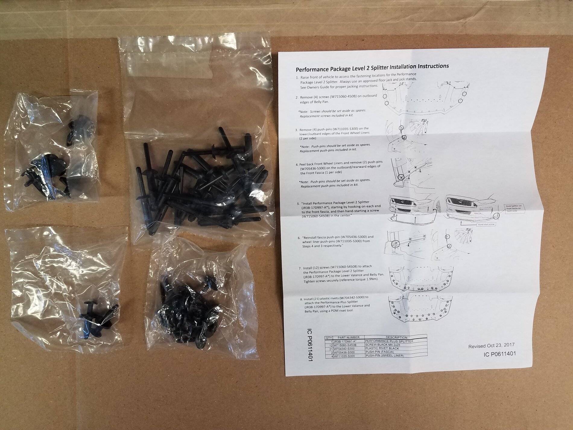

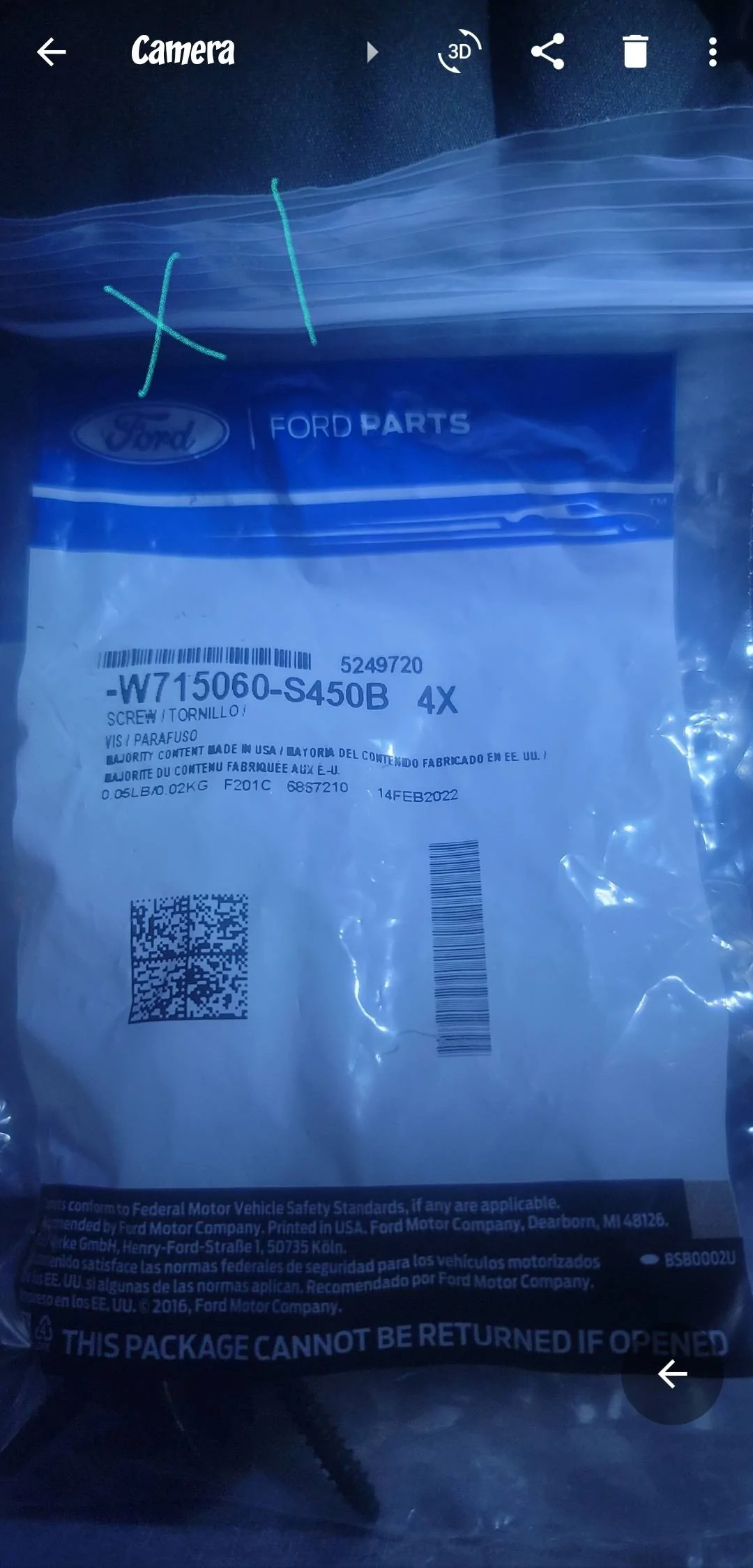

No part number as an individual package for all, but here is everything that came with my order. Hope this helps bud!

Hardware posted above is for gt500 rear valance. Just for clarification!
As for front splitter hardware, I'll have to dig a little deeper.

Ahh - thank you. Yeah, I want all new OE hardware for upper and lower PP2 splitter, belly pan, and insulator. And thanks for taking the time to post.

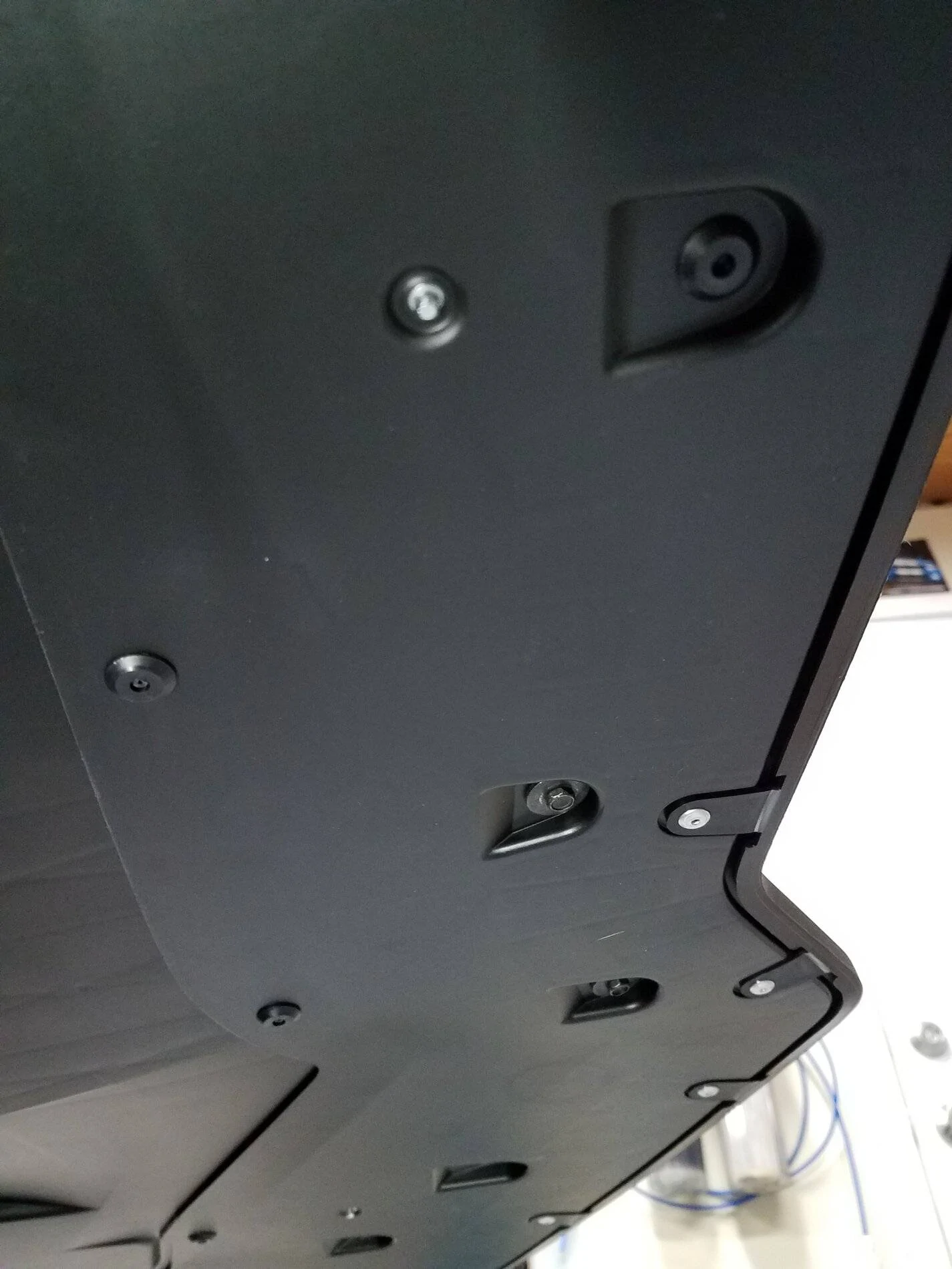

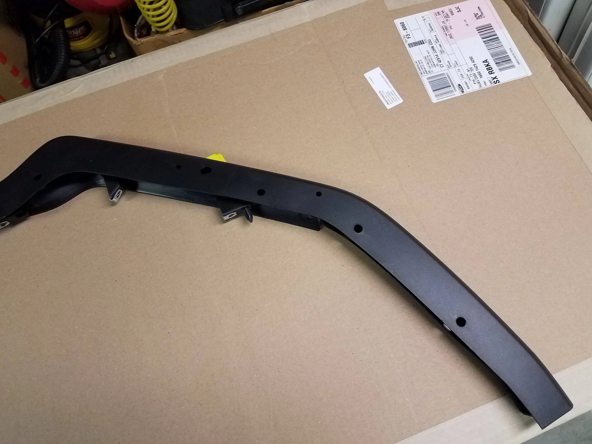

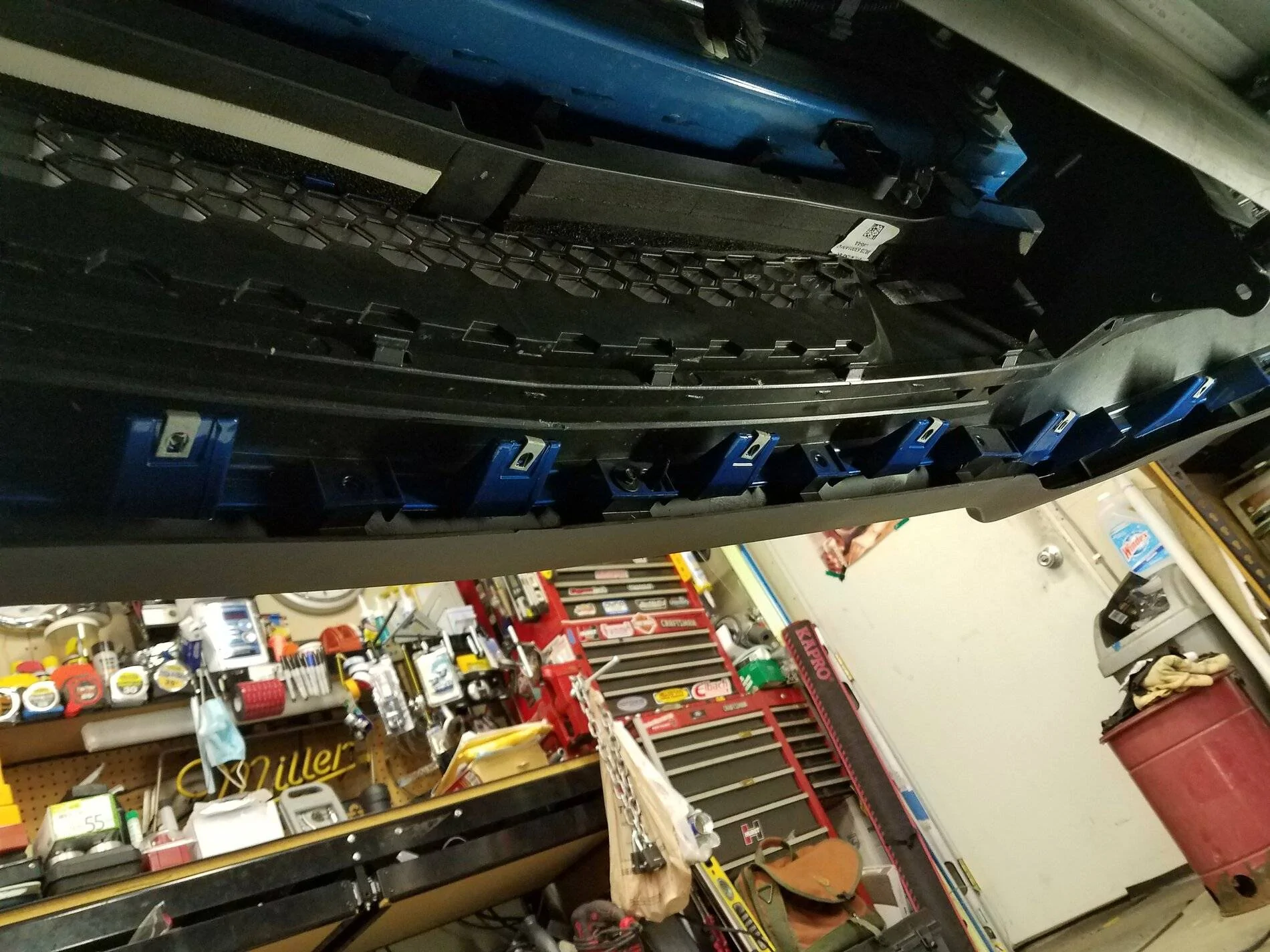

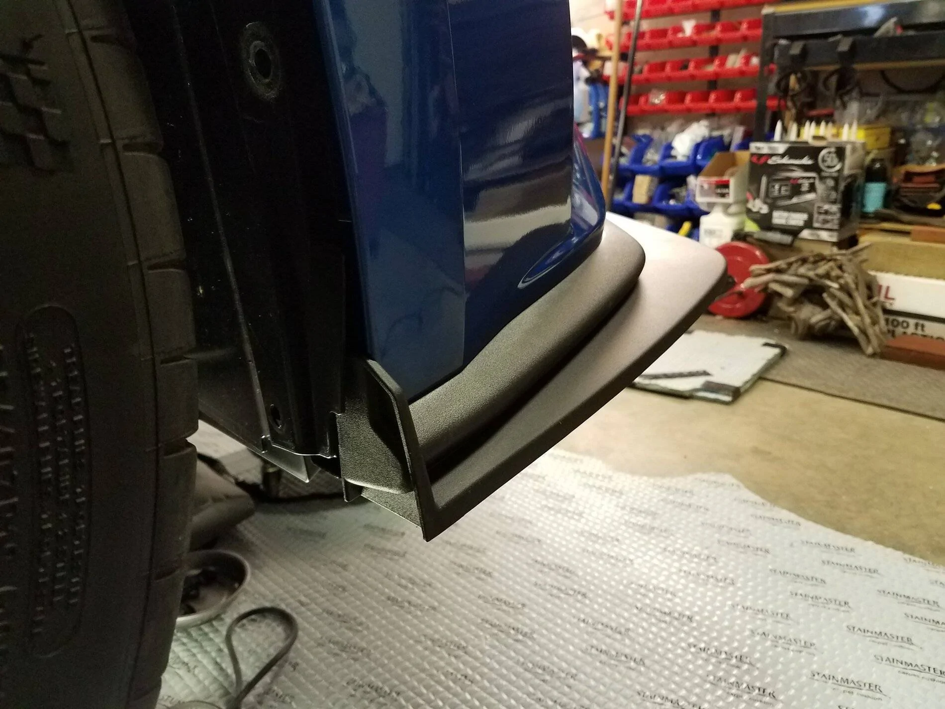

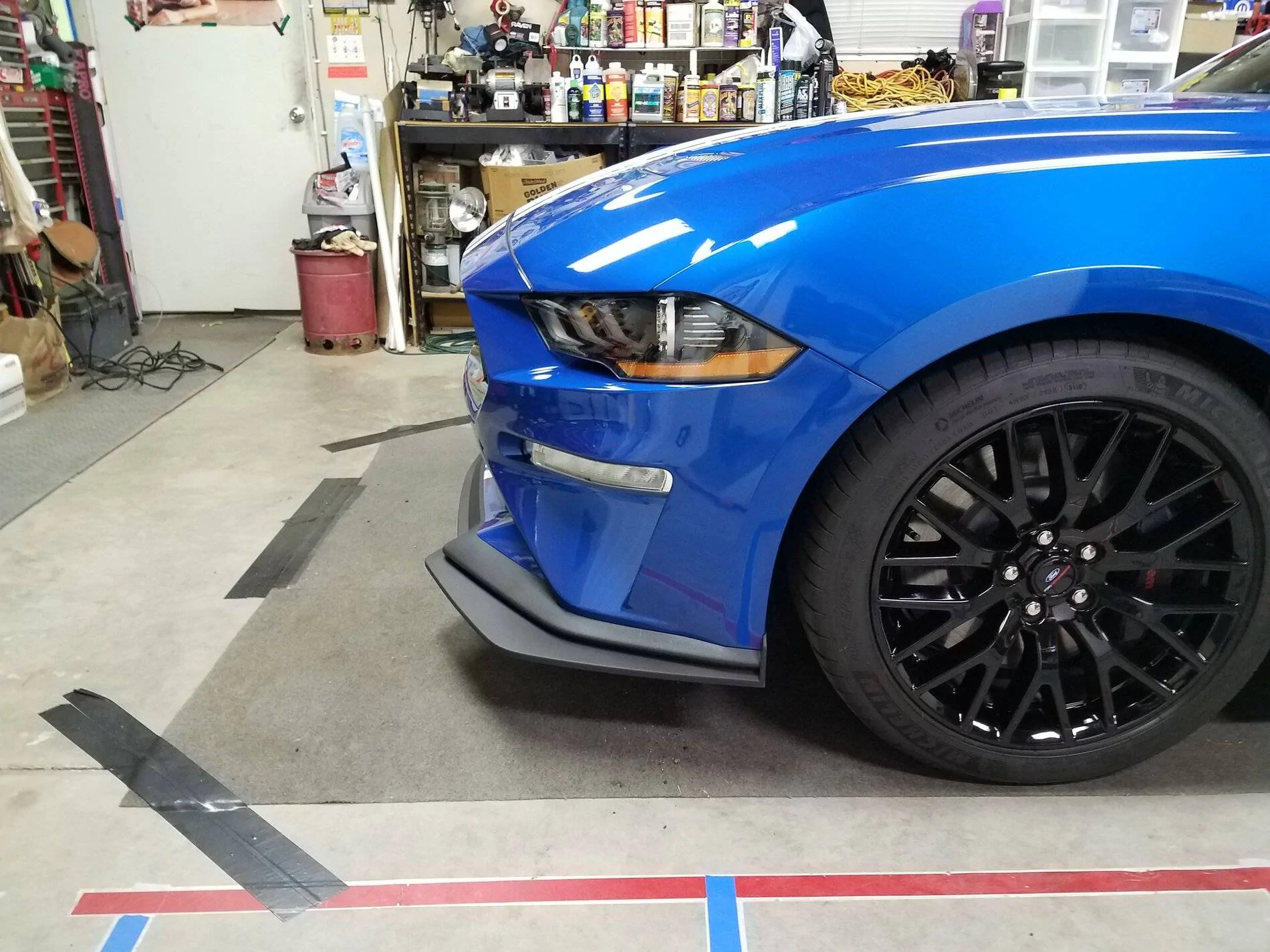

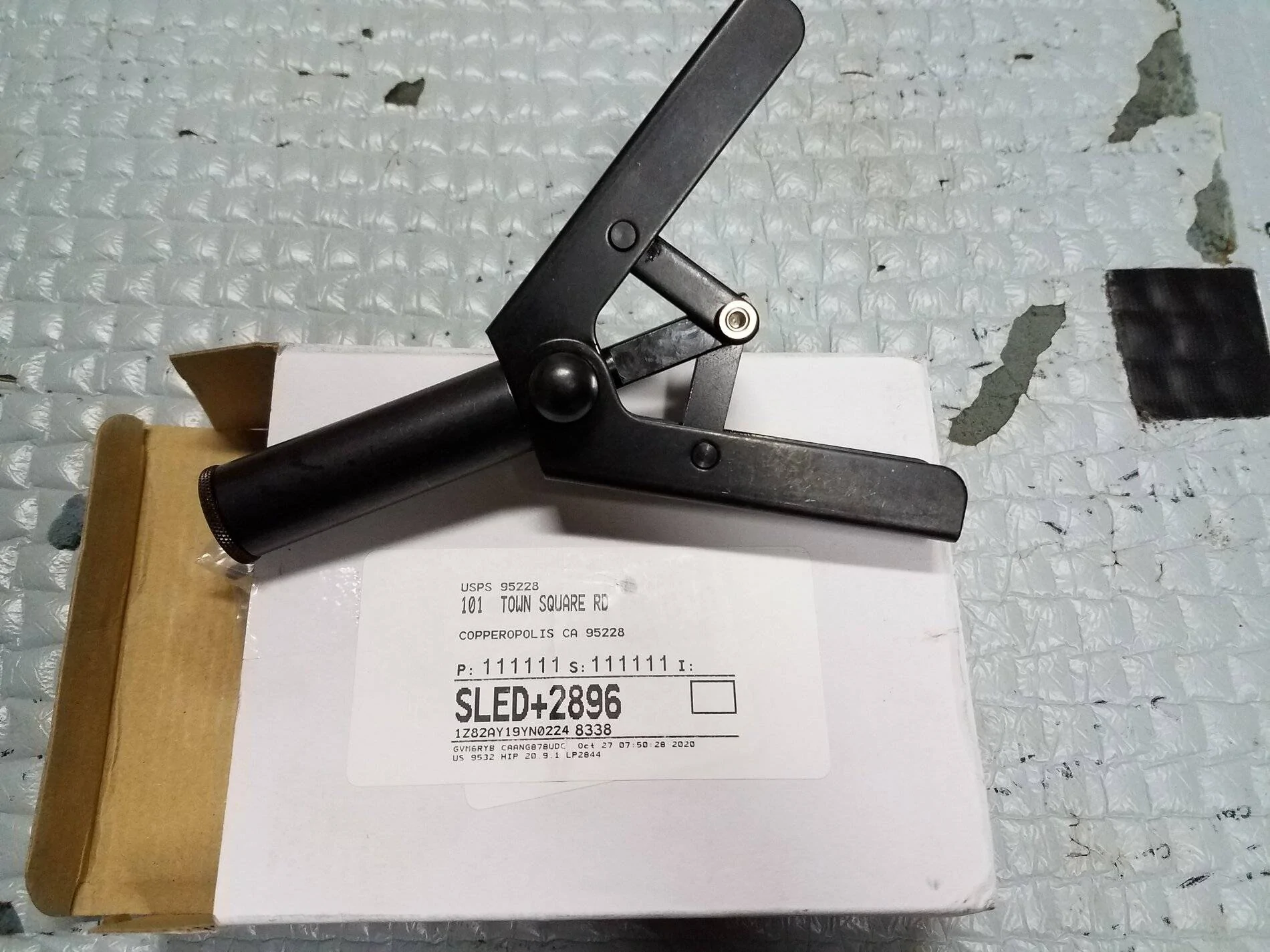

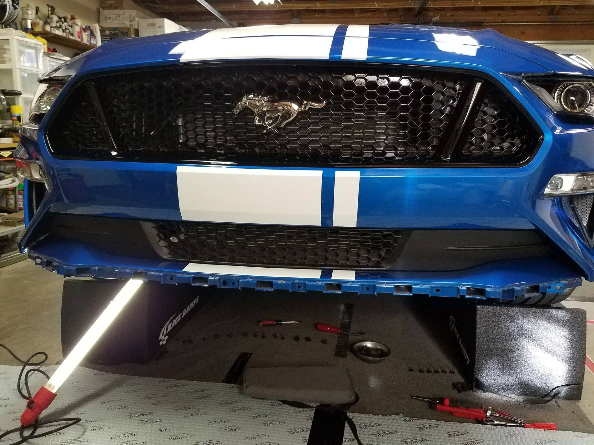

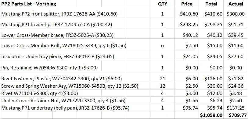

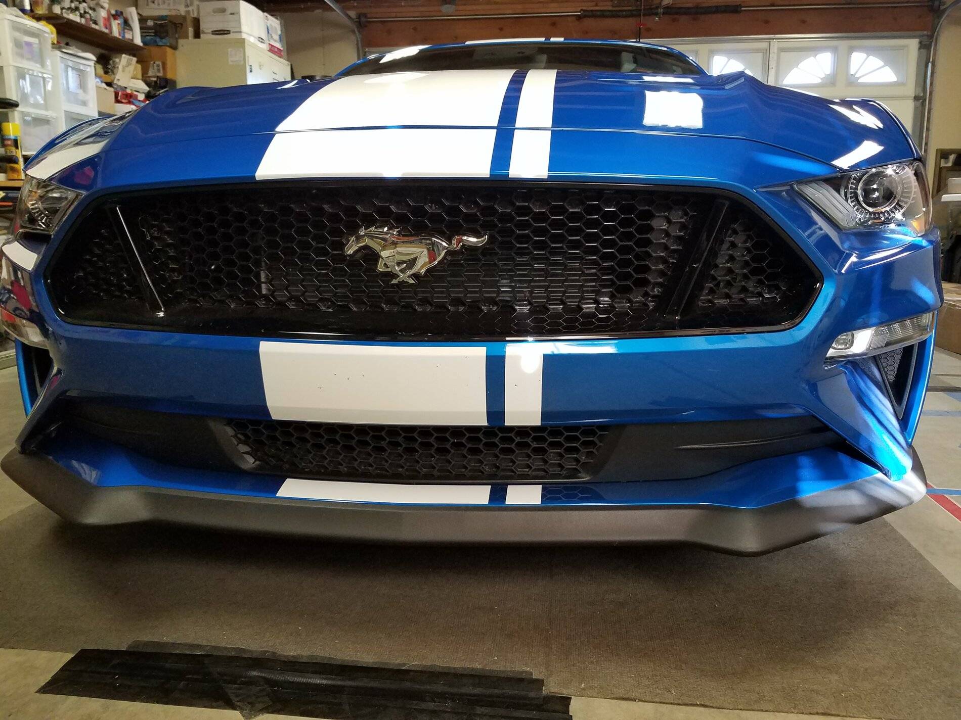

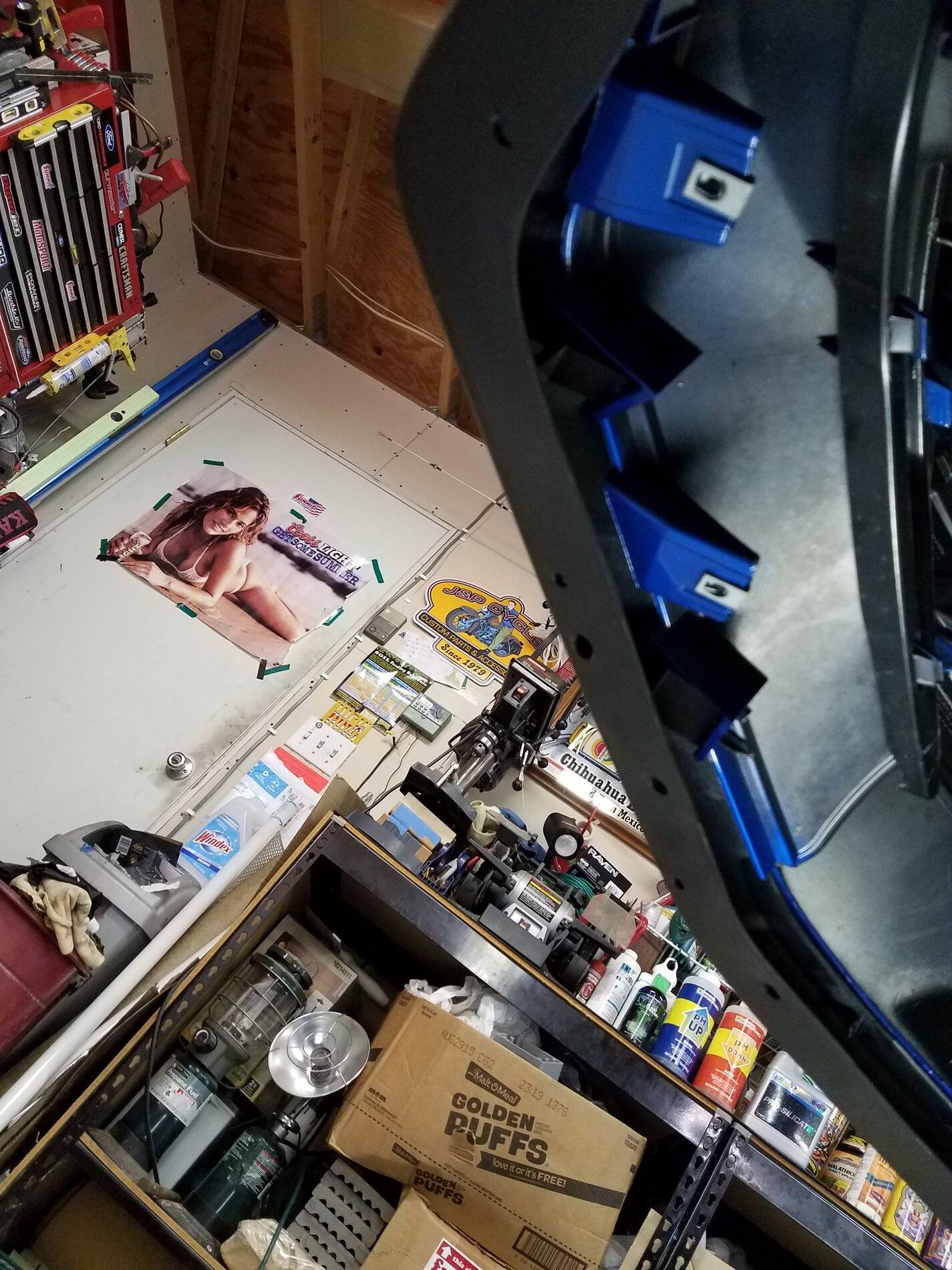

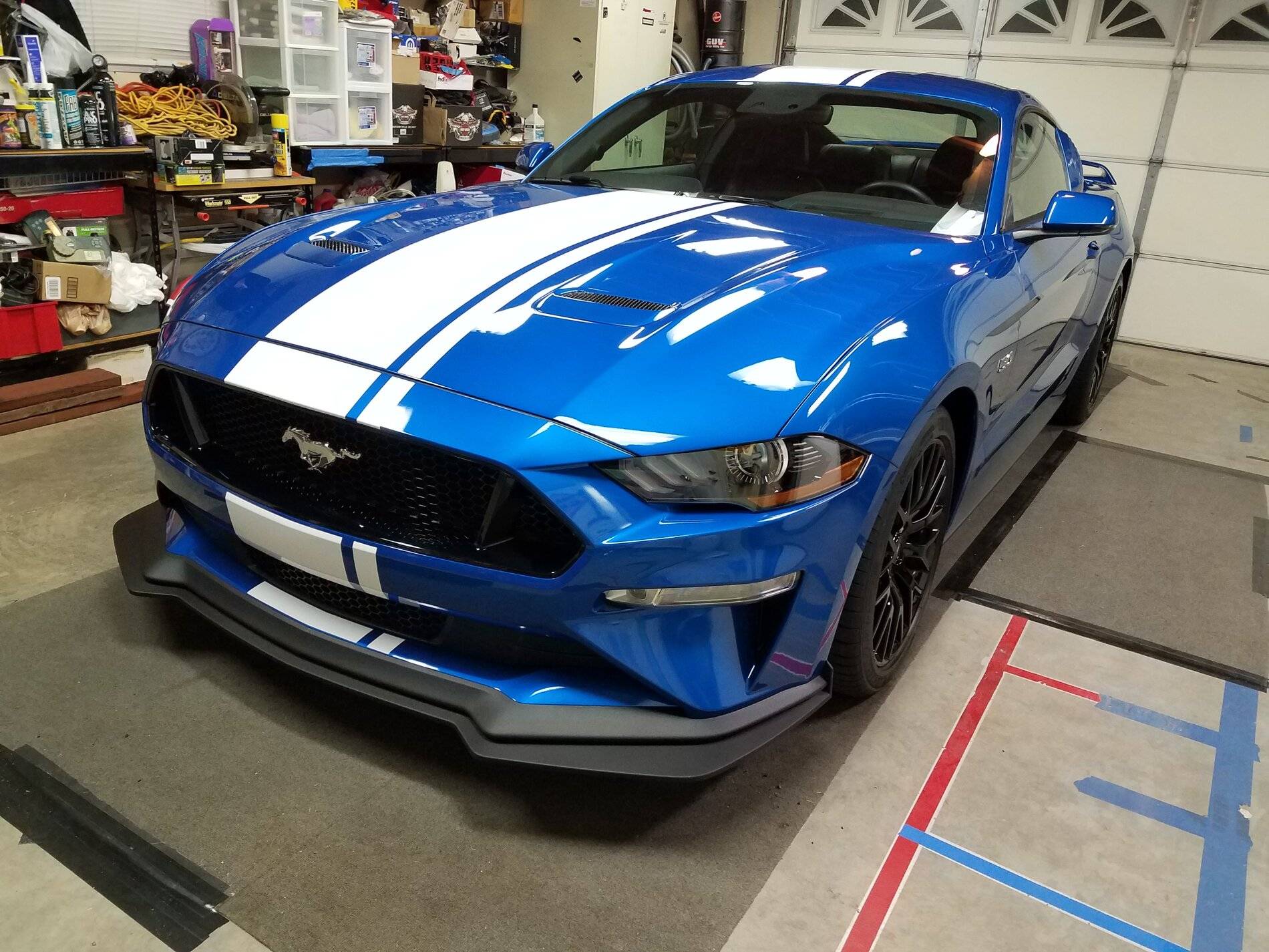

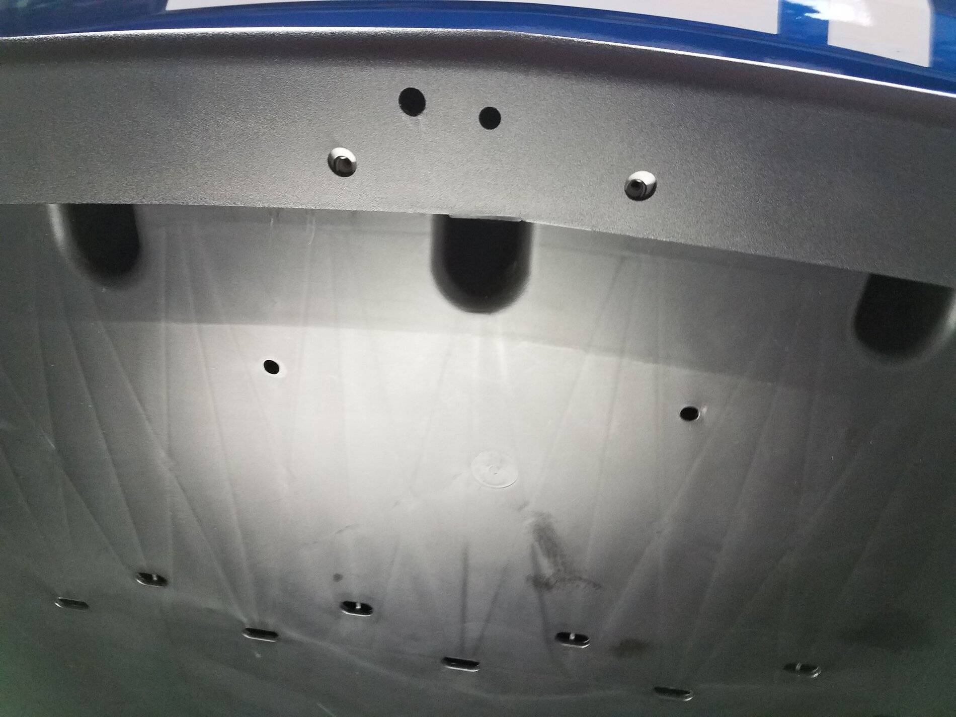

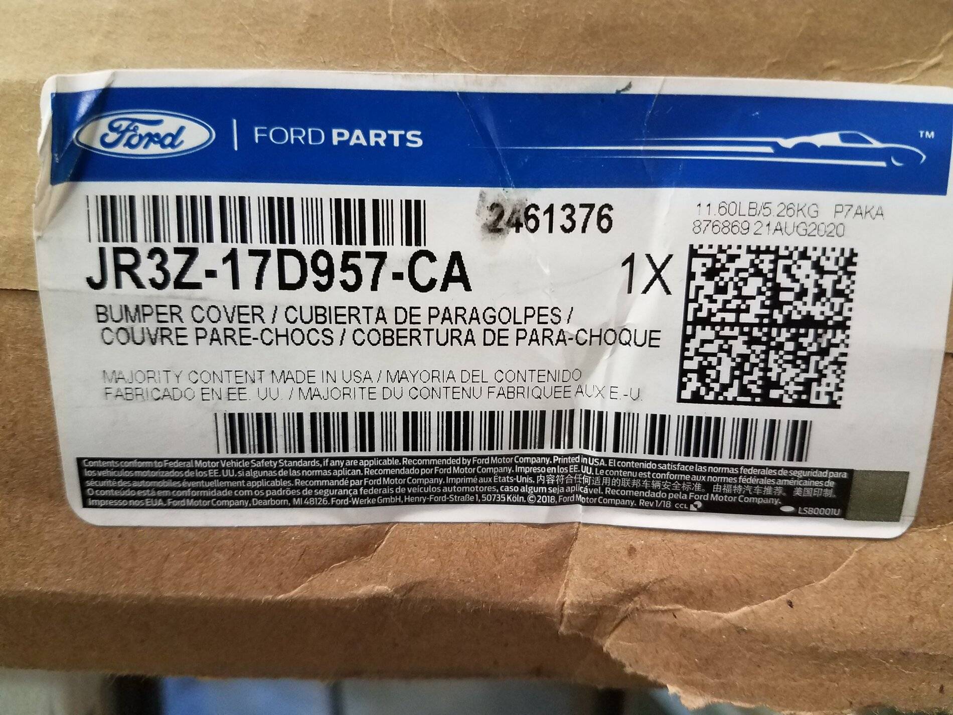

Might be worth a call to the parts folks at Levittown to see if they are aware of a kit. I had to piece that together on mine and at the time the stupid rivet fasteners were not available through Ford - which was fine because they are not worth $6/ea. I ended up using parts from Auveco who supply the parts to Ford, and also some generics from Harbor Freight. Pretty much all of the fasteners & qty's are in the bottom part of the list below. Not sure what's going on with the "Pin, Retaining, W705436-S300" and why I didn't obtain or use that one. It may not have been available either. Good luck - it's worth it!
