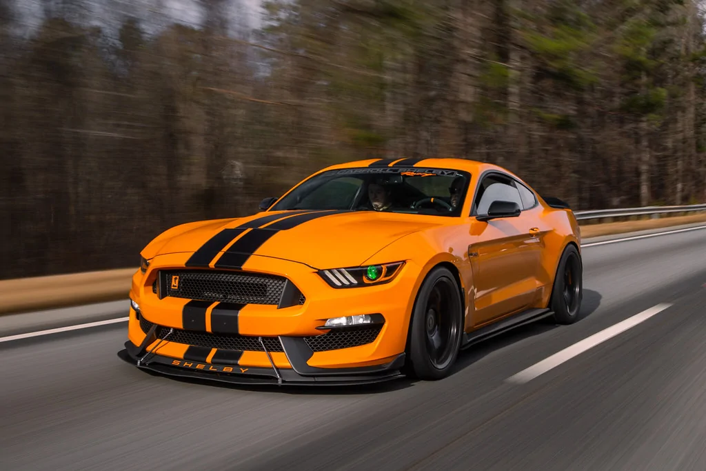

Not at all true with the FP GT350/Magneride springs. Sure they're stiffer than stock, but any lowering spring will be. They're far from excessive though and for a pure street car I think they're a great setup. I would recommend pairing them with their matching swaybar set as the bars are paired to match with the springs and work perfect together. It does lower the car some, but not to a major extent.

First I totally LOVE that Shelby! Great color and stripes! haha Second, after some track experience I added the Steeda Self Leveling springs (for Magnaride), their upgraded sway bars and camber plates to raise my GT level of handling. I got a little lowering and a more confident ride all around. Basically adding mods to a PP1 GT to get it closer to GT350 or Mach 1 handling level.
