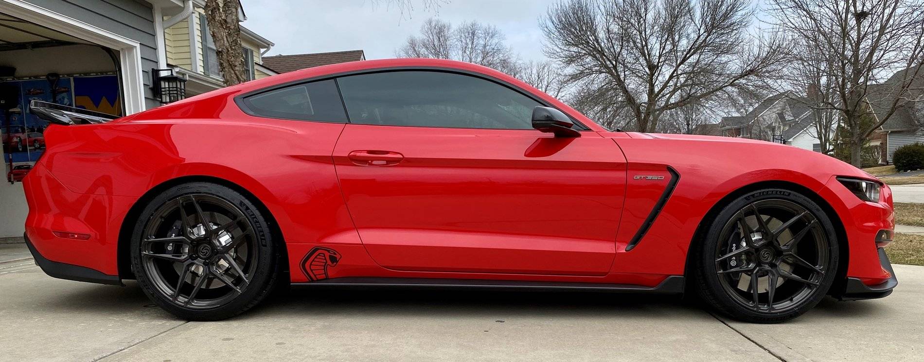

NoXiDe
Jun 26, 2018
72
860
469
GA
GT350
Honeybadger runs FP Springs. We know it's effective on the track with an experienced driver.

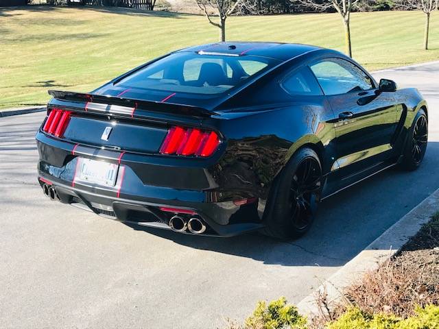

N17
Nov 12, 2017
167
267
Canada
Victor
2017 GT 350, 2018 Macan T , 2021 Ram 1500, 2015 R8
I also installed them for the looks, plus i am running the OEM 35 series tires on a set of R spec wheels.
The tires are a little stretched so the lowered springs help to hide the wheel gap a bit more.

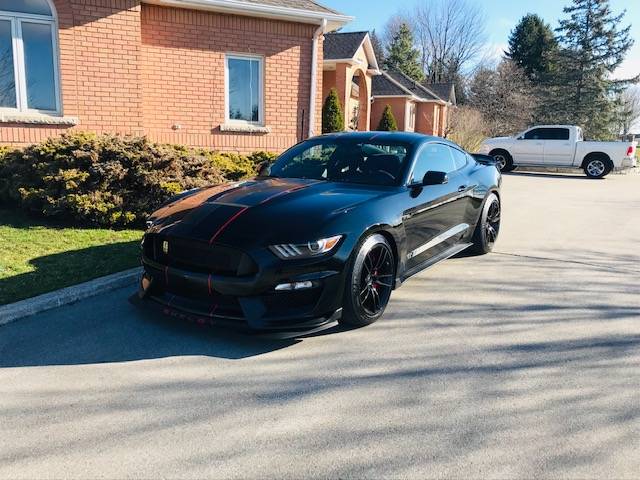

N17
Nov 12, 2017
167
267
Canada
Victor
I installed them more for the look than anything (to compliment the Signature 20's) but i have noticed less sway on the street.
This car is gorgeous, love the wheels.
