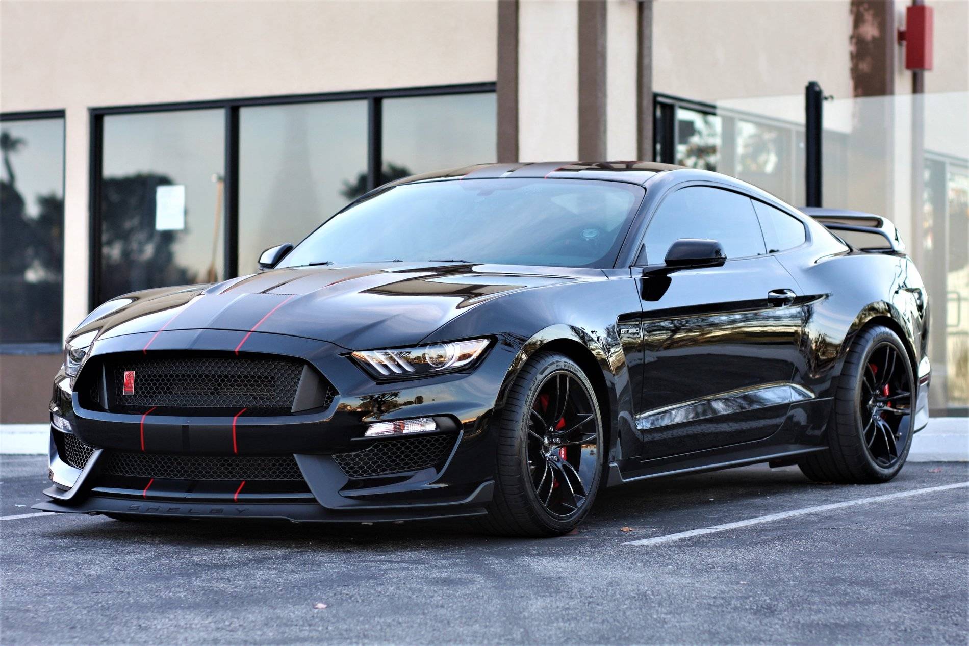

I also installed them for the looks, plus i am running the OEM 35 series tires on a set of R spec wheels.
The tires are a little stretched so the lowered springs help to hide the wheel gap a bit more.
LOVE
those wheels! Look like the GT500 non-CFTP and the Ford GT wheels. What brand, model, sizes are they?
Also, I read that "stretched" tires provide a bit better sidewall stiffness for tracking. What size, brand tires are you using on those rims?

LOVE those wheels! Look like the GT500 non-CFTP and the Ford GT wheels. What brand, model, sizes are they?
Those look like the P51 wheels and stock tires to me.

they are mrr m600's. very similar to p51's but slightly more robust. mrr's on my car...
Thanks for the source! Love that style wheel! No pricing on MRR site. About how much do they cost?
