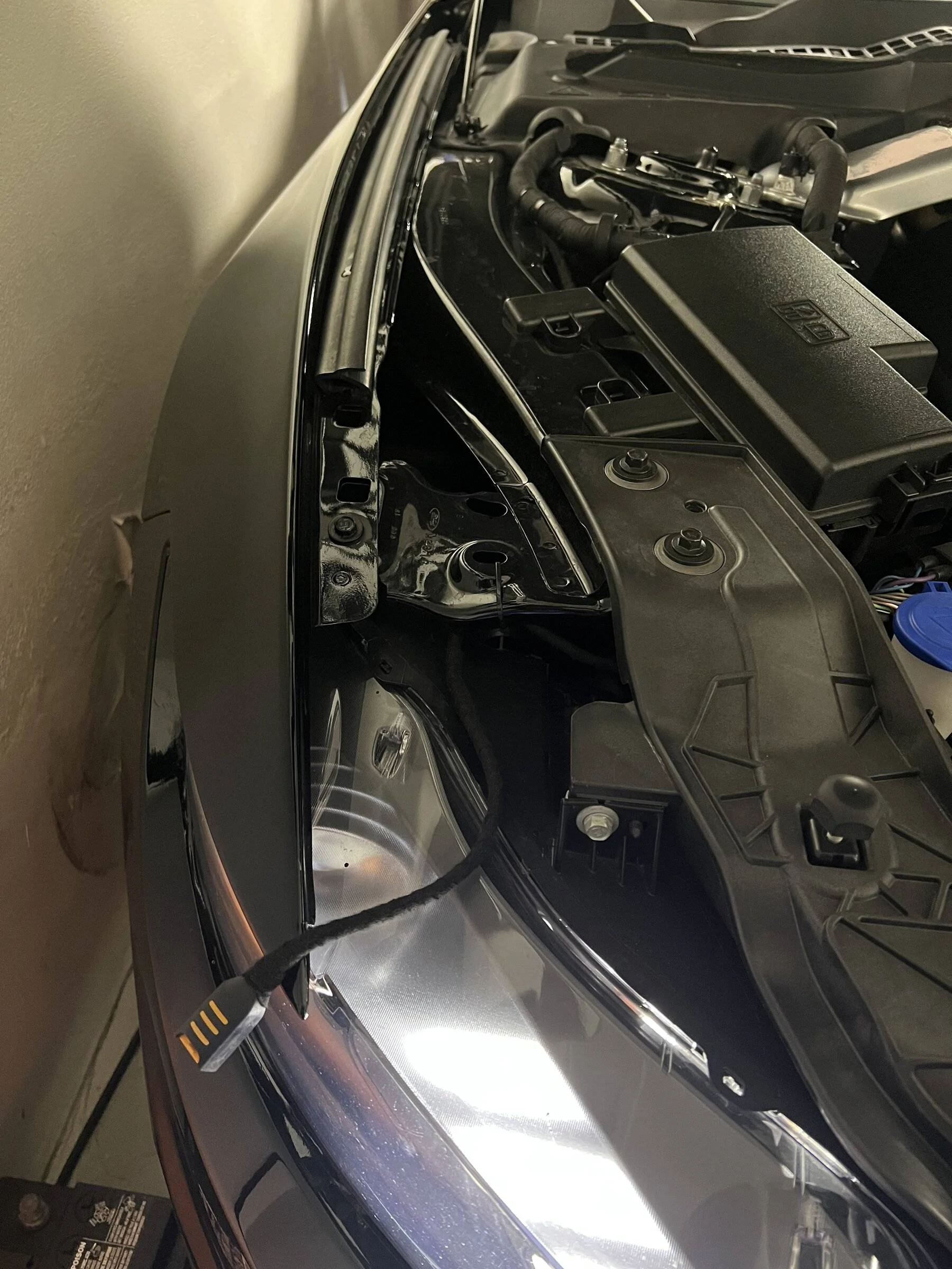

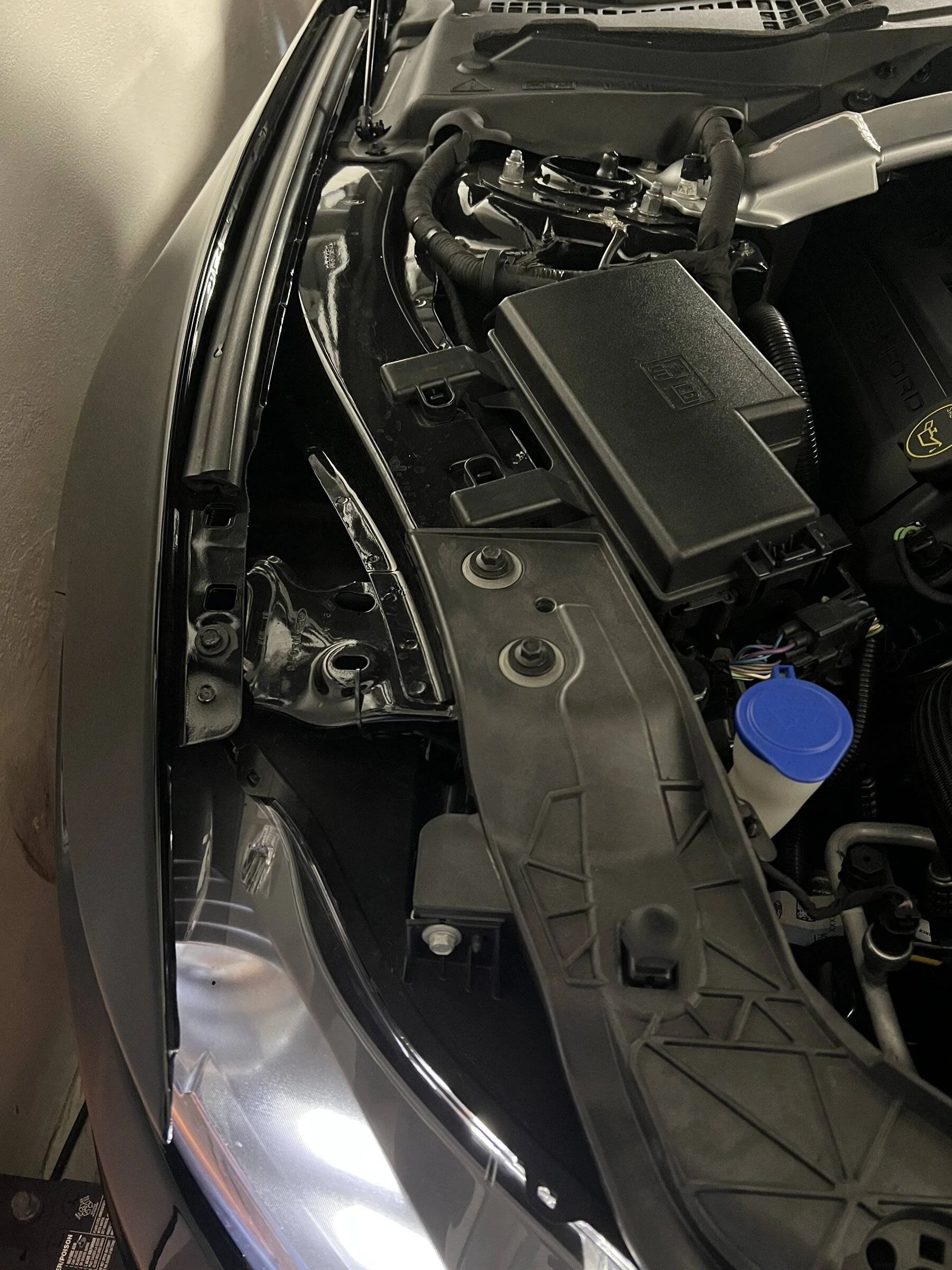

I don't have any pictures of it now, but for my 350I ran the eyelits to the battery, then installed a 3'ish foot extender (from them) which lets me drop the attach point to just behind the passenger side headlight. I have it wrapped in thread tape, and zip tied where applicable so its totally hidden. When I'm going to let the car sit on the charger, I can pop the hood, get the female charging connection just behind the headlight and put it out over the top of the passenger headlight, close the hood, make the connection, and then cover it over. Very slick setup.

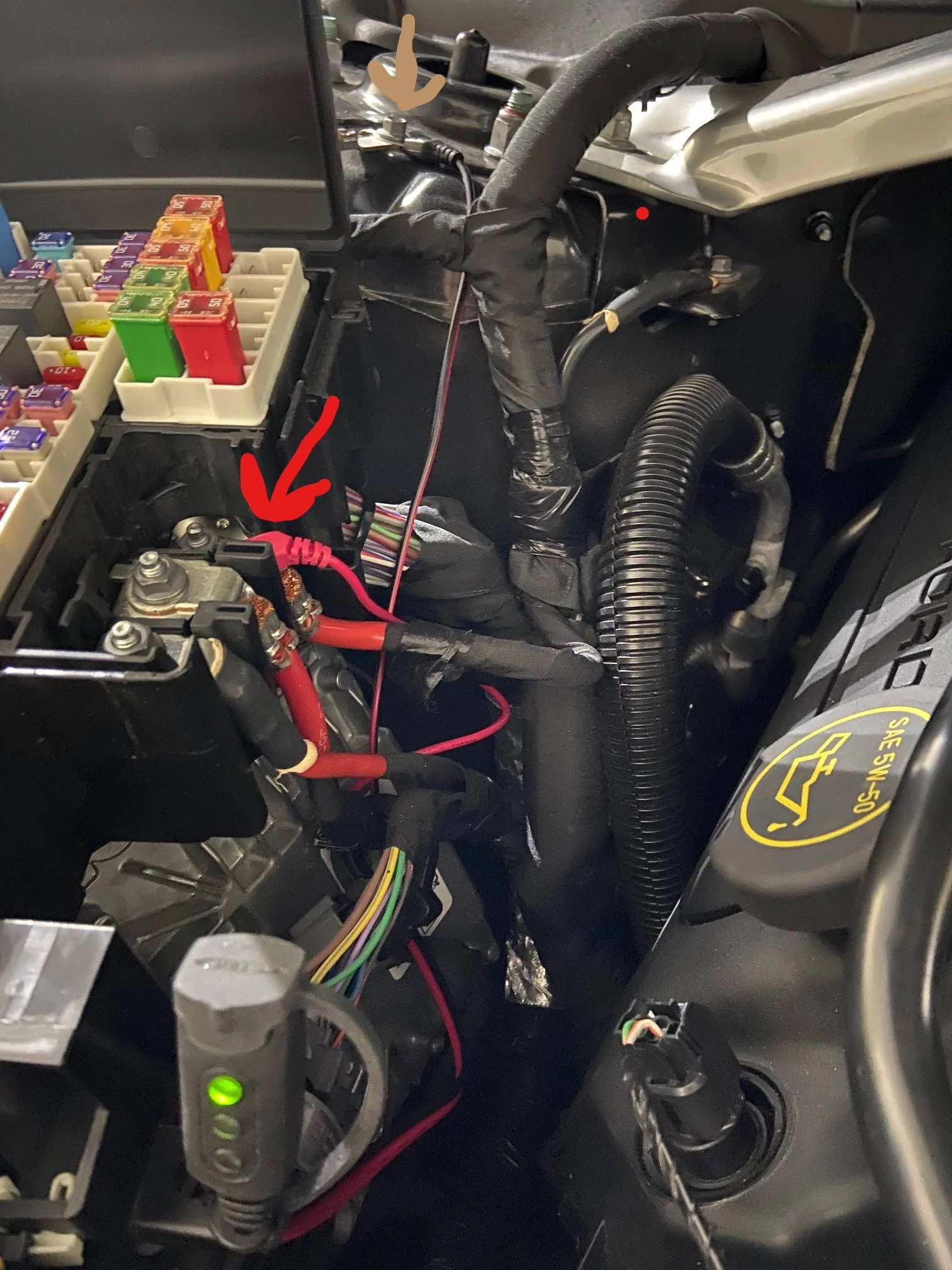

Matthewr87: If it helps any, here is how I connected my CTEK eyelet wiring, as shown by the arrows. The negative is connected to the strut tower (tan arrow), and the positive to the lowest of the 3 wired terminals as shown by the red arrow. The "traffic light" connector (w/ green light showing) that I've zip-tied in place is where I connect the wiring from my CTEK 7002 and run the wiring under my hood as described by Pilotgore.
That red/yellow/green light charged indicator is an optional extra cost item I purchased from CTEK, but not essential to the connection. I also bought an extra length connecting cable from them to preclude any problems reaching my sole electrical outlet in the garage regardless of which side of the garage my Shelby is parked.
Hope this answers your concerns. Good luck!

Not a stupid question at all; in fact, one of the concerns I had as well when doing mine, since I didn't want to lose and have to reset any settings stored in memory if my battery was disconnected! So, I connected my eyelets one at a time, without disconnecting my battery, with no problem. Engine off, of course.
There's also a good thread on this topic elsewhere, entitled "Simple (but clever) CTEK Battery Panel Install" where myself and others discuss this whole process and various options, in case you haven't seen it.
