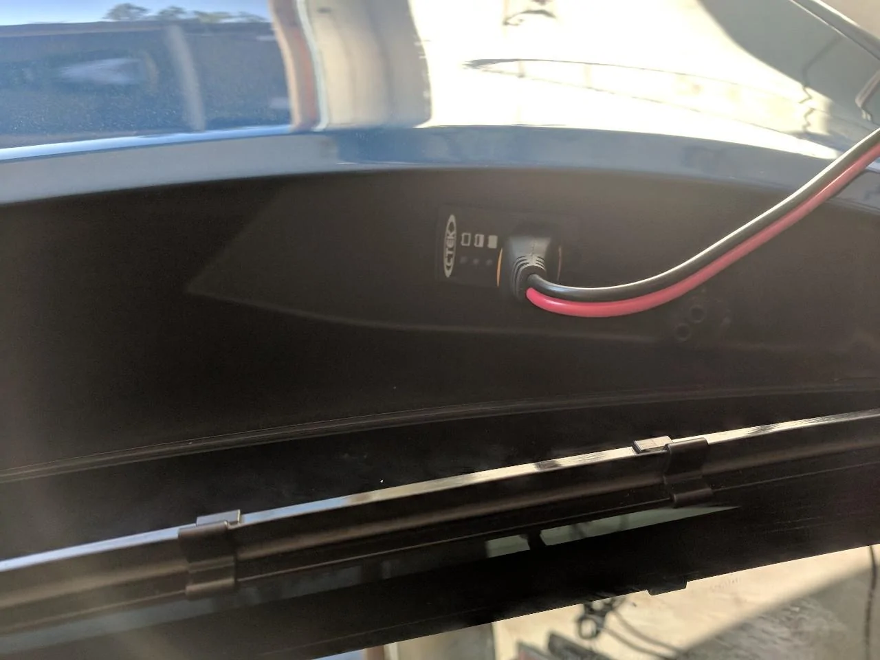

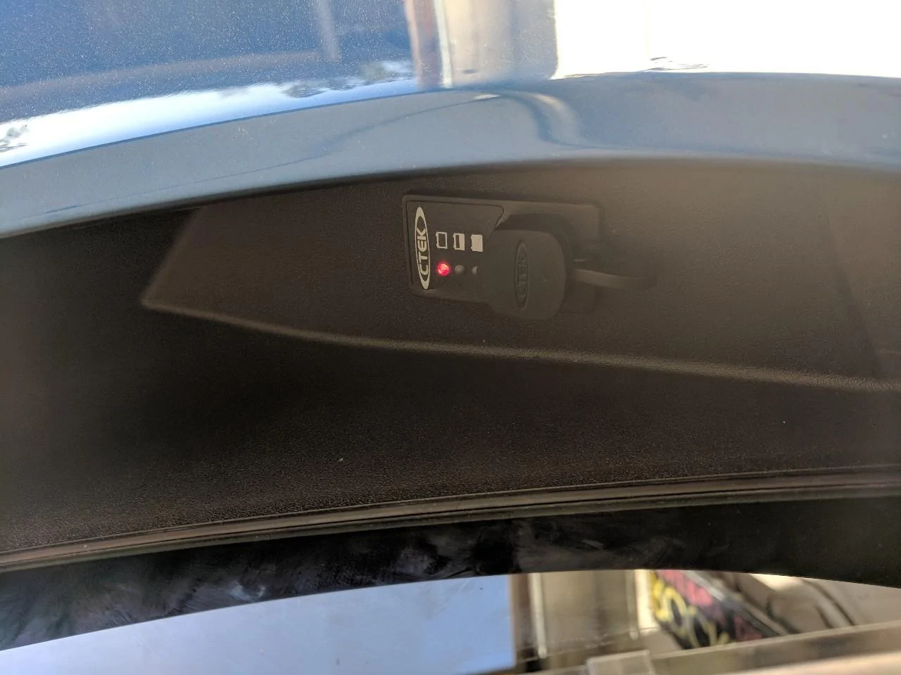

Needed a charger/ maintainer in order for my battery not to drain because of the dash cam being on 24/7. Bought this off Amazon with excellent reviews. Product is nice and good quality. I also bought the comfort indicator panel after watching a installation video on a gt500.
It came really nice and very convenient. No popping the hood Everytime you want unplug it or plug it back in.

I went with the NOCO but also brought the cable up like u did by the cowling bellow the wiper, tucks in nicely, charge can rest on the wiper and u can see the status. It works great definitely keeps the battery charged, if I forget to plug it in, 10 days and its jumper time.

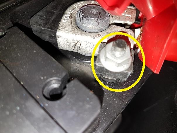

Did you guys hook up the indicator to the battery using the eyelets?
If yes, how did you guys remove the nuts (see attached photo)?
I tried to unscrew them but at almost at the top, the whole screw move loosely, stopping me from removing the nut as they are still tight. :shrug:

I did use those. At first, they stopped me but then I persisted, got them off and buttoned it up.

Push the bolt up from the bottom and hold it while you are opening the nut.

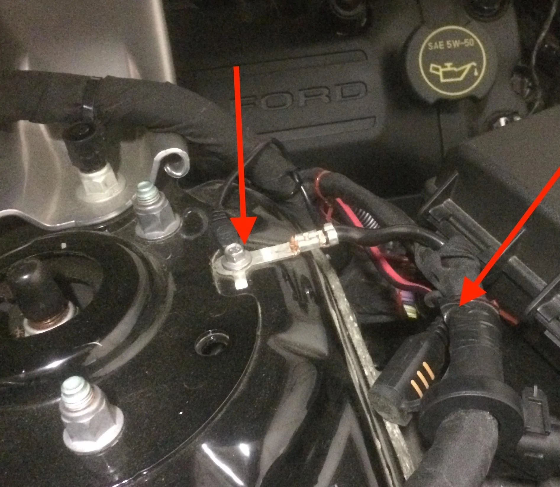

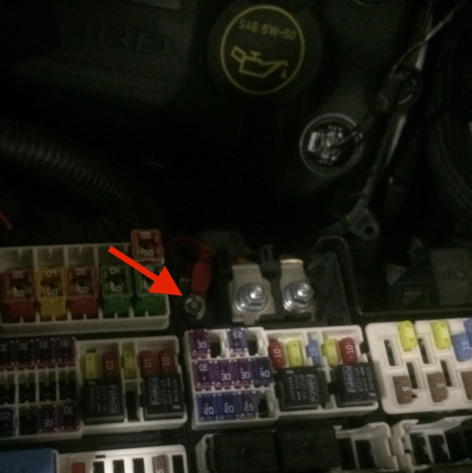

Also have a CTEK and love it. Found that connecting the positive to the fuse box and grounding where shown below was cleaner than connecting to the battery. When hooked up, the wire to the CTECK can run through the cowel or exit near the headlight. Just wish I would have gotten it before having to replace the orig battery :frusty:

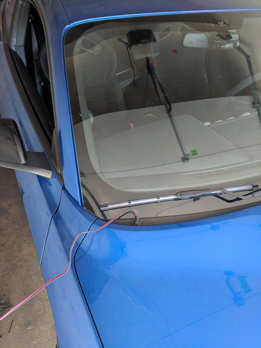

What dash cam are you using and how did you wire it?

Dual 750s. Connect to the fuse box in a hot fuse port using add a fuse. I also ran a 2.5amp inline fuse just to be safe.
