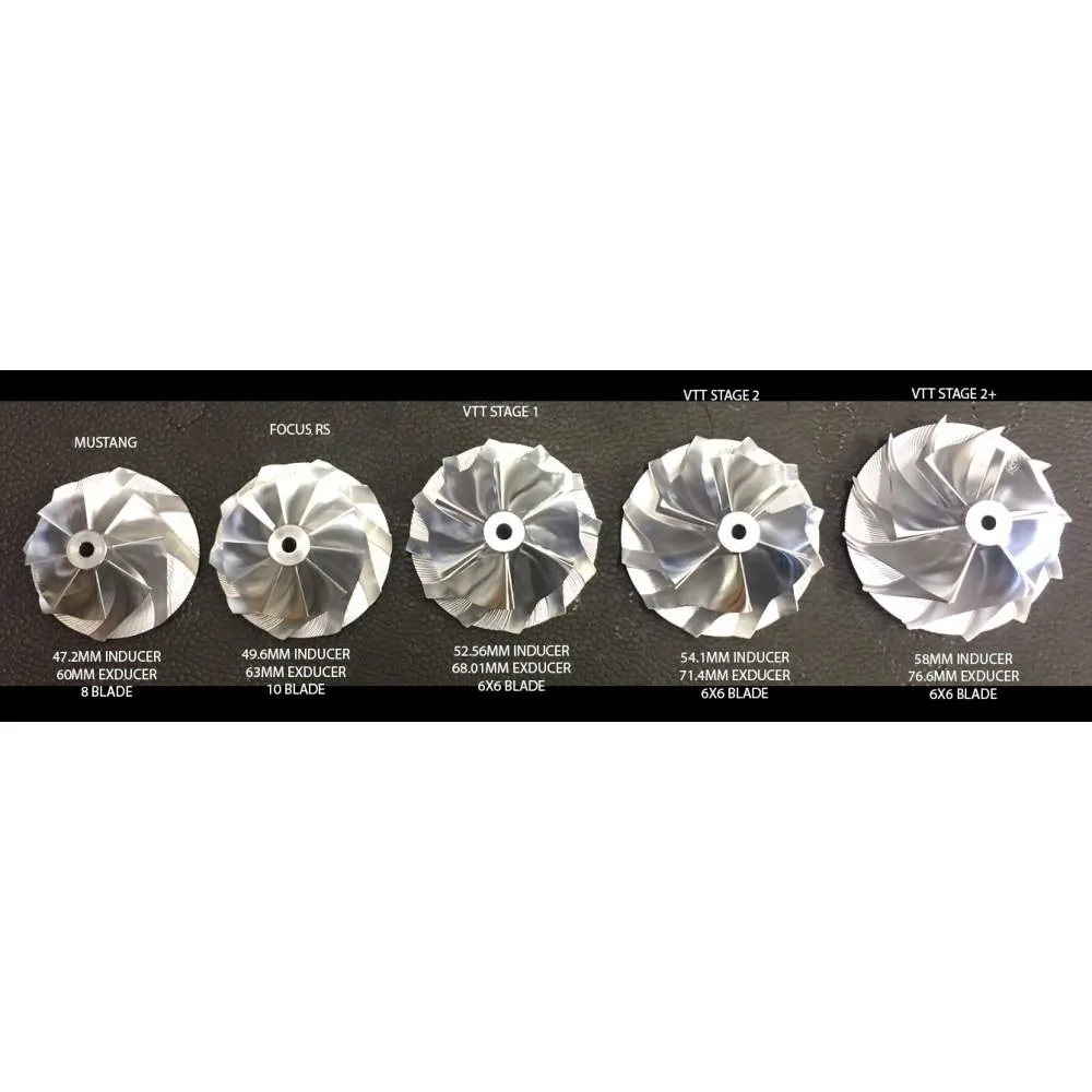

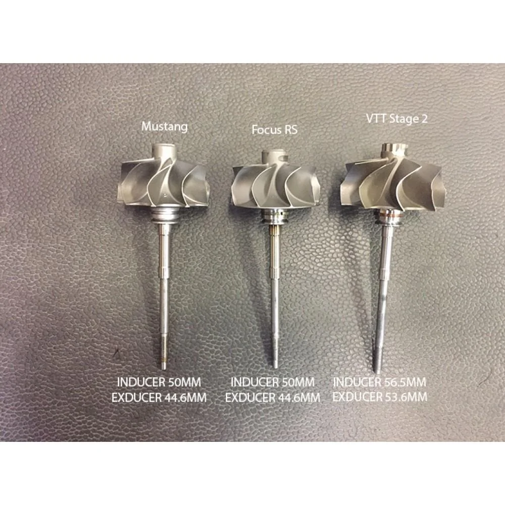

I think you are right, the FoRS is single all the way to the back where it has a Ginormous muffler that has a tip on either side. No other resonators in the system, Ford for some reason thought Mustang Drivers wouldn't like to hear turbo sounds and did their damnedest to try and make the EBM sound like an NA car and failed miserably. They wanted the FoRS to sound like the relatively large displacement (for a turbo 4) engine that we have and tuned cam timing the exhaust, intake and BOV accordingly.
My money is the turbo. It's a bigger turbo so it's deeper, a little more throaty. Check out vids of people with upgraded turbskies, their exhaust is much better than an equal exhaust on stock
That was a good guess but the turbos are identical on the exhaust side,
it is only just 2.4mm bigger on the compressor side which will not affect tone.
But you are absolutely correct all the big turbo EBMs typically sound better than stock turbo ones with the same exhaust system.

Hadn't seen these pictures before very cool and informative. I always thought the turbine and compressor blades were more curved shape like a centrifugal fan, or my little key chain model. :thumbsup:
