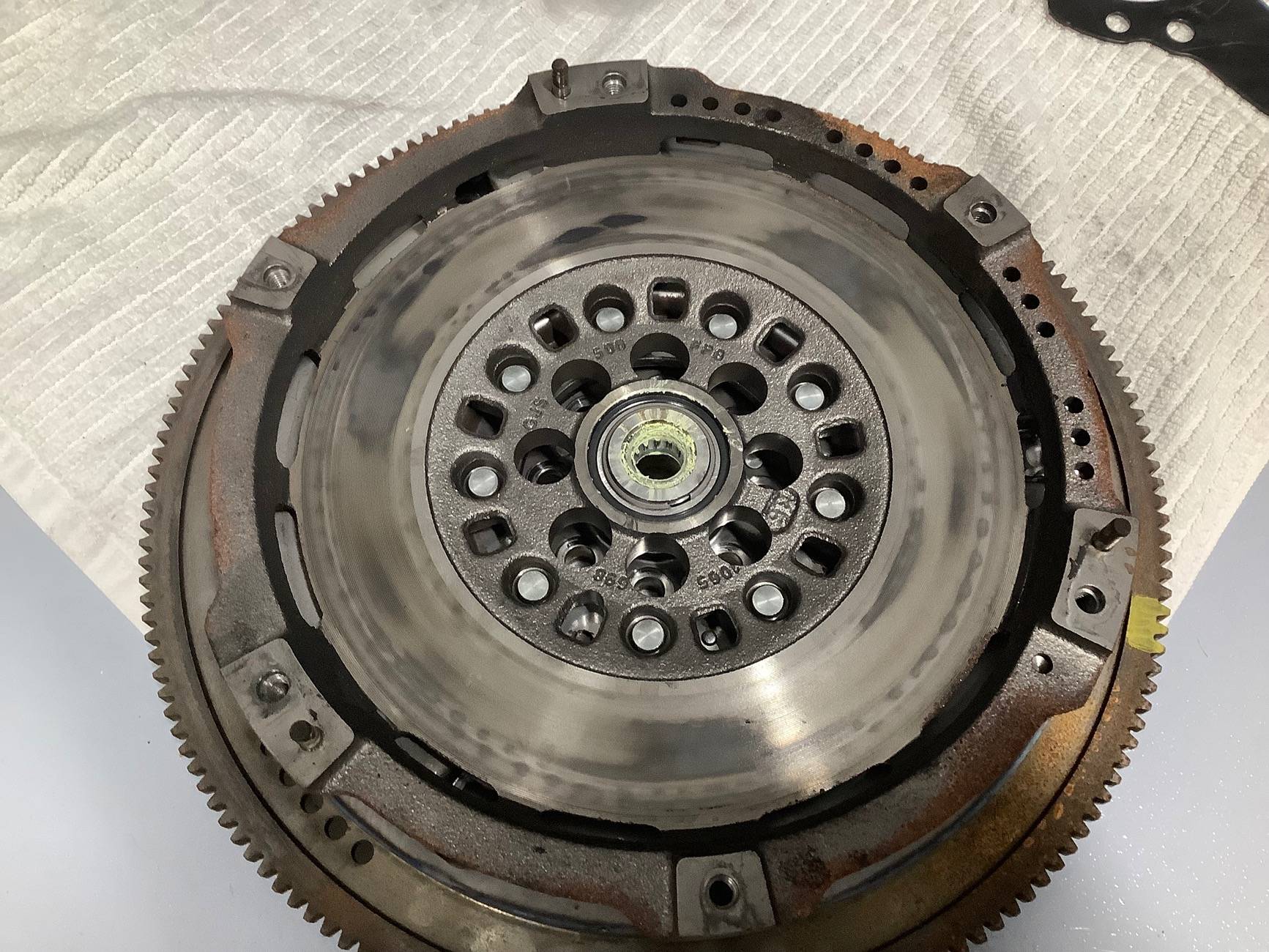

Doing a clutch on my 2018, anyone had to deal with this before?

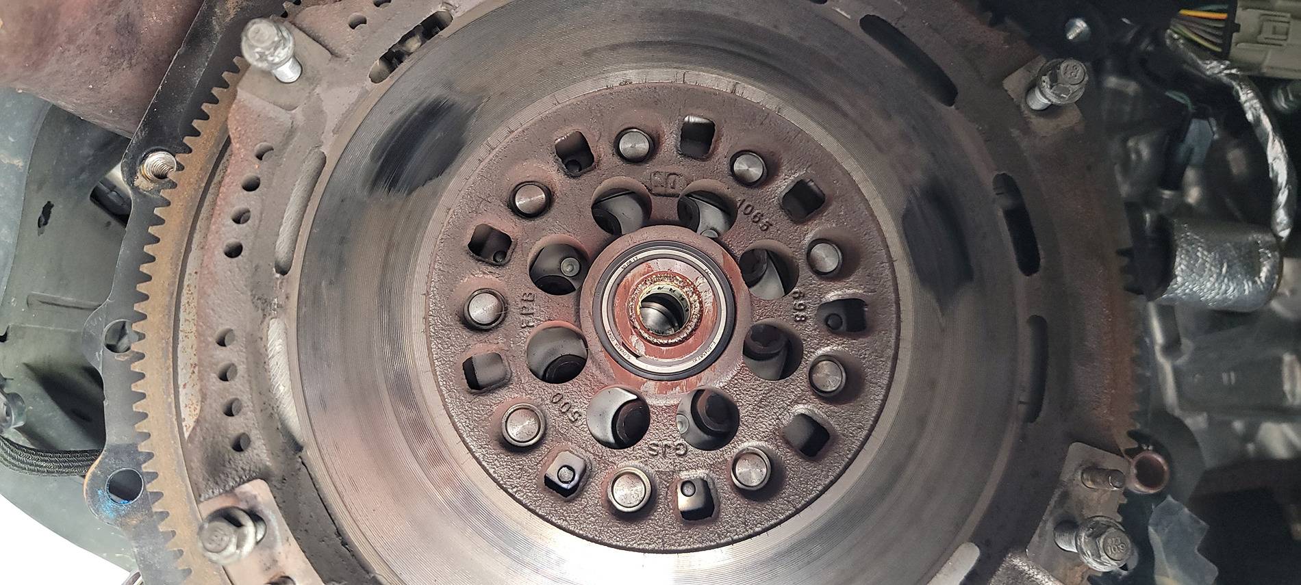

No, the outer plate has shifted and is blocking the flywheel bolts, seems to have failed internally. I have been beating on it and cutting it for hours. Seems to be the only way to proceed

I've seen dual mass flywheel failures before with ford. can you use a prybar to move the inner surface? it shouldn't be ratcheting but idk. maby the springs jammed it up just guessing since I'm baseing it off older ford parts.

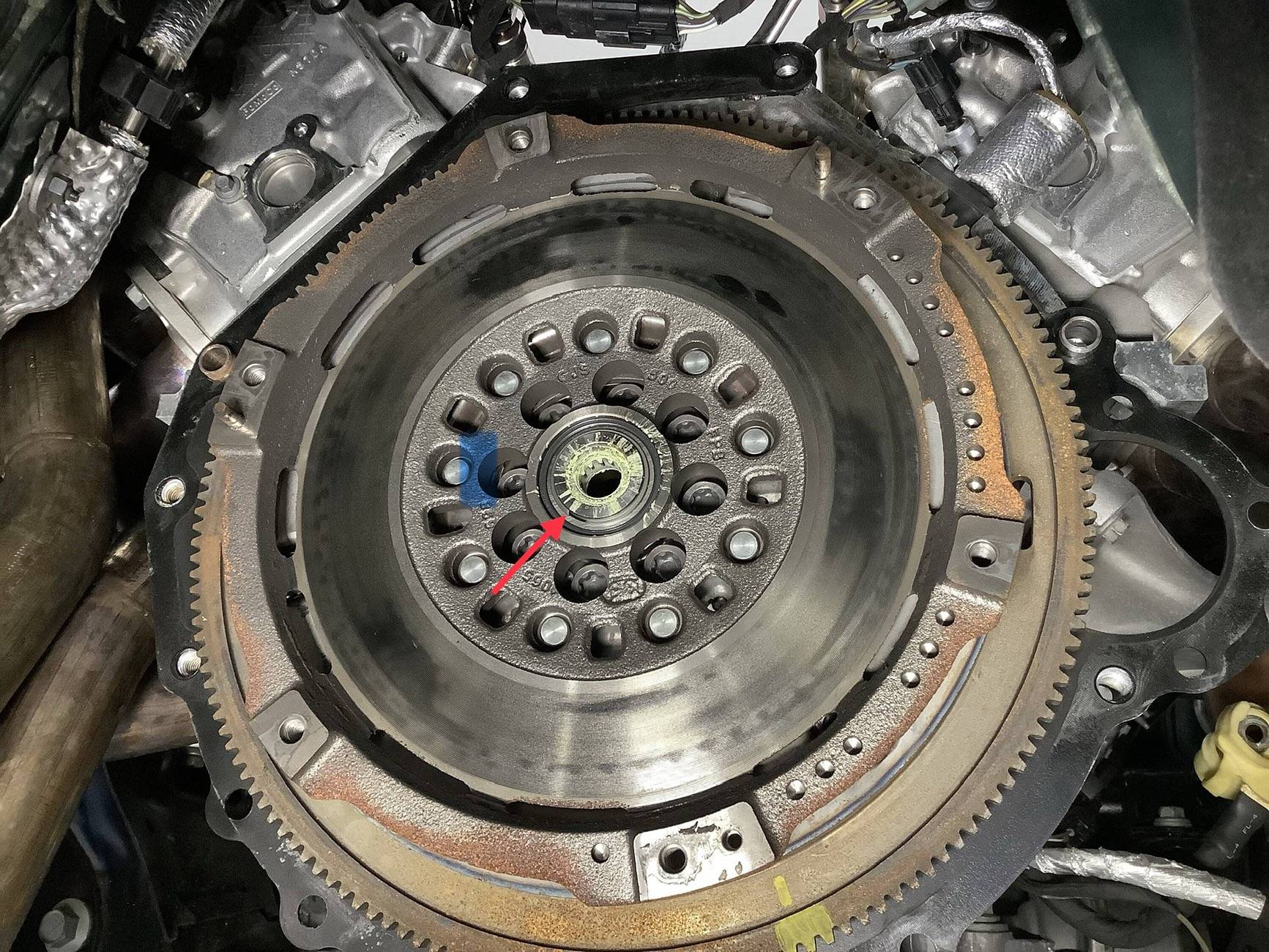

Try removing the circlip identified by the red arrow in this pic and see if that will allow access to the bolts.

I appreciate y'alls help. Tried that, I have also cut the struts around that bearing in an attempt to get enough space to access the bolts. The problem is that the outer plate is riveted (9 silver rivets seen in pic) to the inner. I have also begun drilling those rivets but have absolutely nuked 3 drillbits

You will not be able to drill the rivets out since they are hardened steel and would require a carbide cutting tool bit to remove. It appears that the flywheel has shifted between the two parts, and I believe I can see a crack at the 7-8 o'clock position in your pic that is likely the noise you are hearing. I would suggest using a cut off wheel on a handheld grinder or dremel and cut the bridges out between the holes for the bolts to gain access to remove the bolts. It won't be pretty or easy but will allow you to get the flywheel off the crank. The snap ring mentioned is to remove the pilot bearing from the flywheel with a press or big hammer.

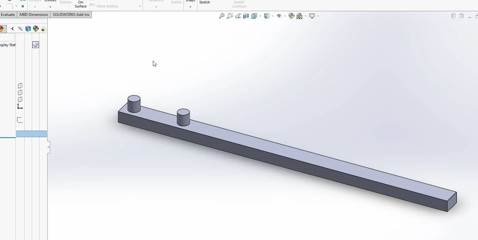

Cool problem! Is it possible/safe to lock the starter ring? Maybe you could make a tool. Like flat bar long enough for leverage and thread 2 fat allen bolts that would span the distance between opposing round holes. Allen head outside diameters should be close (but smaller) than ID of the round holes. Might have to stack a couple of washers to clear the bearing flange and get enough meat in the holes. Like this...
