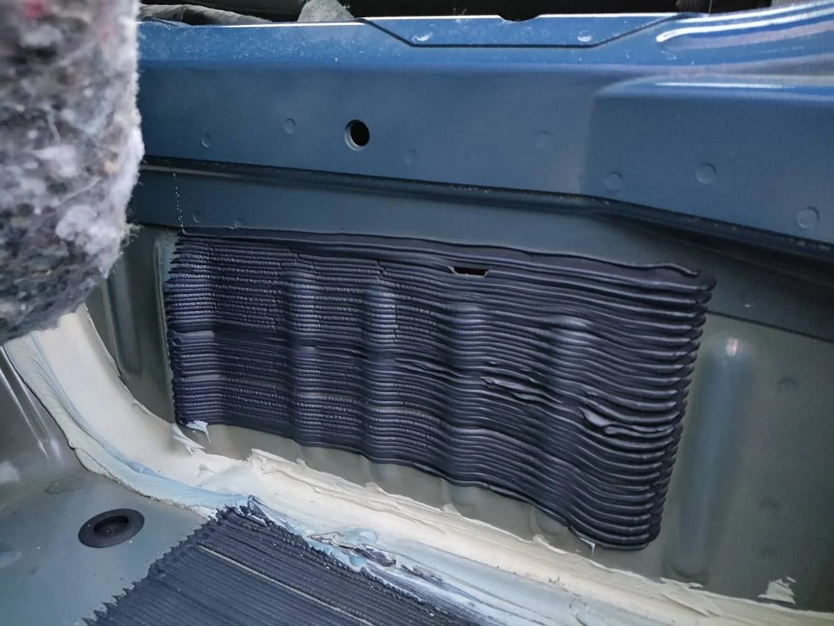

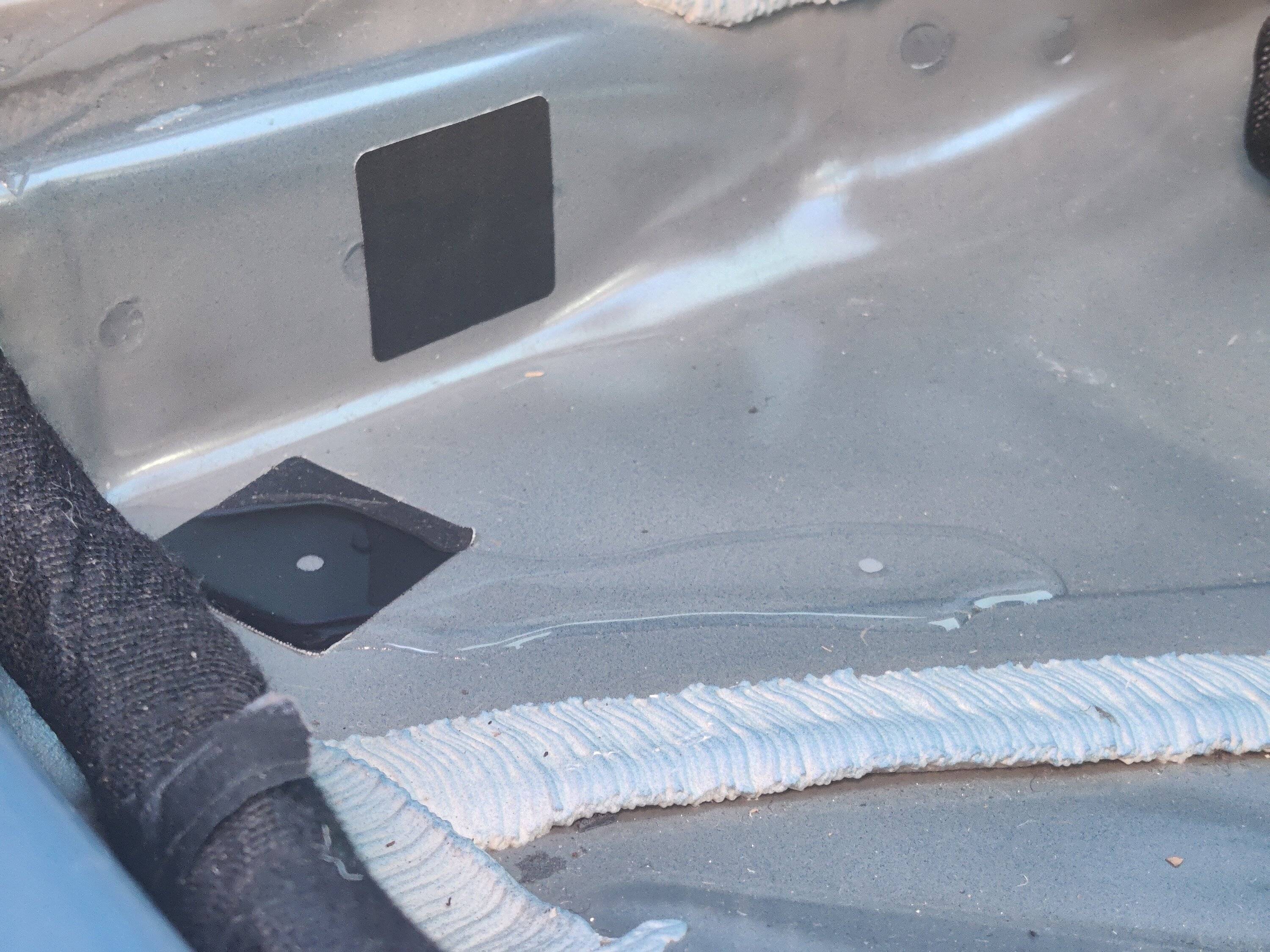

Removed carpet to try and find a leak, and am wondering what these patches cover? One is very brittle and is falling apart, and am not sure its the source. Thanks for any info

Yes, not a patch. It is for sound deadening, applied to the metal to reduce noise.

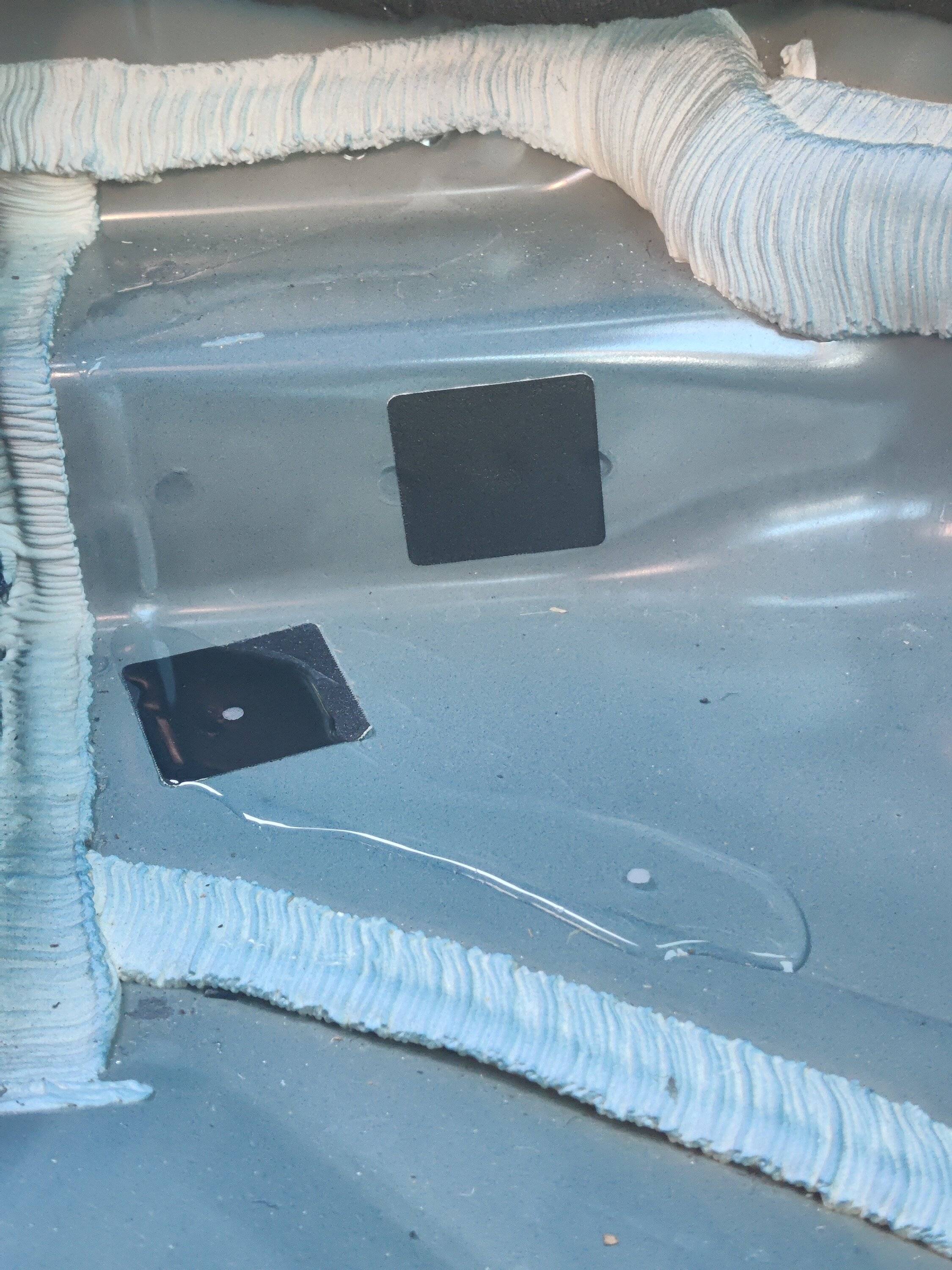

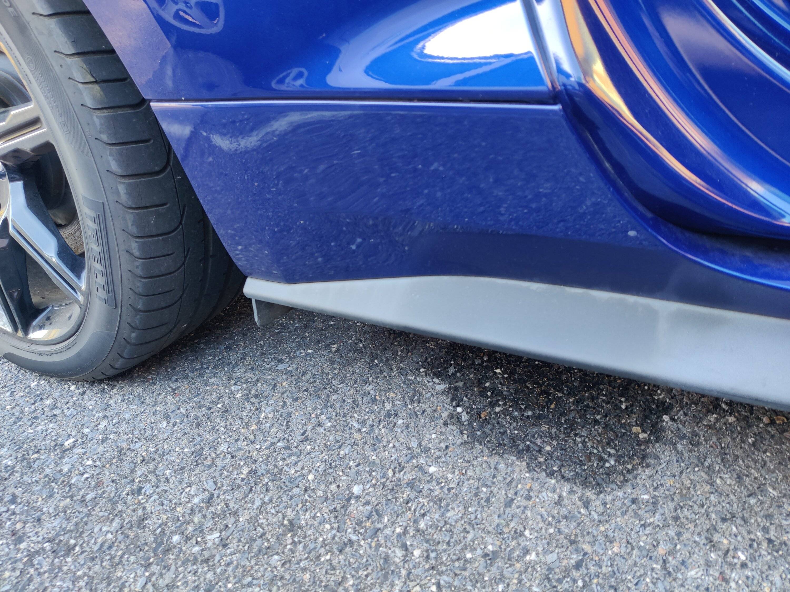

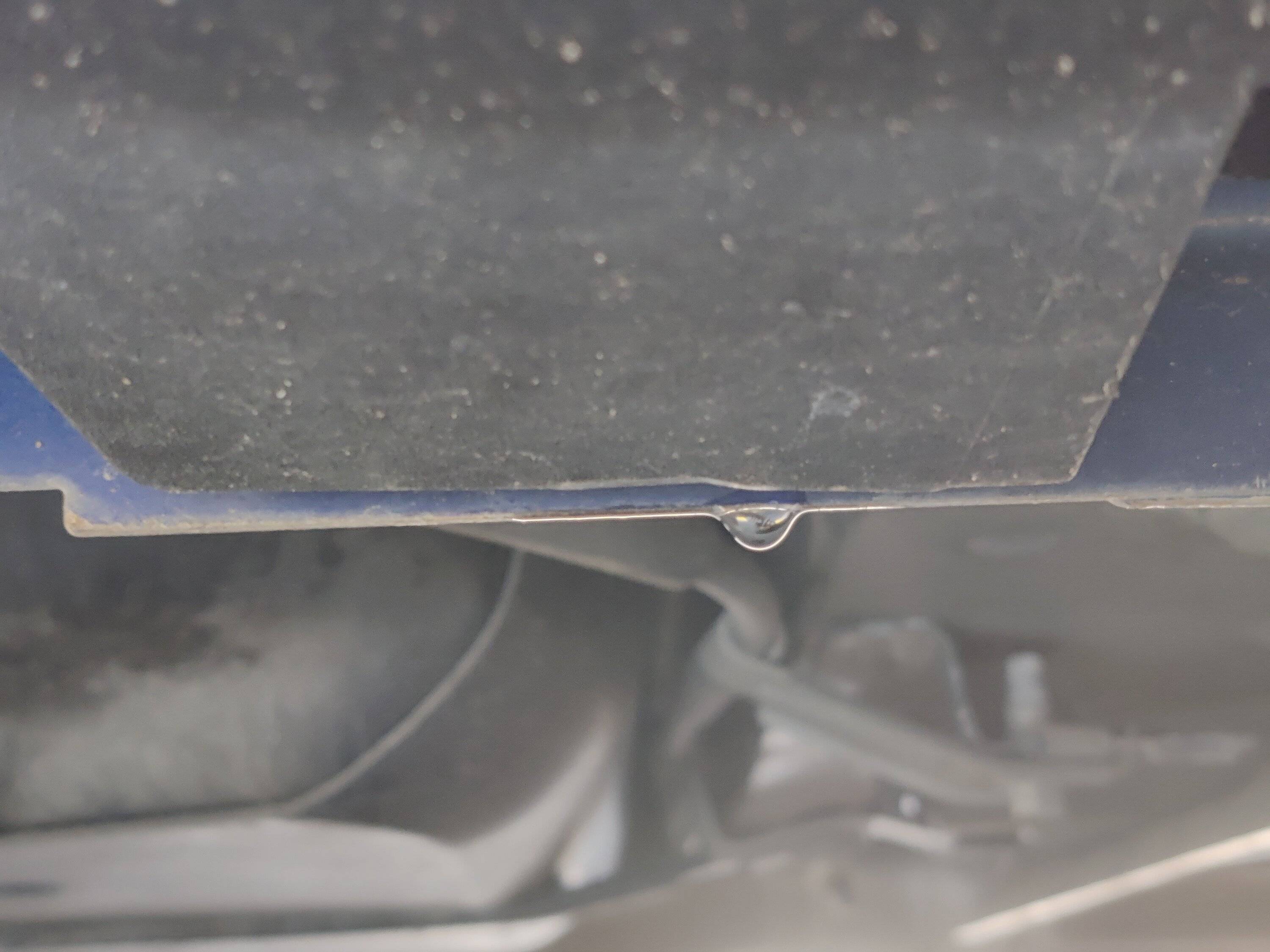

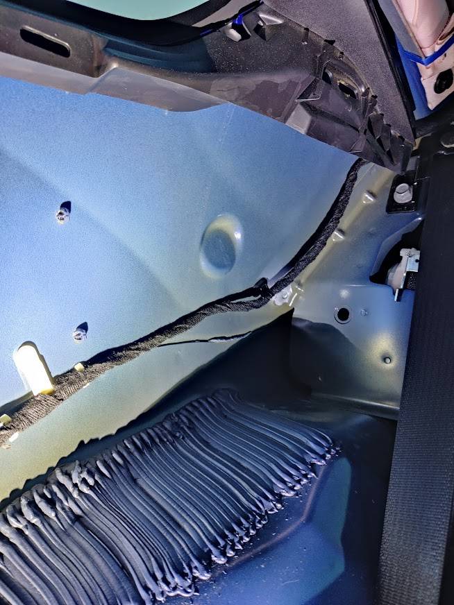

Looks like its coming from the rear. Headliner is bone dry as is the third brake light area. There are no trails leading to this pool of water which baffles me, and there is a pool on the ground right under the fuel pump area

What is directly above the circled area?

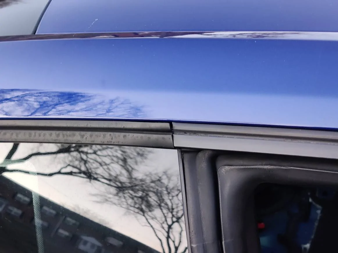

Well I'll be dipped. Went back out with a fresh set of batteries in the flashlight and found the trail. And its right below the window weatherstripping that looks to be loose
