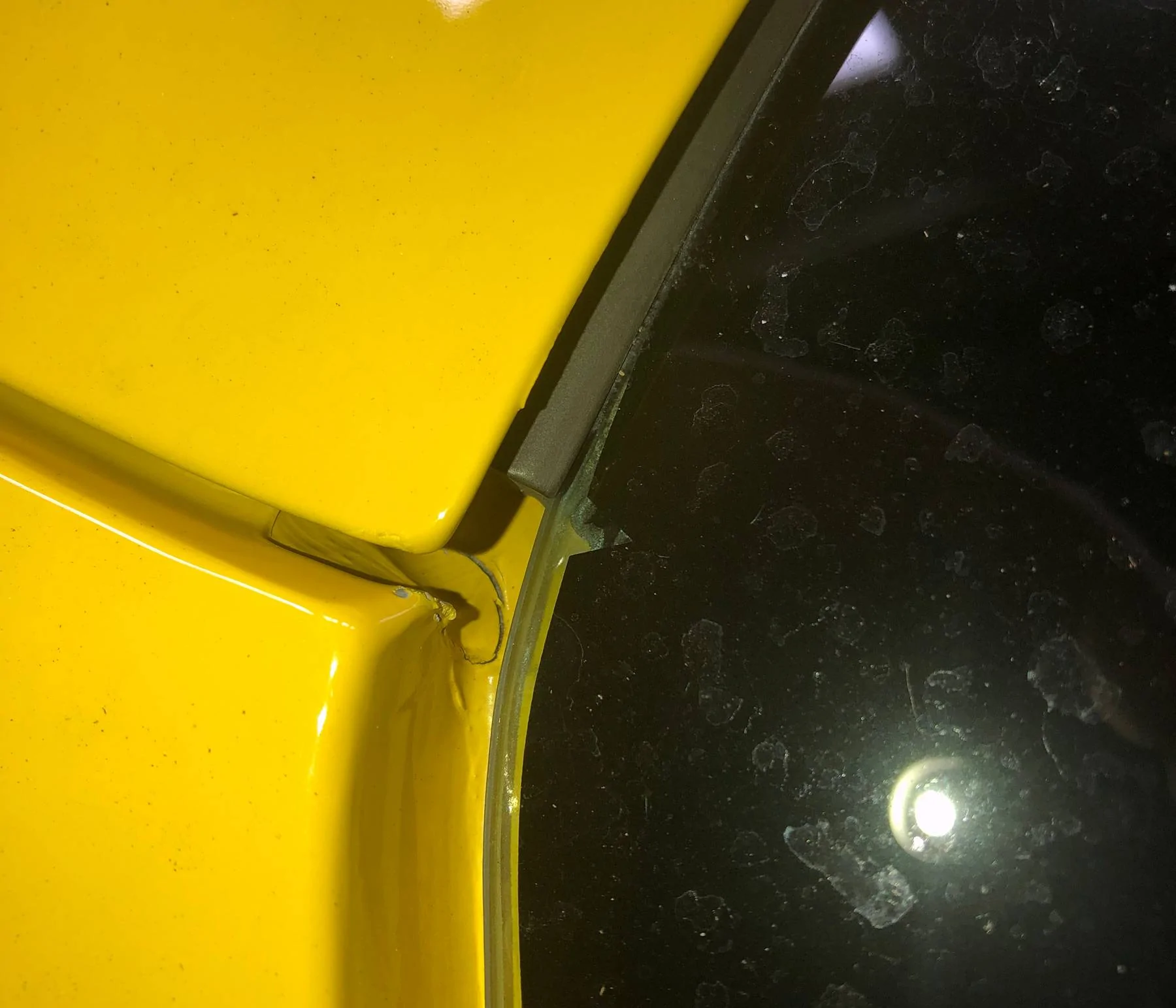

Splitting roof seams near back window, water leaking into rear quarter panels

Also...anyone checking, water won't necessarily be in the spare wheel well. It runs down the c pillars and fill the areas behind the side trunk trim panels.

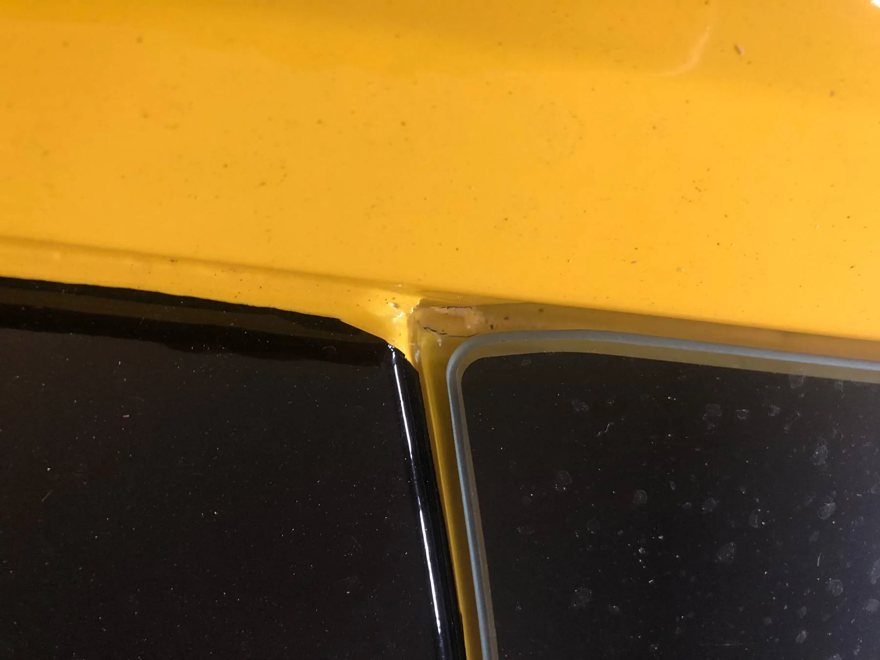

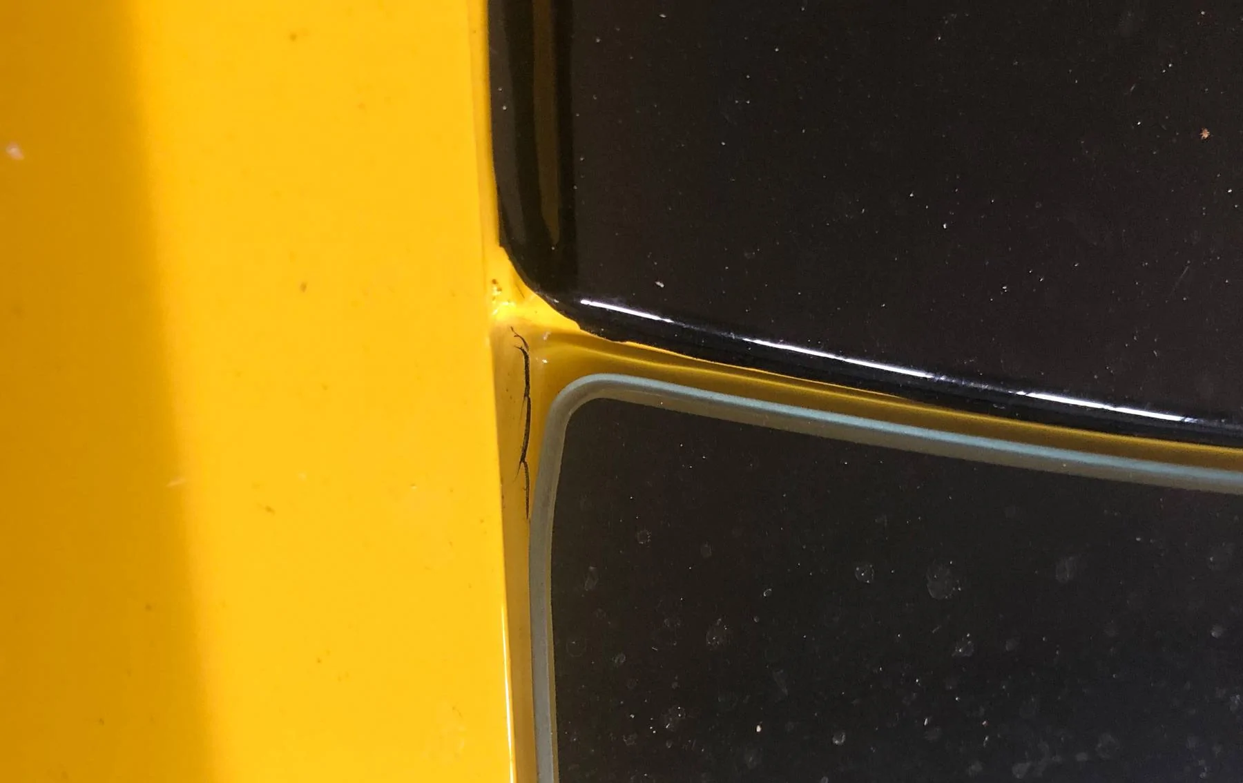

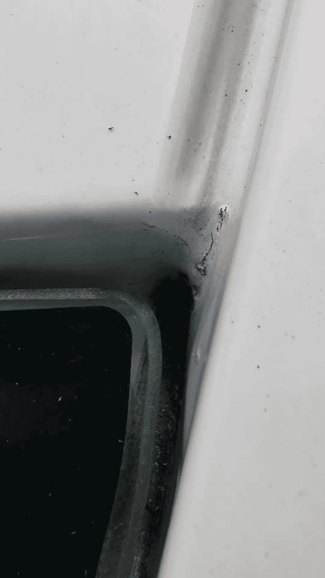

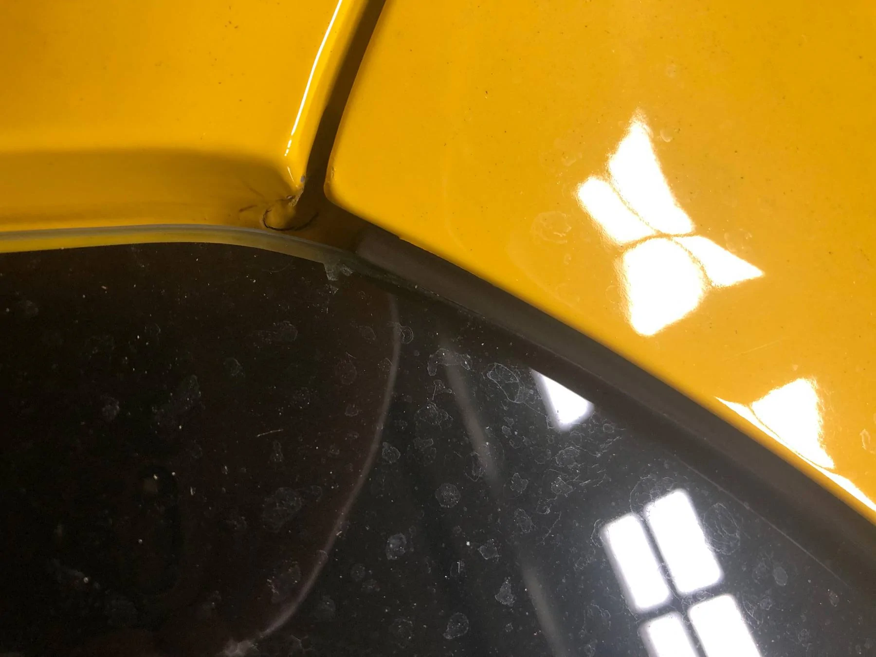

Inspected my 2019 last night and found more cracks in the sealer. My car only has 6000km on it and is parked inside whenever I'm not driving and it doesn't go out in the rain. Can't imagine how these cars hold up parked outside year round with all the freeze thaw cycles. They are likely stress fractures in the sealer. I don't have any water coming in that I can tell but I will be inspecting it closely now.
Guys, check your cars. I'm betting many S550 versions have it to some degree. You will likely not notice it on a white car.
I really want to avoid taking this to the dealer but it looks like this is a problem that gets gradually worse until you have water leaks. By then you may be out of warranty. Not sure what to do about it.

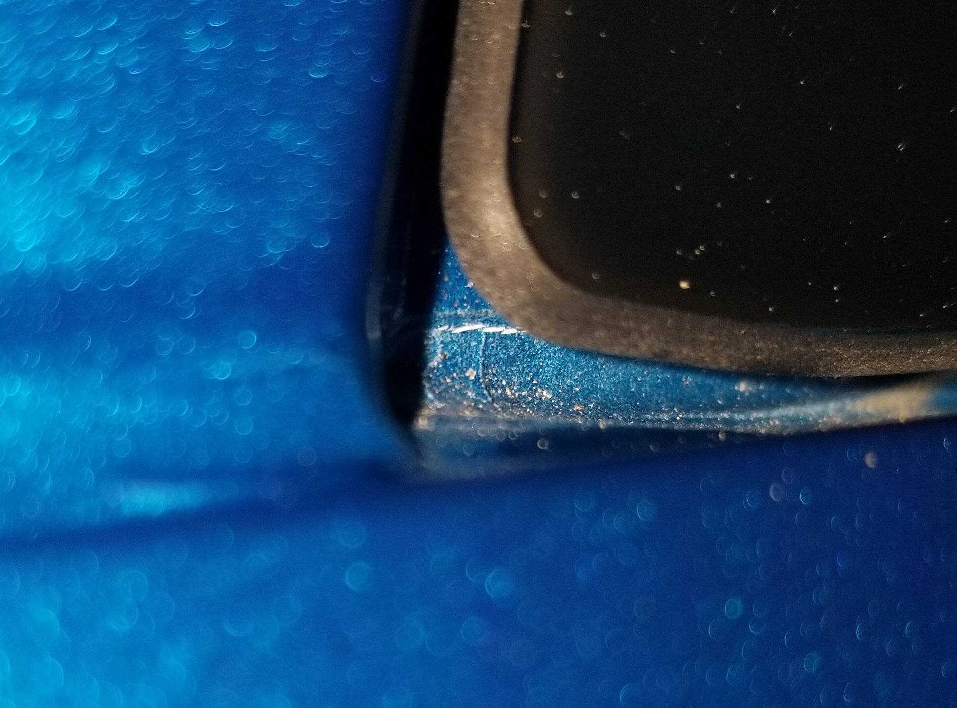

However, what is cracking/separating isn't the seal for/to the glass, but the seam sealant for the body seam. Water is getting in through a seam in the body structure, not between the body & the glass.

This is the white 2017 ecoboost I mentioned earlier. Has split seams like mine and cracking on the painted body surface, outside of the seam sealer. Will get more pics once its cleaned up. Ive seen a gt350 that had this continue up into the drip rail 1/4-1/2 inch on each side on the actual exterior roof surface...well beyond the window gap, actually splitting on the roof of the car.
