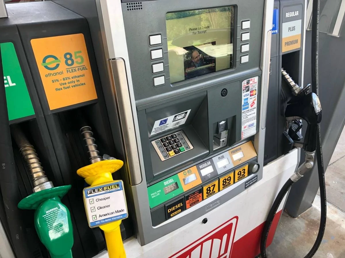

That would be real e85. Unfortunately we are dealing with flex fuel blends here which are usually about e54.

KAM reset, did a quick drive, car was already pretty much warmed up, did about 3-4 miles out and back on A1A, AFR didn't budge.
So I'm assuming if I stay off of WOT and keep the RPM under 4K or so, it's still safe to operate, until I get this sorted out.
I thought I saw a post (can't find it), Mustang board, local folks, saying the Gate E product actually tested pretty high, like more in the 7x area.

Get a tester off Amazon. My local Sunoco tests right at 84/85% every time I test it. My station advertises as E85 even though it says Flex 51/83% on the pump handle.
Yeah, that's the Gate station, it's labeled as E85, but also says Flex and shows that same range on the pump handle).
