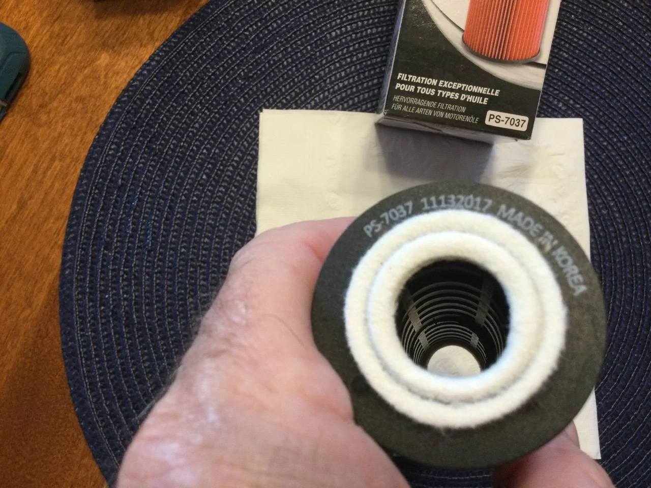

Do both of the K&N have the punched metal sleeve inside?
Thanx
Appears to be a plastic matrix:
The filter feels like a very tough material, not paper. The liner is quite solid as well.

because the filter can collapse from the gt500 oil pump pressure……ive seen it happen on a gt350…..thats why they updated it to the 2087 for them also

I thought it collapsed from improper installation

Ive read both reasons. Who knows.
I have no doubt the K&N would suffice, and maybe even surpass the motorcraft. The stiffer filter media would make the need for metal core less, so plastic would probably work. My only concern is the clause about the 2087 being required else the warranty be void. That’s said, I’d put a k&n if I couldn’t find a 2087, and if something happened, let a judge sort it out. I know, big words, but they can’t require that, and require changes every x often and not have them available without an alternative

Have never heard of a collapsed oil filter. Just those crushed due to improper installation.

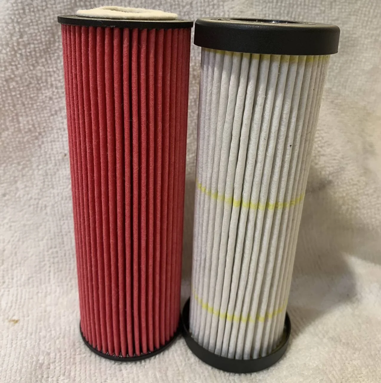

Just compared an FL-2087 and the K&N PS-7037.
The FL-2087 is close to 3.15mm or 1/8 in shorter.
I have a new FL-2087 that will get me into next year and hopefully Ford will be back in stock.

Interesting. They look exactly the same size to me:

I would also be curious about the flow characteristics of the K&N if the material feels more coarse or thicker. I’ve used them on other vehicles because they make a good product but I wonder about cold start 50w getting through it and to where it needs to be.

It has more fabric length (height in the pix) and appears to have more pleats. Each pleat seems thinner than the thick paper style of the Motorcraft filter.
I haven’t seen any flow data for either filter. But K&N’s are known for their higher flow rates which is why I use them.
