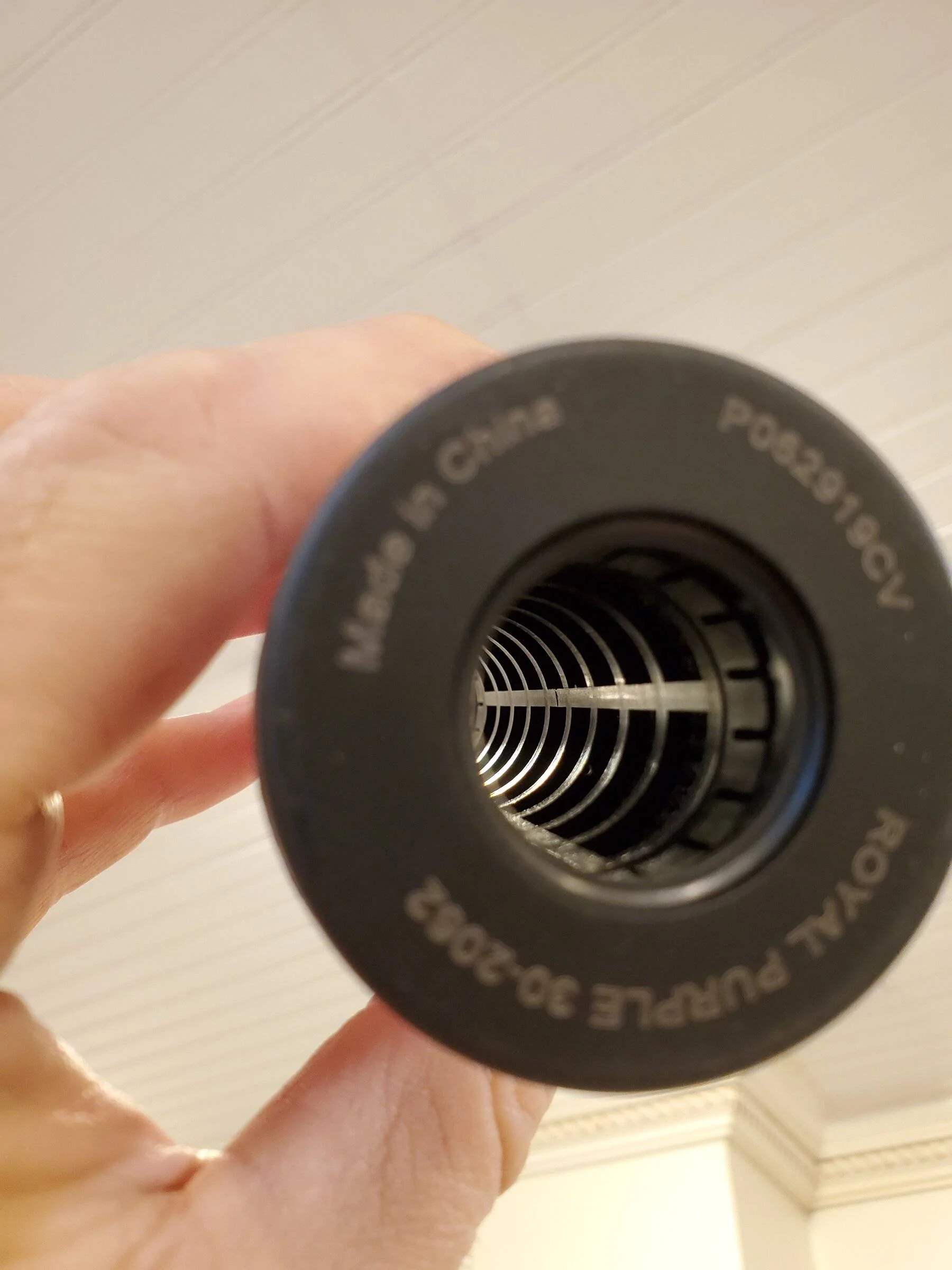

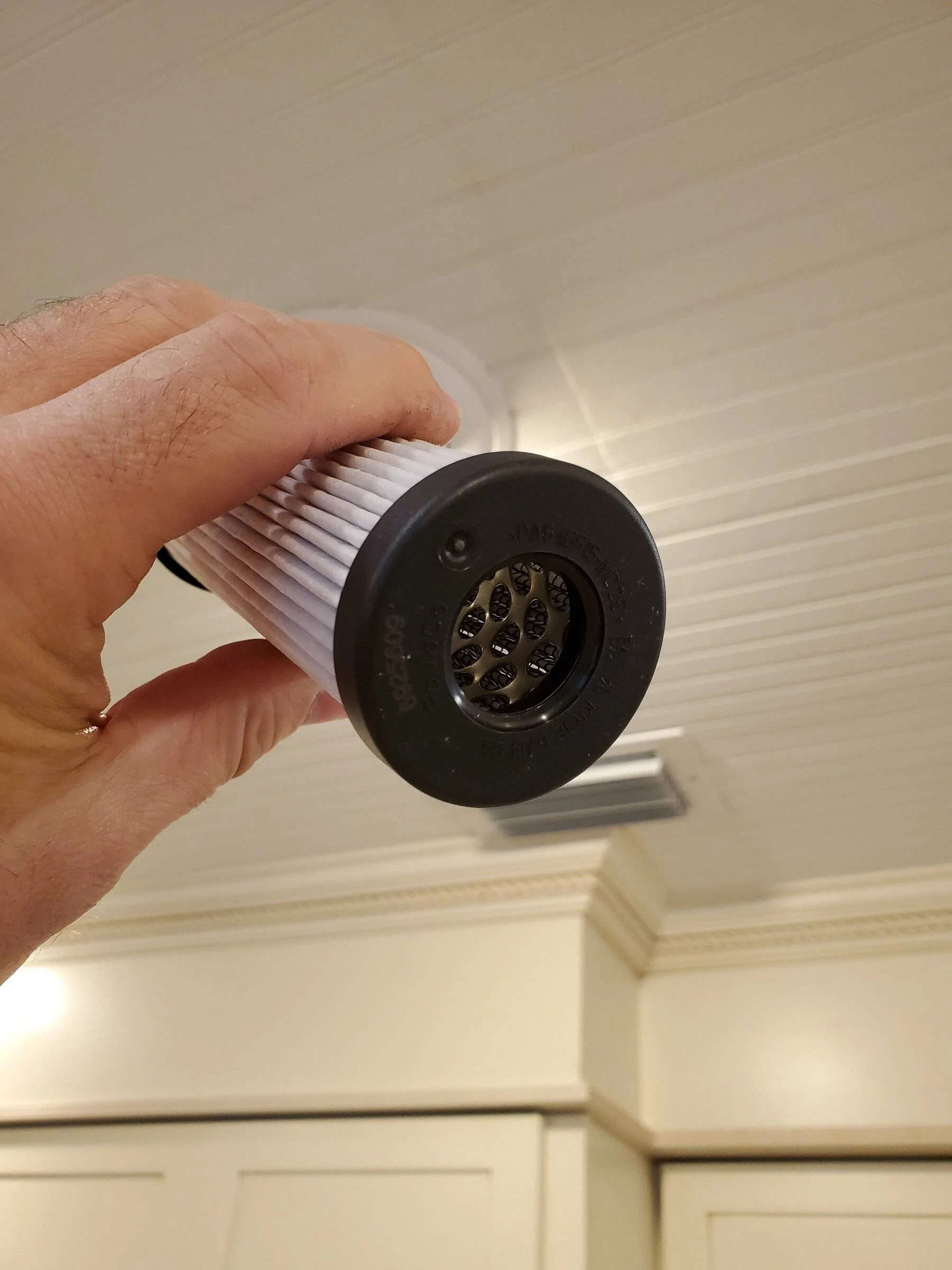

A preliminary analysis from the photo.....someone who works at O'Reilly Auto parts and owns a GT500 just posted this on FB and says that it has a metal inner brace. AFAIK, the only other metal inner brace is the OEM FL-2087. he also put a magnet inside and it stuck to the inner brace. and the filter is only $16.99...
So maybe good news. I work at Orielly and was needing an oil filter like many of you for my GT500. Fords was special order and we couldn’t get one, same with the dealerships. I check constantly to see if we carry a new one and today I saw royal purple made one. I ordered just to see if it would work and I believe it will. When I compared the GT350 to 500 filter, only difference I saw was the inner tube or brace was metal on the 500. I’m guessing this is because more pressure due to it being supercharged but I could be wrong. When I inspected the royal purple, it is also metal tubing or brace. So yeah I believe this will work guys
ok we'll wait to hear what you say once it's in your hands. i thot the funniest part of the FB comments on this post was one guy asking, "i just wanna know how a guy who works at OReillys drives a GT500..." lolA preliminary analysis from the photo.....
It looks like there is a steel sleeve in there on the inside of the plastic reinforcement. I don't see why this wouldn't be a suitable alternative.
Thanks for sharing. I bought 3just passing along info guys, the guy said it's metal. he said a magnet stuck to it. i dont think magnets stick to plastic...just the messenger.

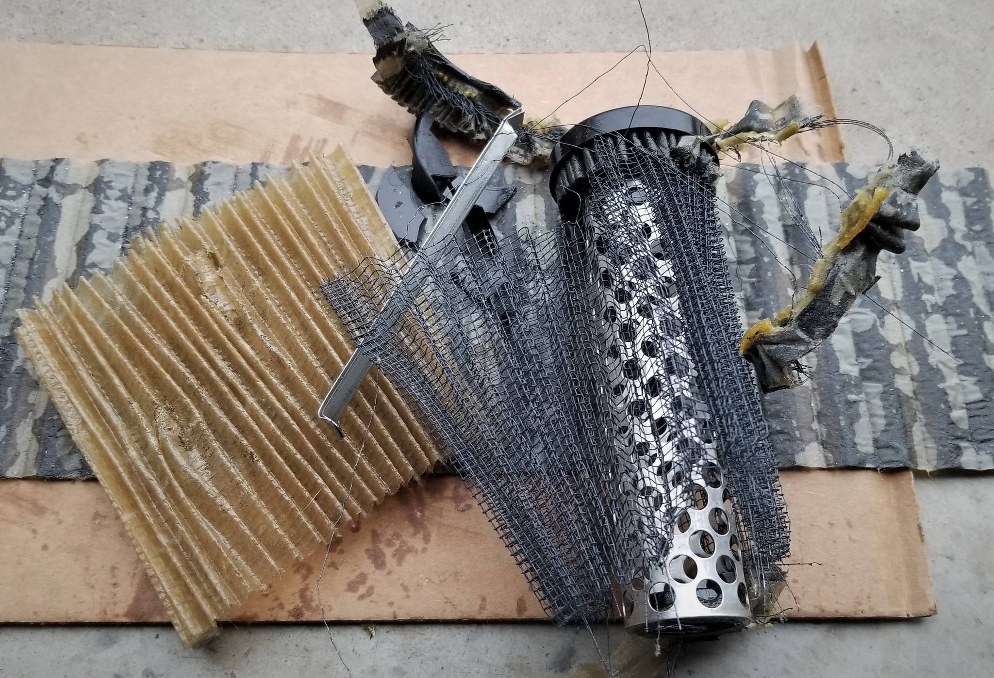

Every time I hear somebody use a magnet analogy I get uncomfortable (ie, stainless versus non-stainless, etc). The issue is, at least as far as the factory filter is concerned is, there are other components to the filter assembly that can attract a magnet. The filter media seam is pinched together with a steel insert and the media has screening on the inside too.just passing along info guys, the guy said it's metal. he said a magnet stuck to it. i dont think magnets stick to plastic...just the messenger.
Yea, I will do a teardown on it. from the photo it appears to me that it has the plastic reinforced ribs like the 2062, but also another metal reinforcement tube inserted inside the filter. I don't think I'll do a video, but simply a step by step of the teardown and observations along the way.Every time I hear somebody use a magnet analogy I get uncomfortable (ie, stainless versus non-stainless, etc). The issue is, at least as far as the factory filter is concerned is, there are other components to the filter assembly that can attract a magnet. The filter media seam is pinched together with a steel insert and the media has screening on the inside too.
That RP filter looks like it has plastic reinforcement to me and I look forward to being wrong.
