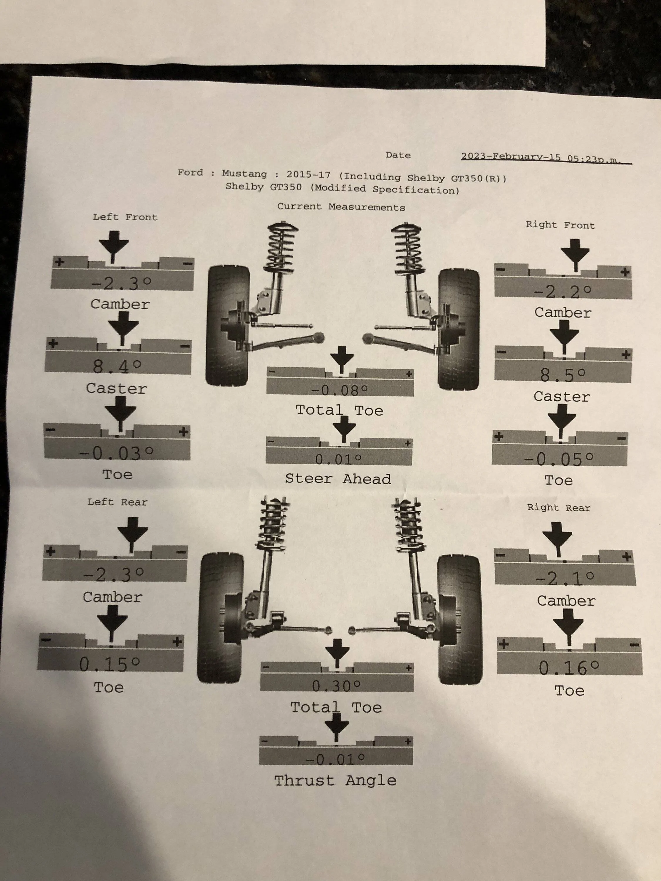

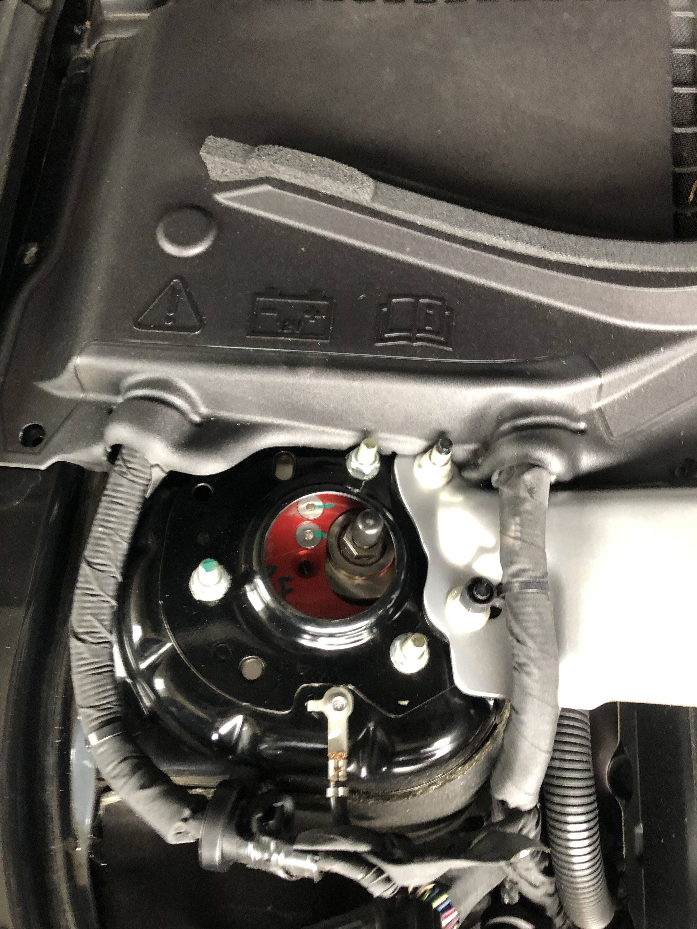

Just picked up the 350 from the shop! Below is what they were able to do, top of towers were cut and the tech applied touch up paint which was great.
Seems to fall in line with what y'all were saying. She could only get -2.3 and -2.2. You can see on the right front, it is touching the tower. She stated its typical with the 350s to have a misaligned subframe from the factory, as to why there is inconsistency when comparing left to right.
She stated the Vorshlag came with an additional adjustment for caster, as it now sits at 8.5 degrees and recommended it for the back straight at Road Atlanta. Based on my research, I see the 350 may not really benefit from this as the stock 6.81 is good enough. I hope it doesn't have detrimental effects.
Will the -.08 total Toe kill the fronts?

You lost some camber by moving the caster up.
You can get more camber with crash bolts.
