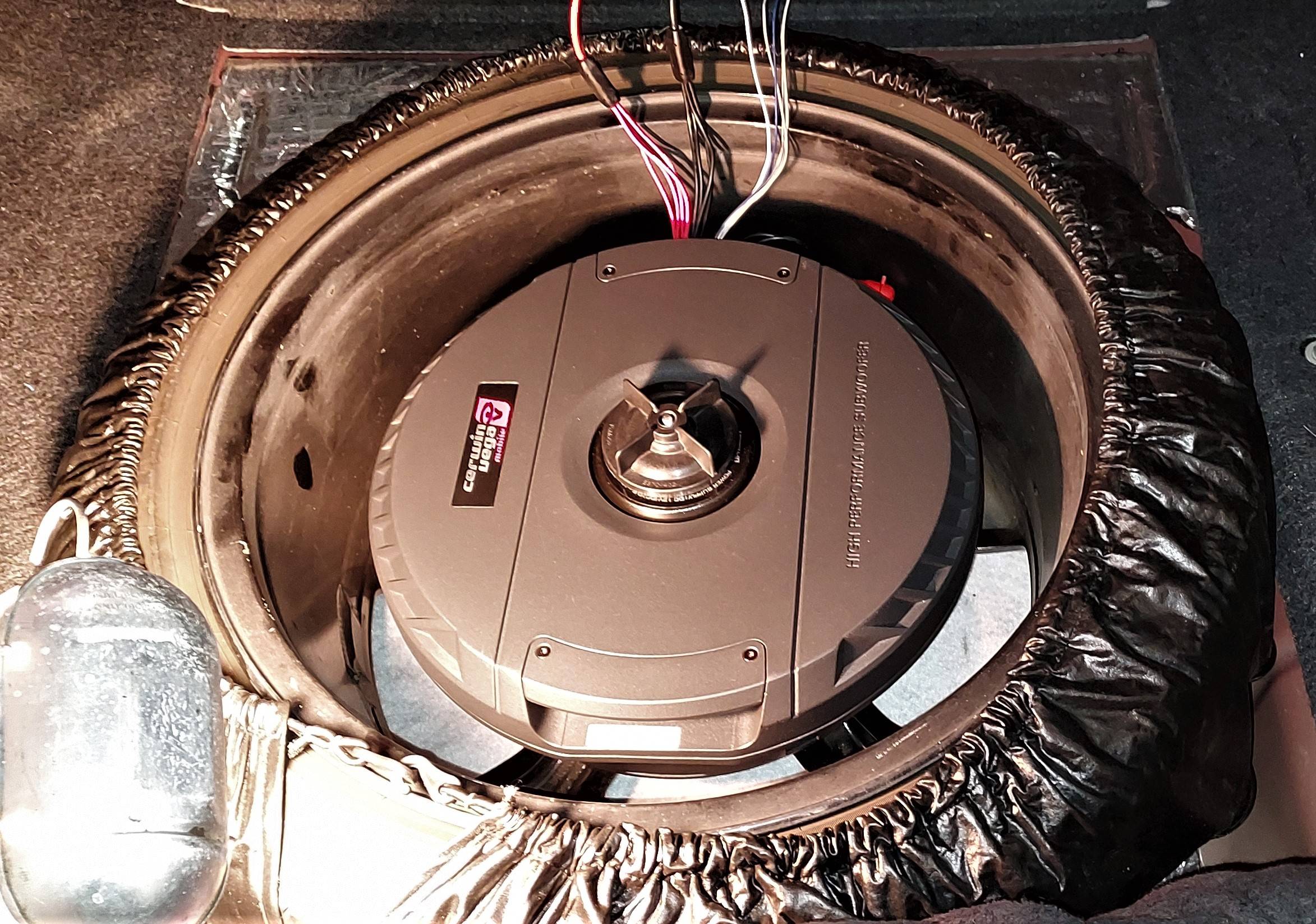

Mount a spare tire style subwoofer in the trunk, used a Rockville audio one in mine and it worked great, tapped into the rear speaker wires and ran a power cable from the battery, turns off and on with the ignition and has a cable mounted adjustment control to fine tune. About $200 all in, used Forscan to update the EQ signal, pleased with the result.
This might work. I need a spare that will fit over the Brembo brakes. I have a pump in the well know

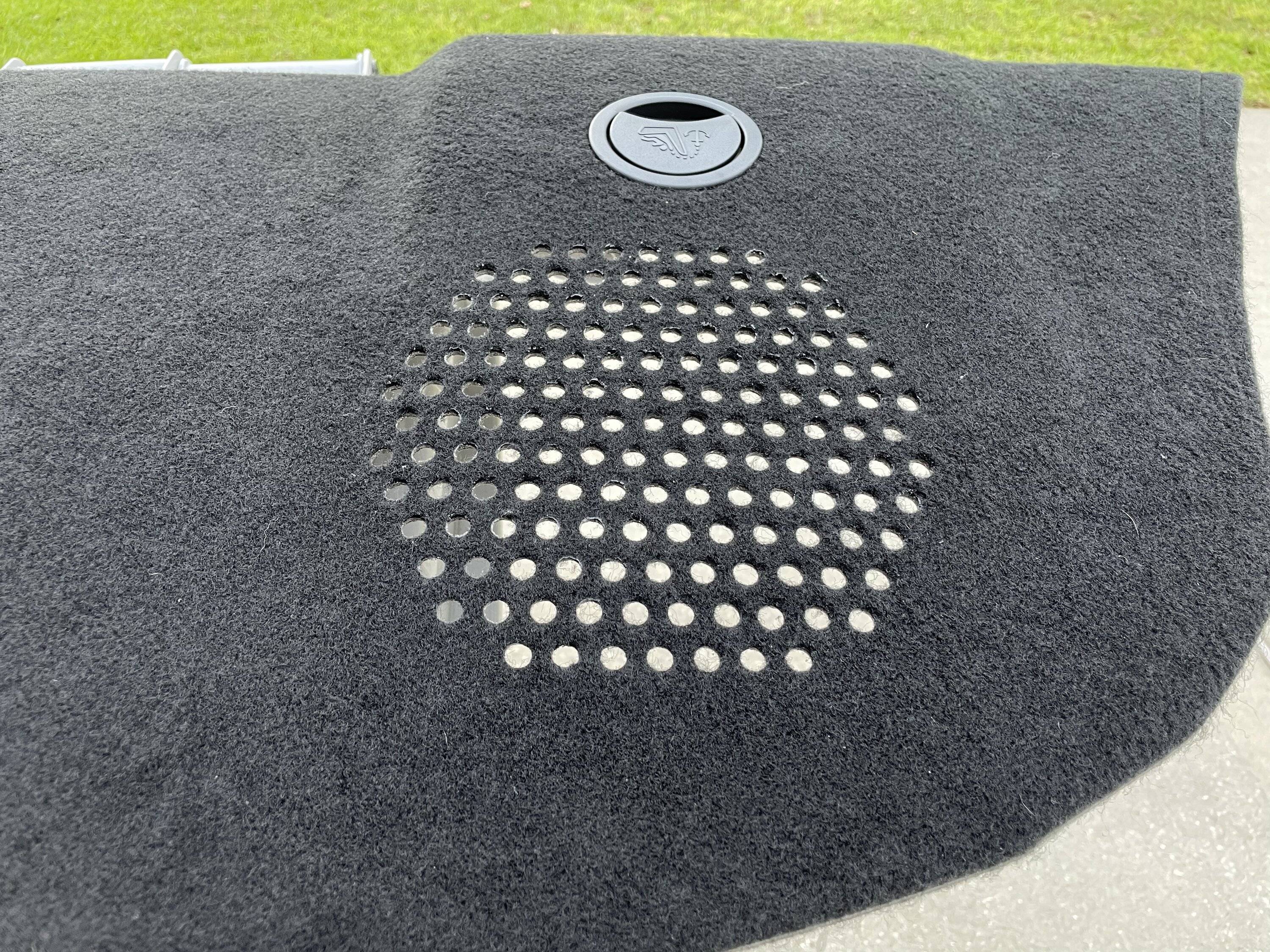

On a slightly different note but still the same page, has anyone found a good replacement speaker for the back panels?
Any 6.5 will do including coaxials. But, the rear package tray panel chokes off the sound. You can punch the vent holes out of the carpet like I did and it’ll allow more sound into the cabin but the speakers are set up in an infinite-baffle so you won’t get very good response from them no matter that woofer you use.
