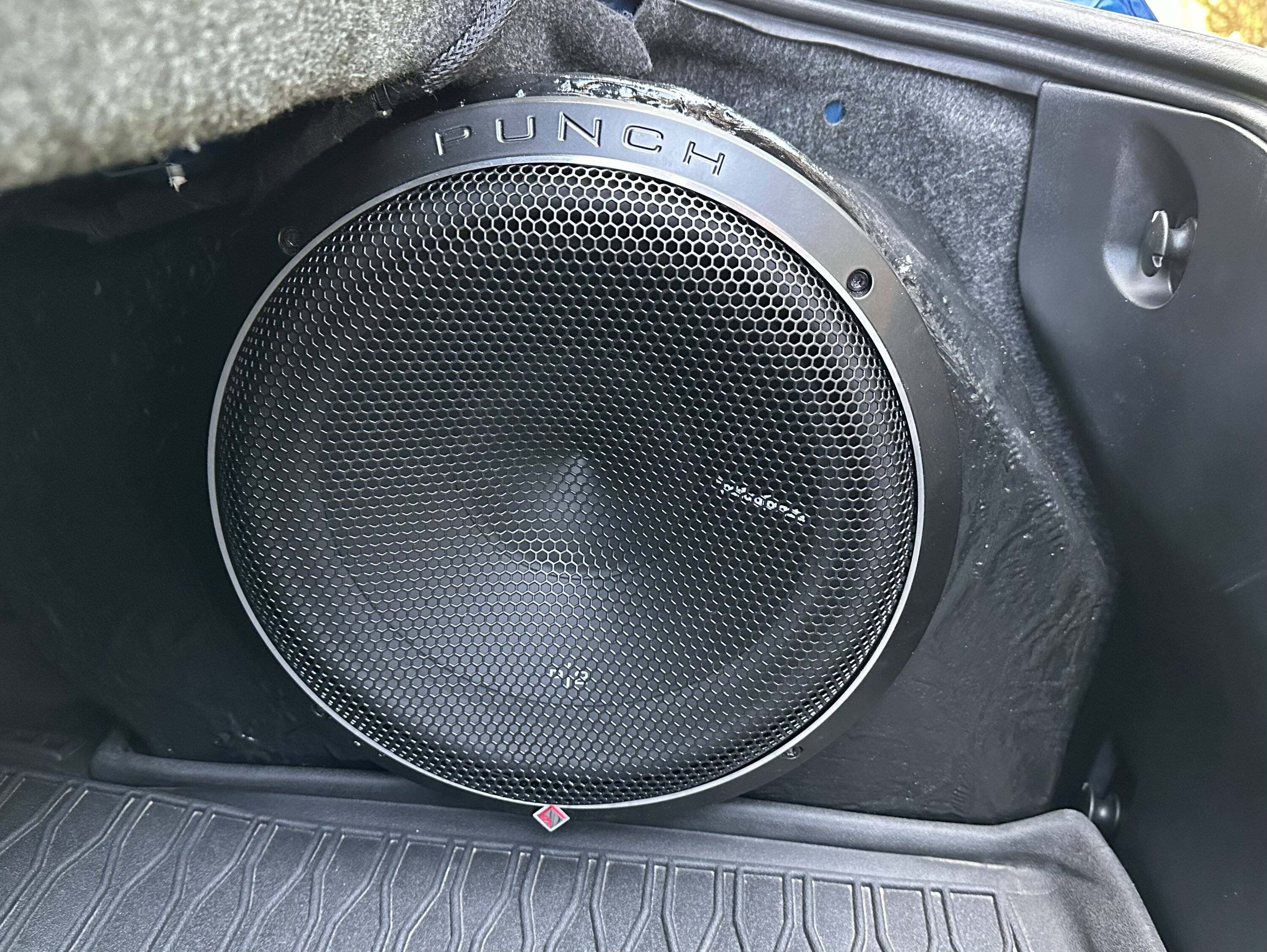

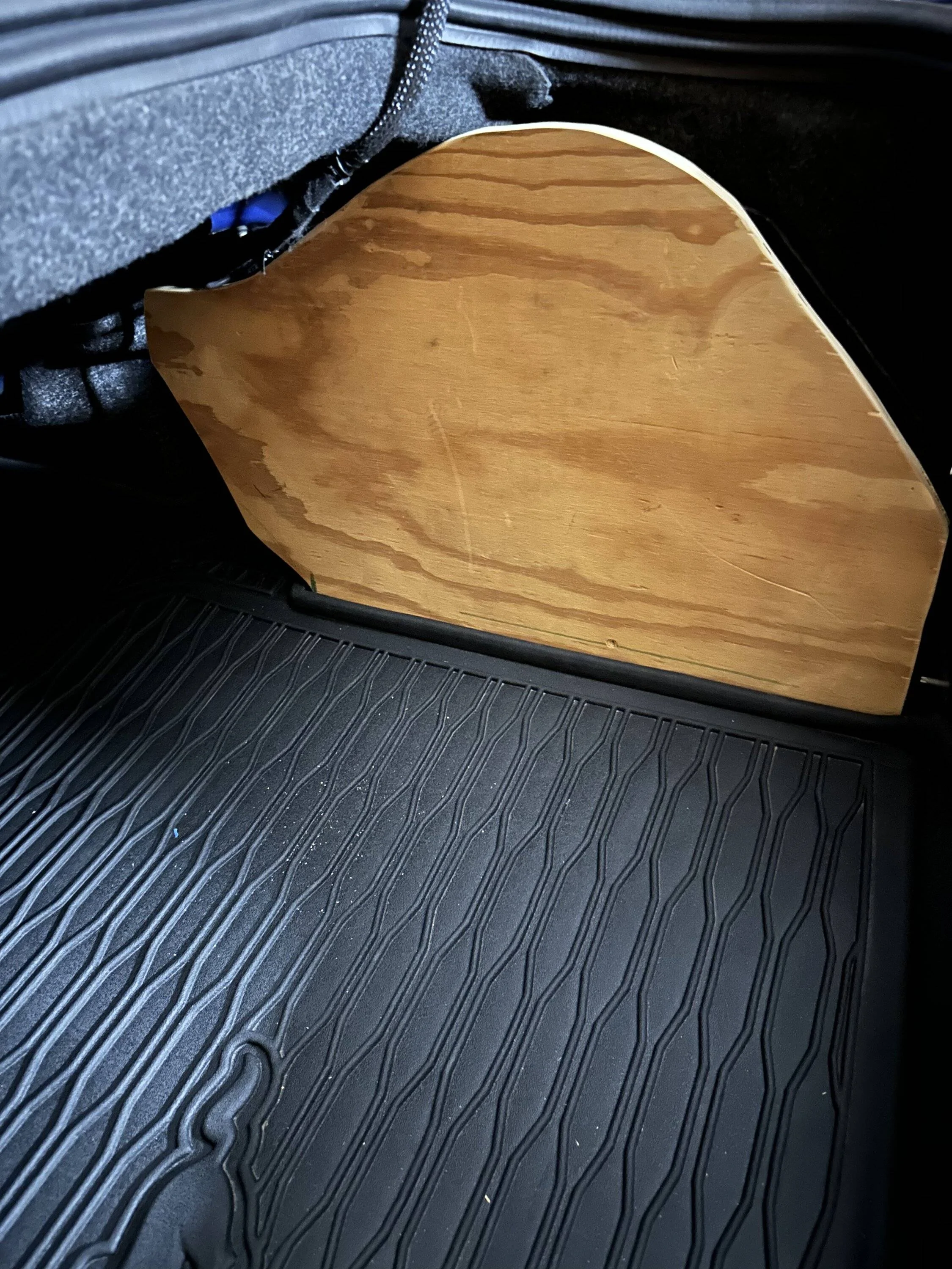

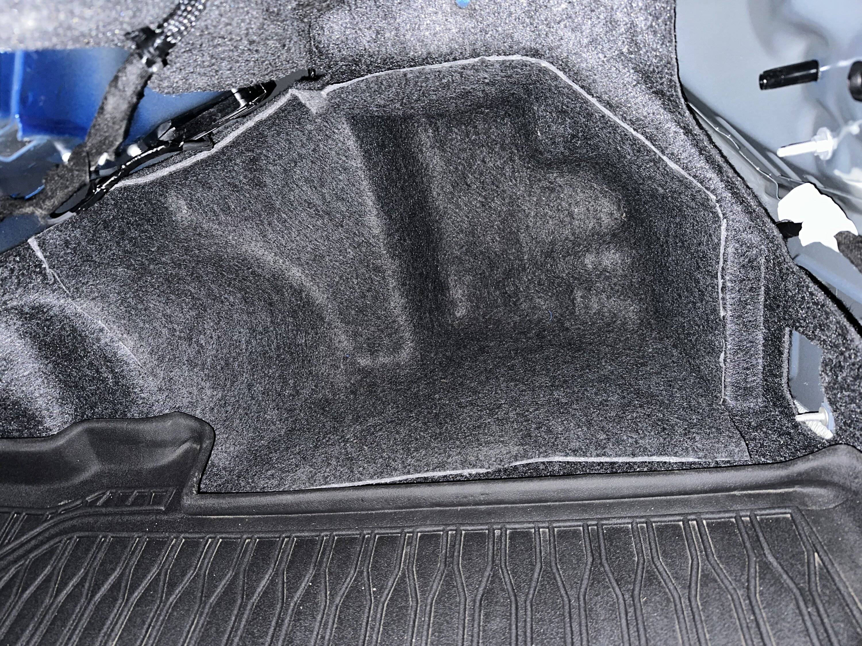

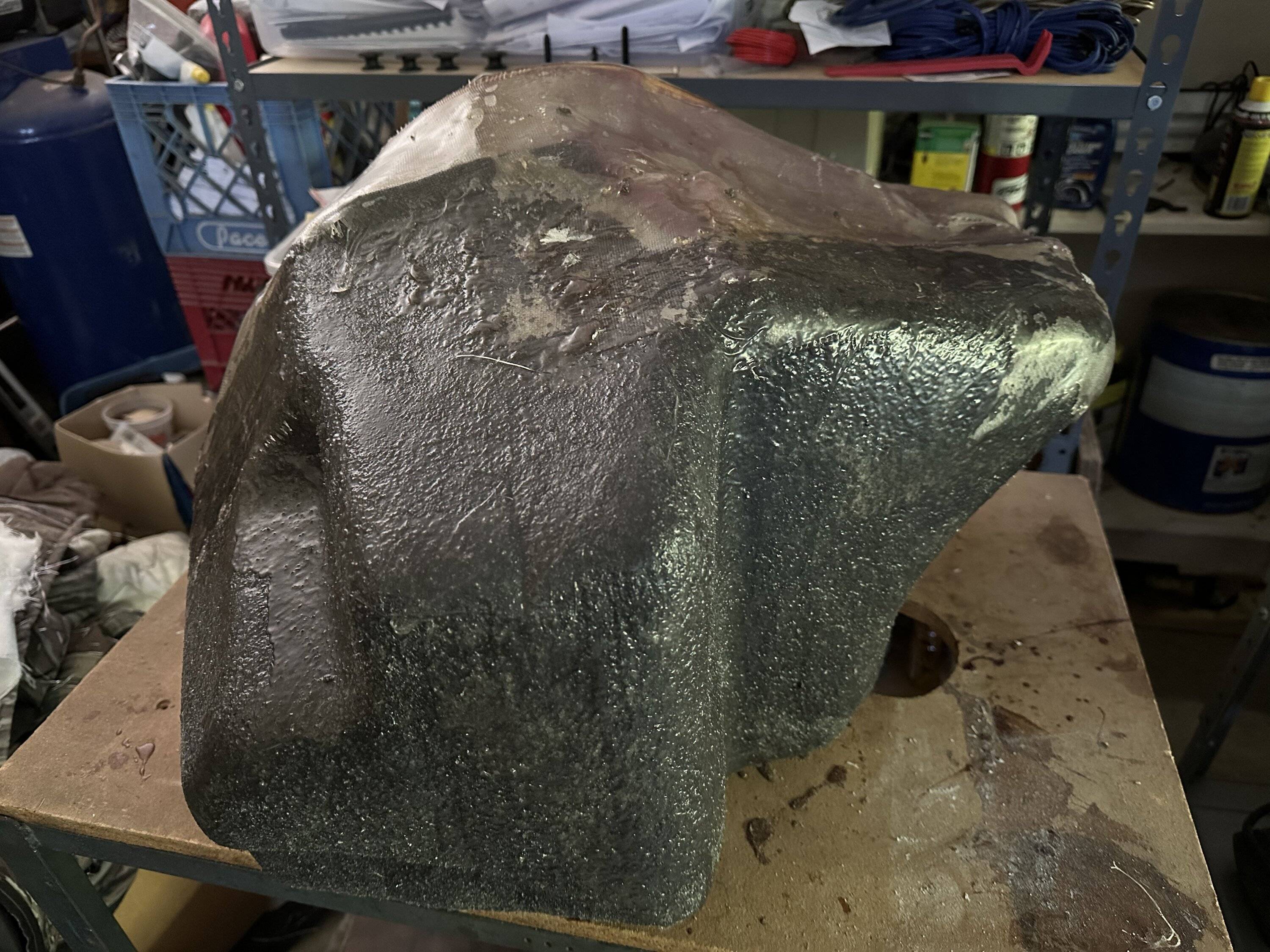

My trunk carries a full sized spare, so the box taking up some space at the front of the trunk, isn't a deal breaker to me.Those foam cups choke off the low and midrange response. You might need to play around with the sizing if you box them in. I was conversing with another GT500 owner who did something similar but the frequency response was pretty bad and a speaker box for the rears protrudes down into the trunk space eating up a lot of the usable area.
