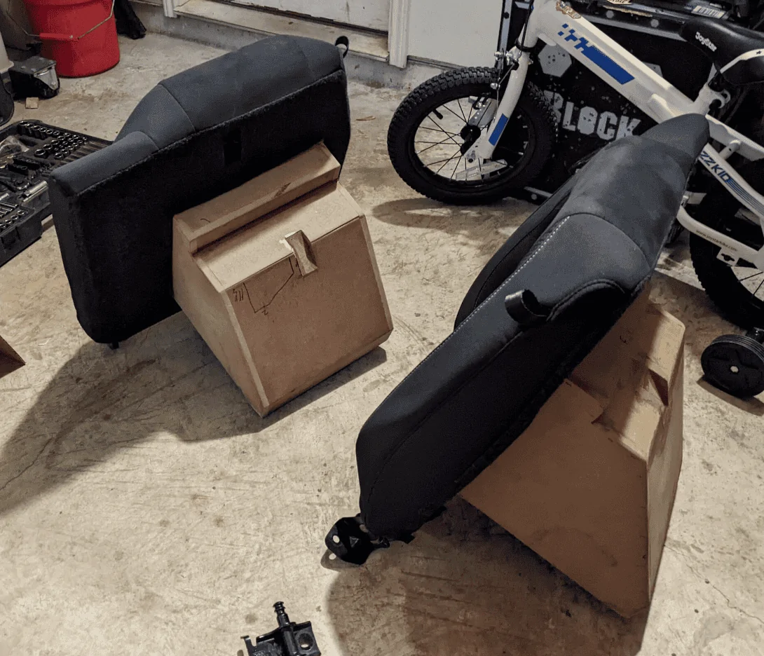

If the coupe seats are the same as the vert, I'll sell you some really nice subs built into the back seats. Here is the only photo of them I have, in my build thread (Which has not been updated in ages LOL)
If you are interested, I can pull one apart tonight and determine what kind of sub is in there/send photos. I will tell you, the stereo set up was winning competitions for the previous owner.

I don't think they are the same

This won't fit as the vert have a molded storage cavity for the top directly behind the rear seats.

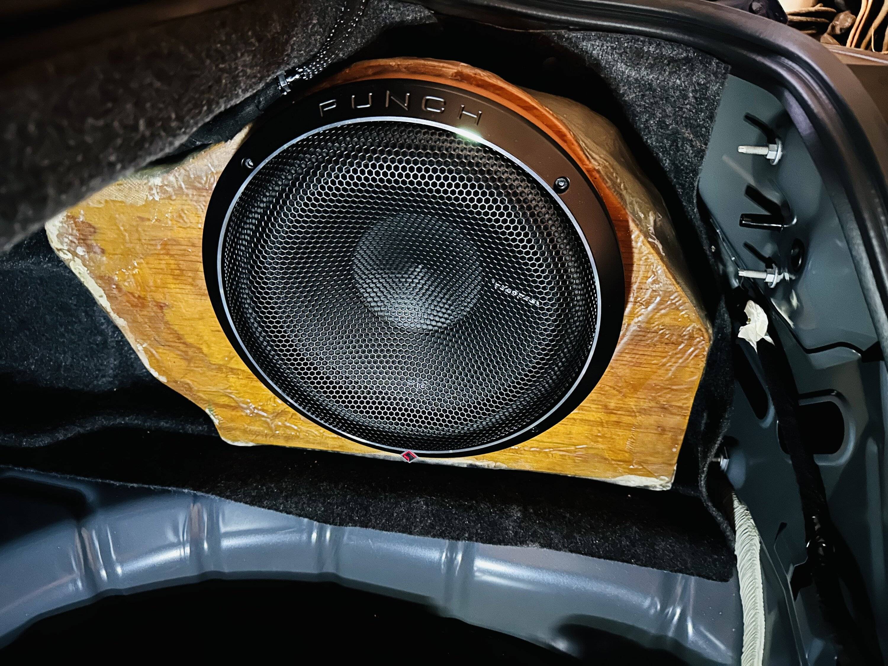

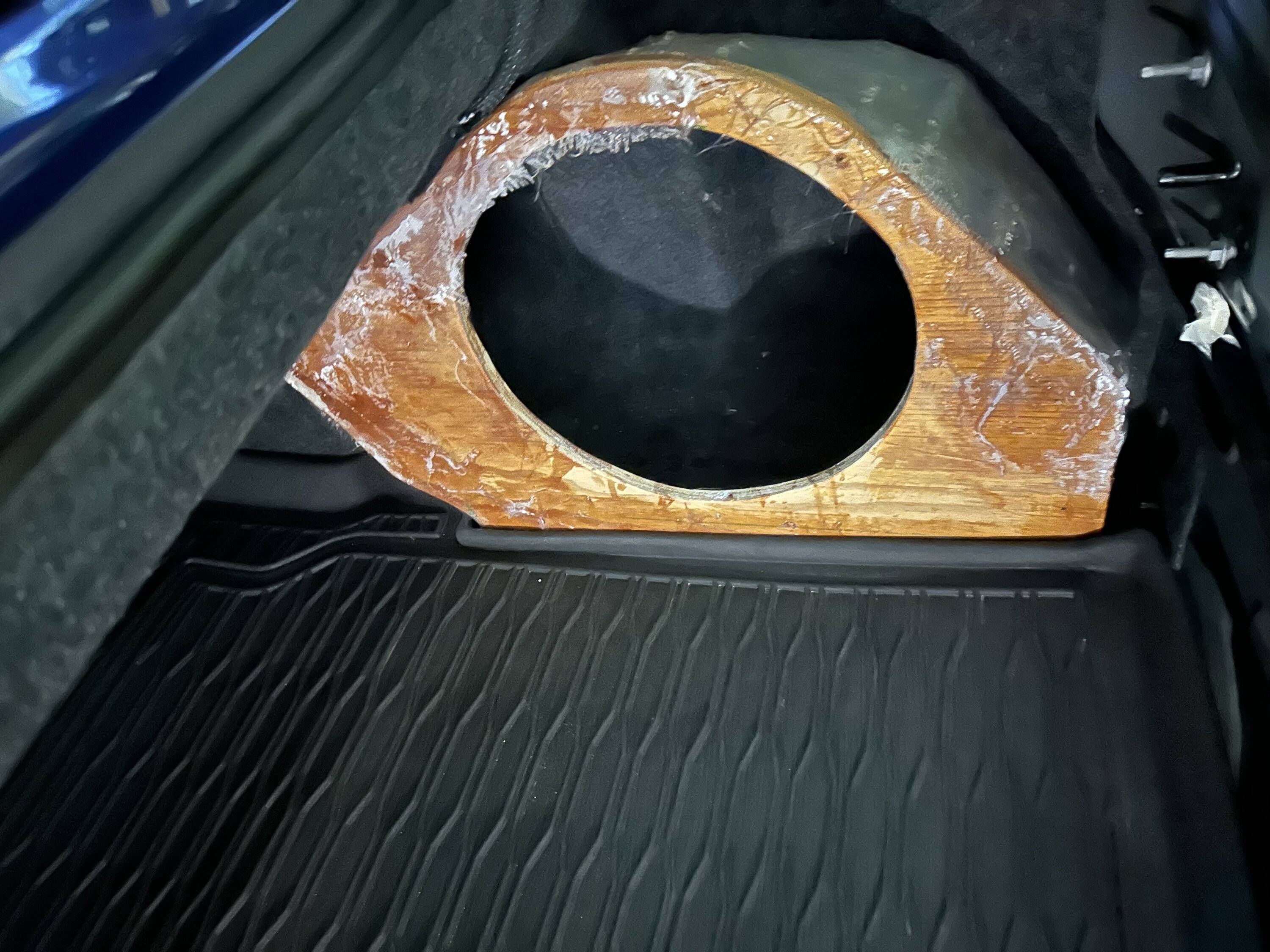

On my way to building a custom fiberglass box!

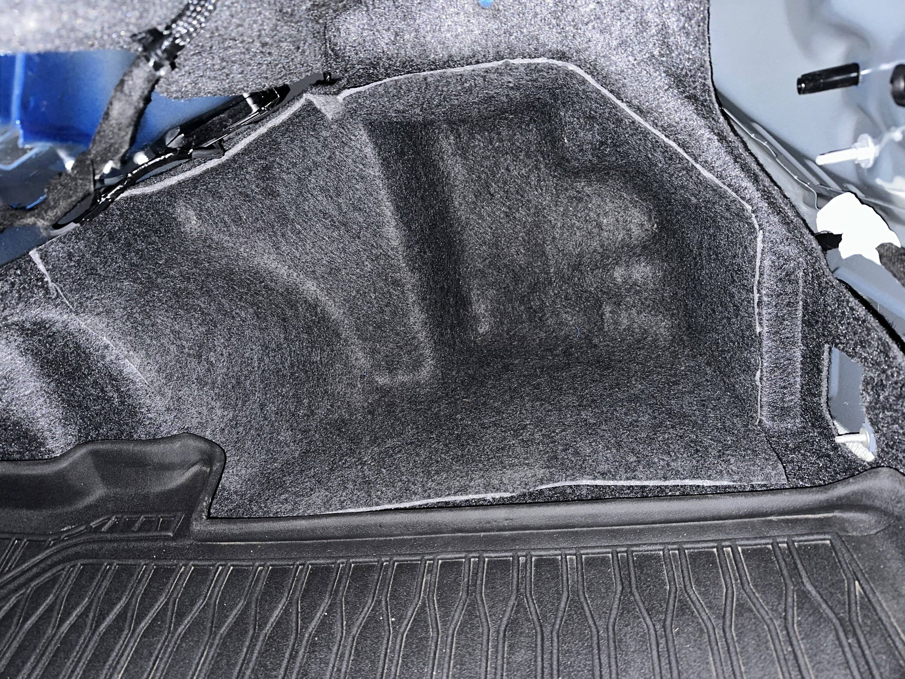

I cheated a little and purchased the right side trunk liner out of a wreck for $20 and chopped it up. It fits pretty snuggly inside of my other one.
Already purchased a Rockford Fosgate Punch 2 12" sub and an Alpine 500 watt amp to drive it!

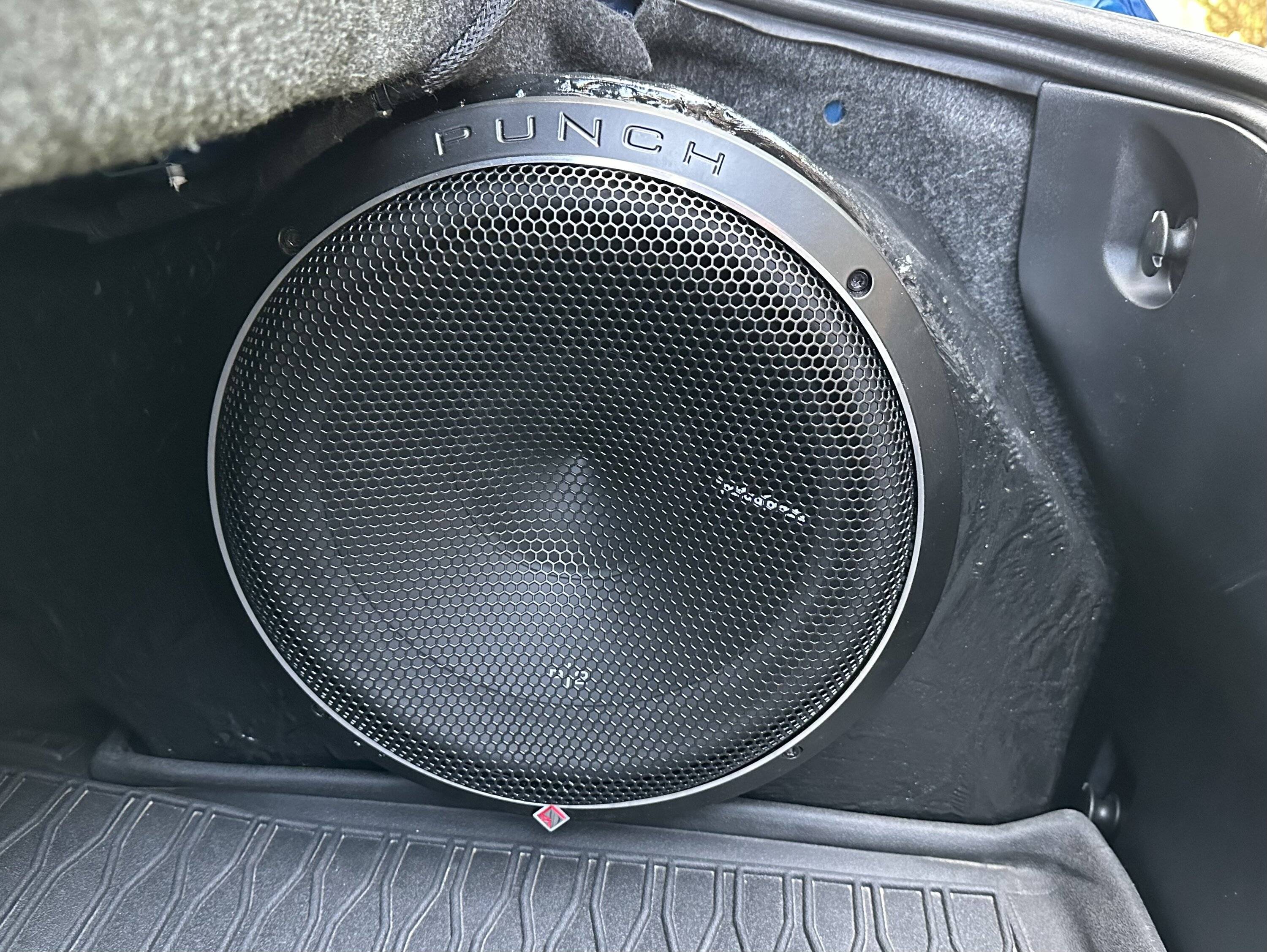

Got it all up and running and I am happy! Thanks to all who blazed the trail and shared their knowledge and experience.
This is not difficult if you are mechanically inclined.

So what did you do to mold the fiberglass?

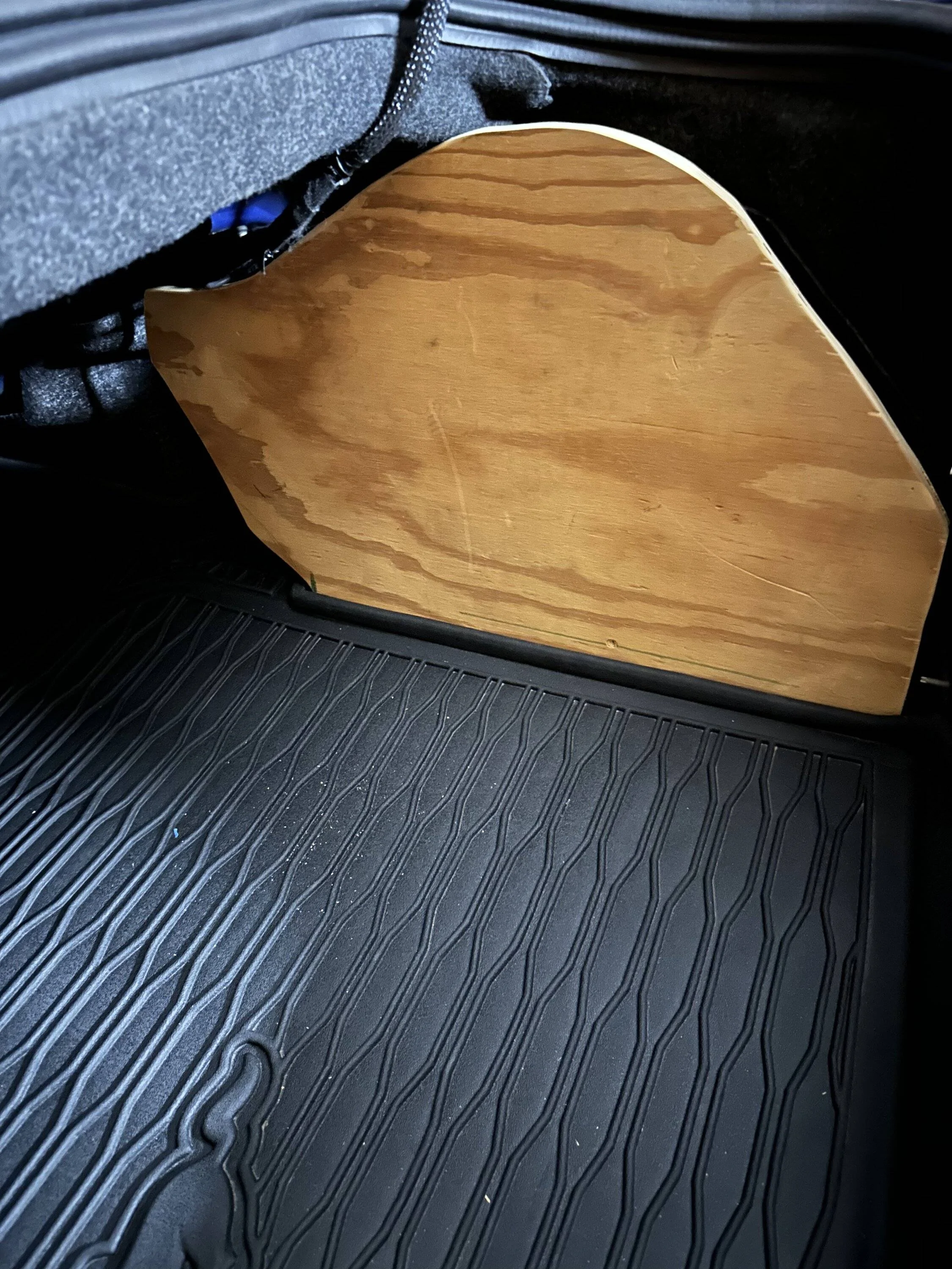

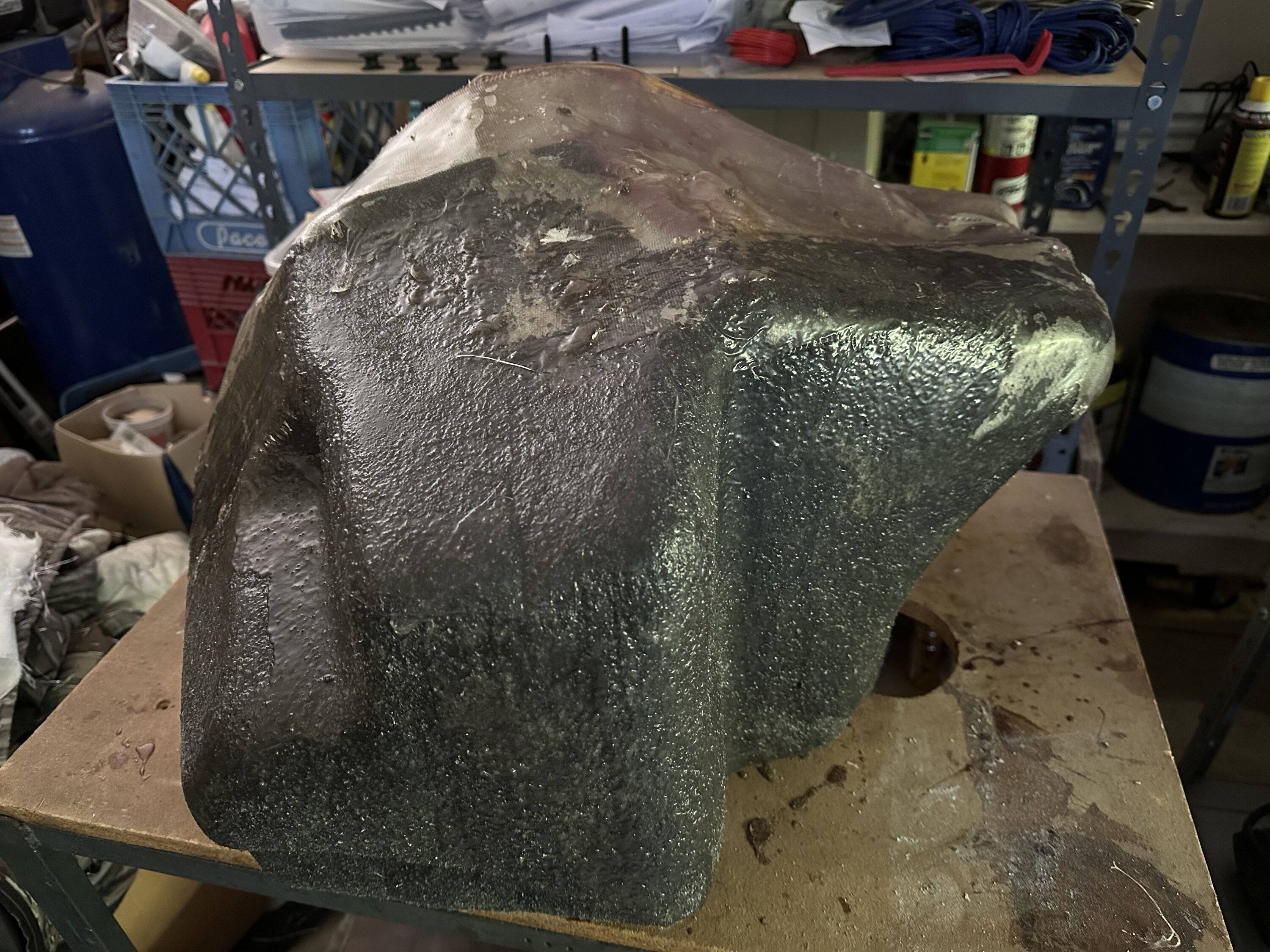

I purchased a rt side trunk carpet section out of a wreck and cut it to fit inside my original one. Then I made a cardboard template for the front that I used to cut the plywood. I put 3 deck screws upwards through the carpet into the plywood then used piece of scrap to hold the top in position. I just started glassing the around the edges and after it was stiff enough I pulled the top brace and glassed that area.
After several coats of resin inside and out the carpet is as strong as any other enclosure.

This way I was able to do all the fiberglass work on a bench and none in the trunk. I didn't want to risk ruining a brand new car.
It is very tight inside that cavity.

Great idea using an extra oem trunk liner as the box back.
