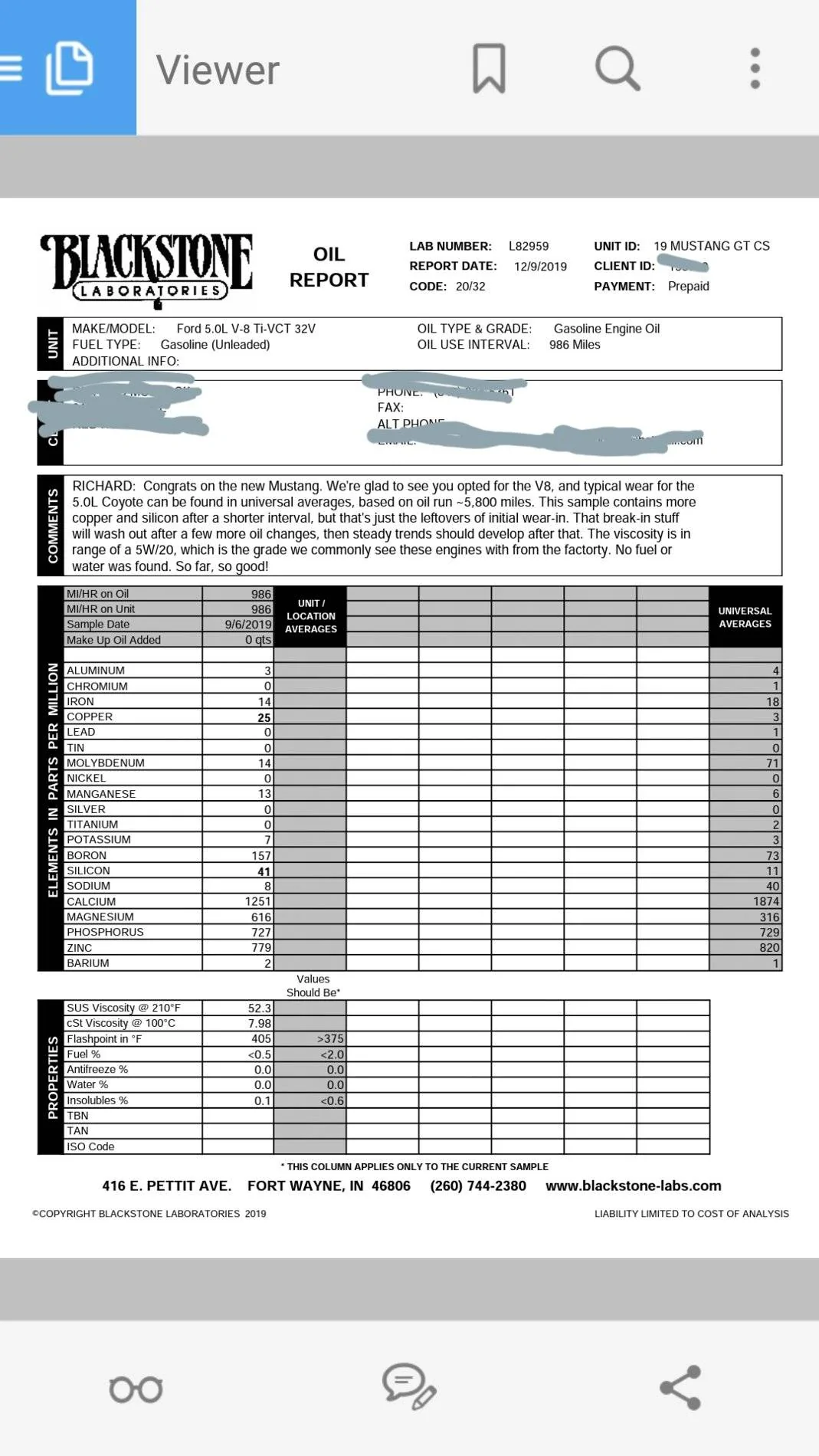

Greetings. I changed the OE oil at 986 miles and had an oil analysis done. High copper and silicon but everything else good. Typical for first change. I specifically asked them to tell me the OE oil weight and it IS 5W-20. I really only changed because I expected that the oil might be more contaminated, but it was a lot better than I thought it would be. Replaced the oil with Motorcraft 5W-20 bottled oil. Happy, so far.

You're welcome. I expected the high copper from valve guide wear (32 guides) but I was a bit surpised when the aluminum, chromium and iron were lower than the universal standard for that engine. The salesman ran it hard for 12 miles (pissed me off when he admitted it it). I took it into the mountains and pushed it on the hills to seat the rings, so I cant say things were easy on the engine but I believe I did seat the rings, properly.
I replaced the OE oil with bottle 5W-20 Motorcraft and I'm going to analyze the oil, again, later. Engine is extremely quiet at 1800 miles, change was at 986 miles.

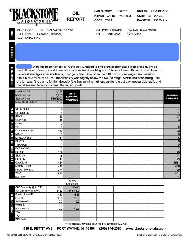

In April, I completed Skye's first oil change. I sent a sample to Blackstone; they received the sample on 03 Apr and completed it today, 15 Apr 2023. Attached is the report, which is very similar to the OP's. Accounting for the additional mileage (900+ vs 1200+), they are near identical.
Two elements were higher-than-normal: copper and silicon. For a factory-fill, newly broken-in engine, Blackstone considers these higher readings normal.
Along with the OP's analysis, I've found postings of other Ford engine owners, low mileage or recently broken in, reporting higher-than-average copper.
One analysis does not a trend make. The expectation is, over time, readings will stabilize. See the Blackstone comment, which says it could take another oil change or two for things to come in-line with the Blackstone baseline amounts (engine at aprox 5,000 miles / 8,000 km).

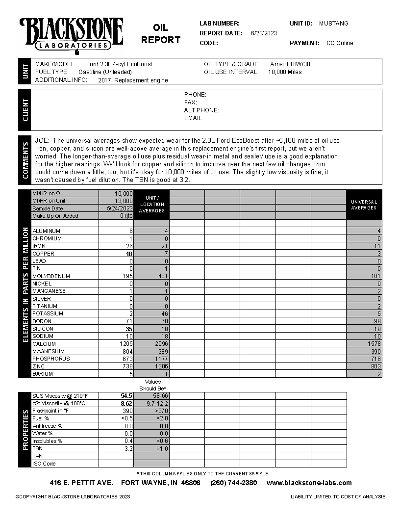

Copper and Silicon also in my early analysis. This was an extended run after changing the original oil at 3,000 miles.
I typically get TBN/TAN evaluations, but for different reasons. I usually run a mixture of Redline Race oil with Redline street. The Redline has a tendency to show higher acid levels and with less detergent than typical oils, it won't necessarily go as far before needing to be changed. I'm also a believer in running engines through the full rpm range right out of the box.

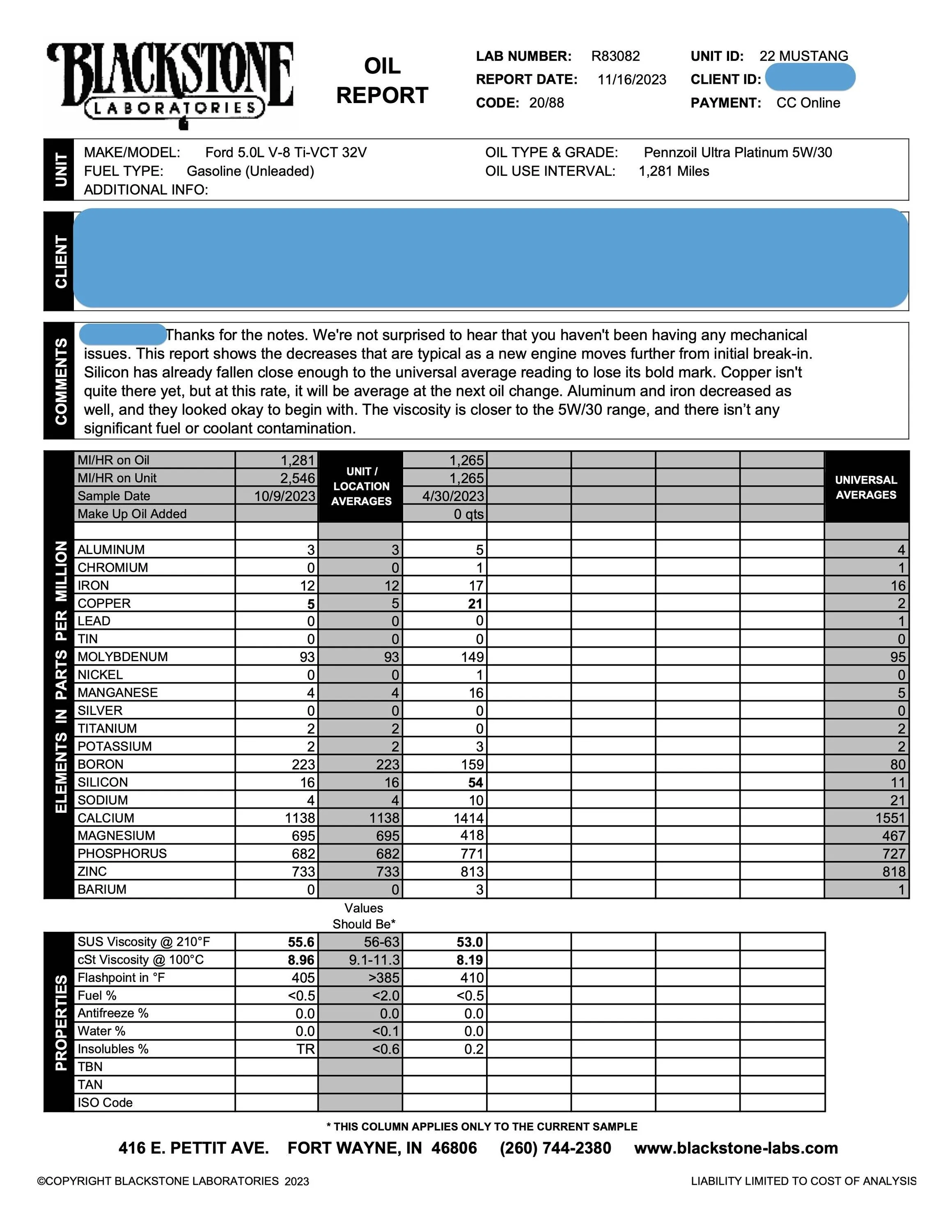

This thread is nice to display and detail what goes on within a new engine or the results of an analysis. Attached are some recent findings to add to that.
Several commented of a flushing effect present in any new engine. That can be seen in the attached. Contaminants leftover from machining, the build itself and break-in, take several oil changes to be removed. Even when draining the oil and removing the filter, there's still .5 quart / .47 liter plus of oil left in the engine. If a cooler is being used, more still.
The analysis highlights the lessening presence of the factory fill and the arrival of Pennzoil Ultra Platinum. I believe it's a good idea to select one brand of oil and stick to it. The results show what all goes into designing an oil.

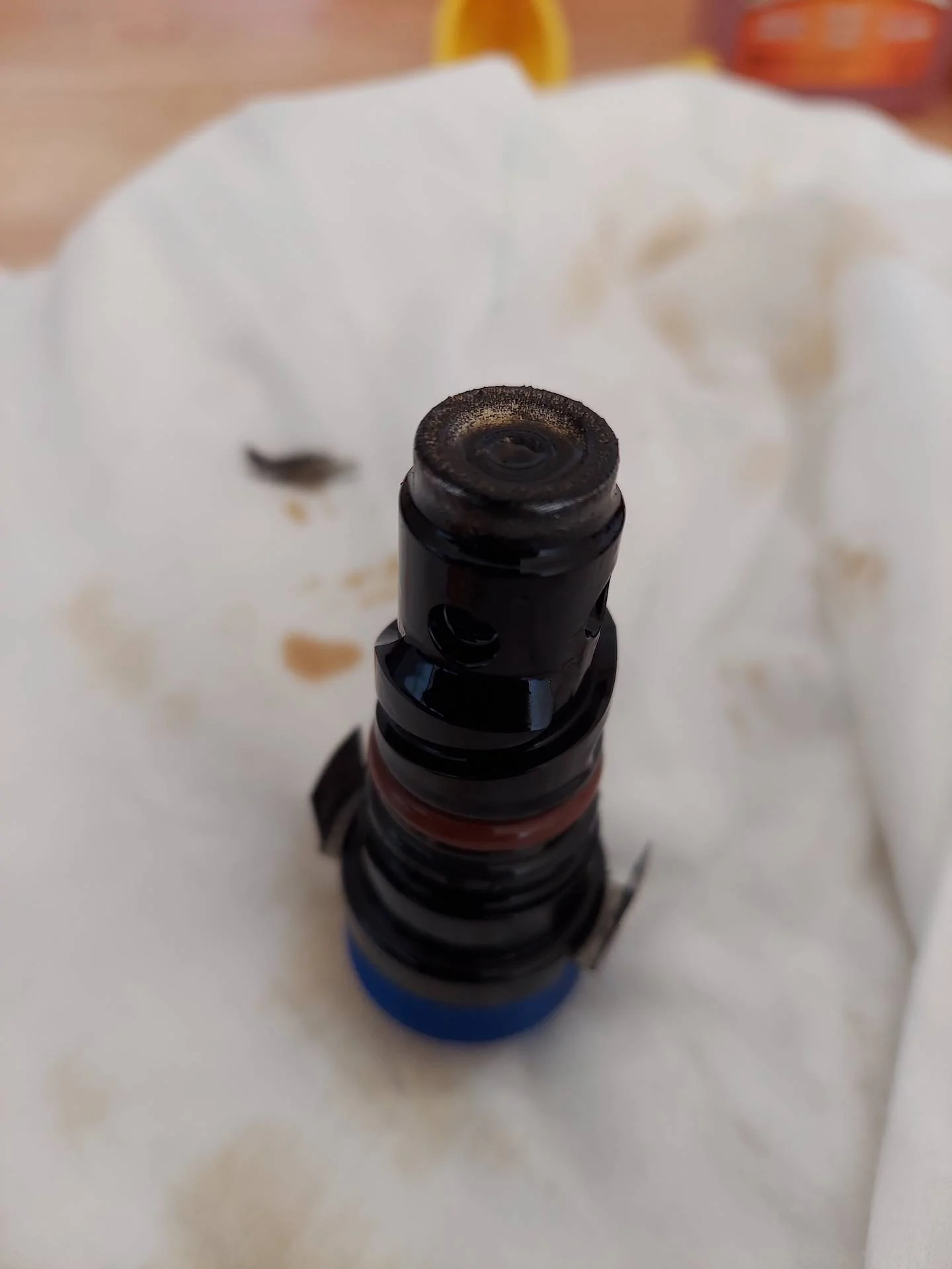

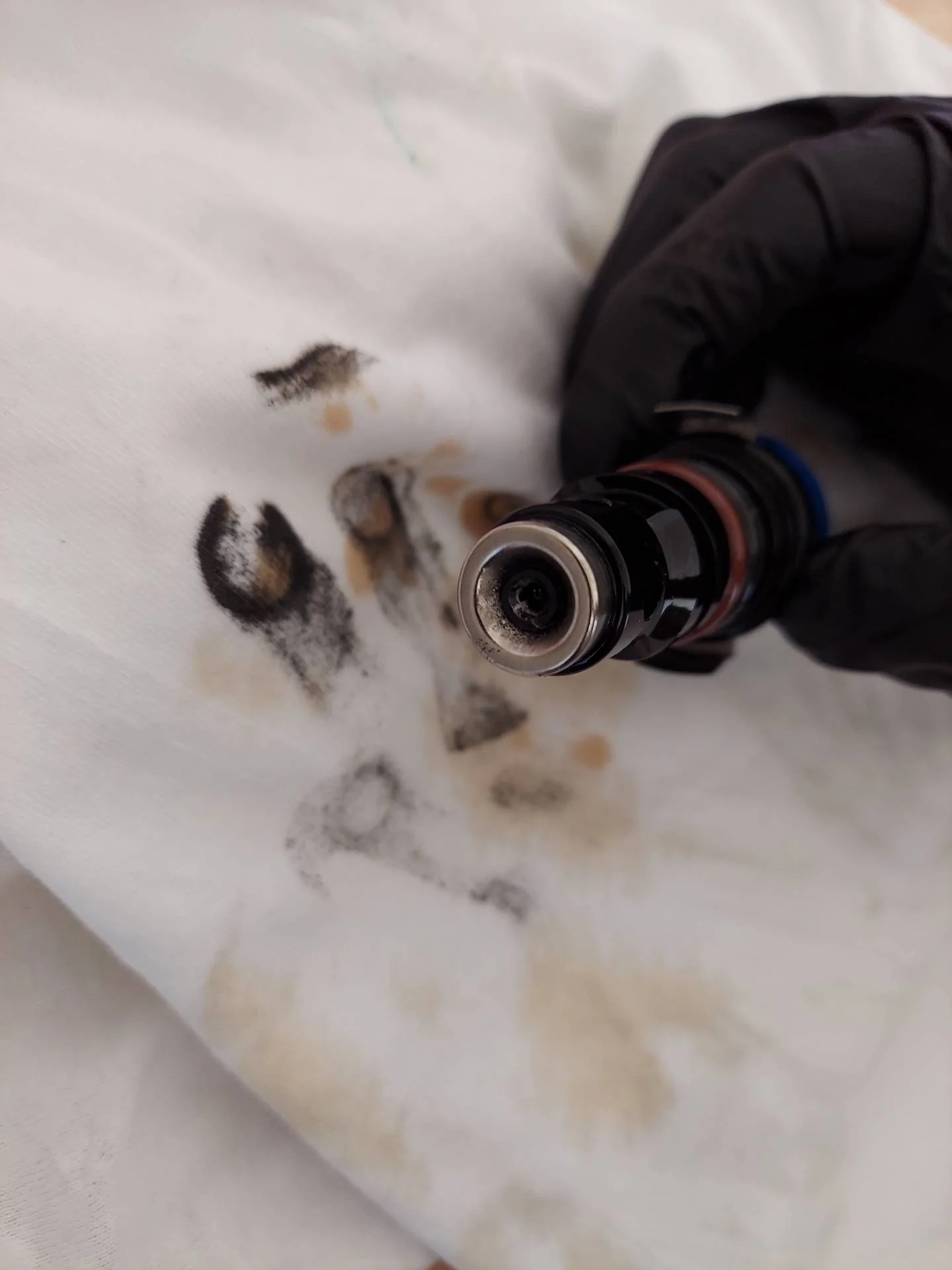

Attached is a photo of the UPR drain plug, installed during the first oil change. The material on the plug was quite course and black. Reminded me of piston compression rings, but it's mix of leftovers and the internals shedding material. Happy to see it. It confirms the components are wearing in. I expect to continue to see material, but in lesser amounts and/or finer particles.
