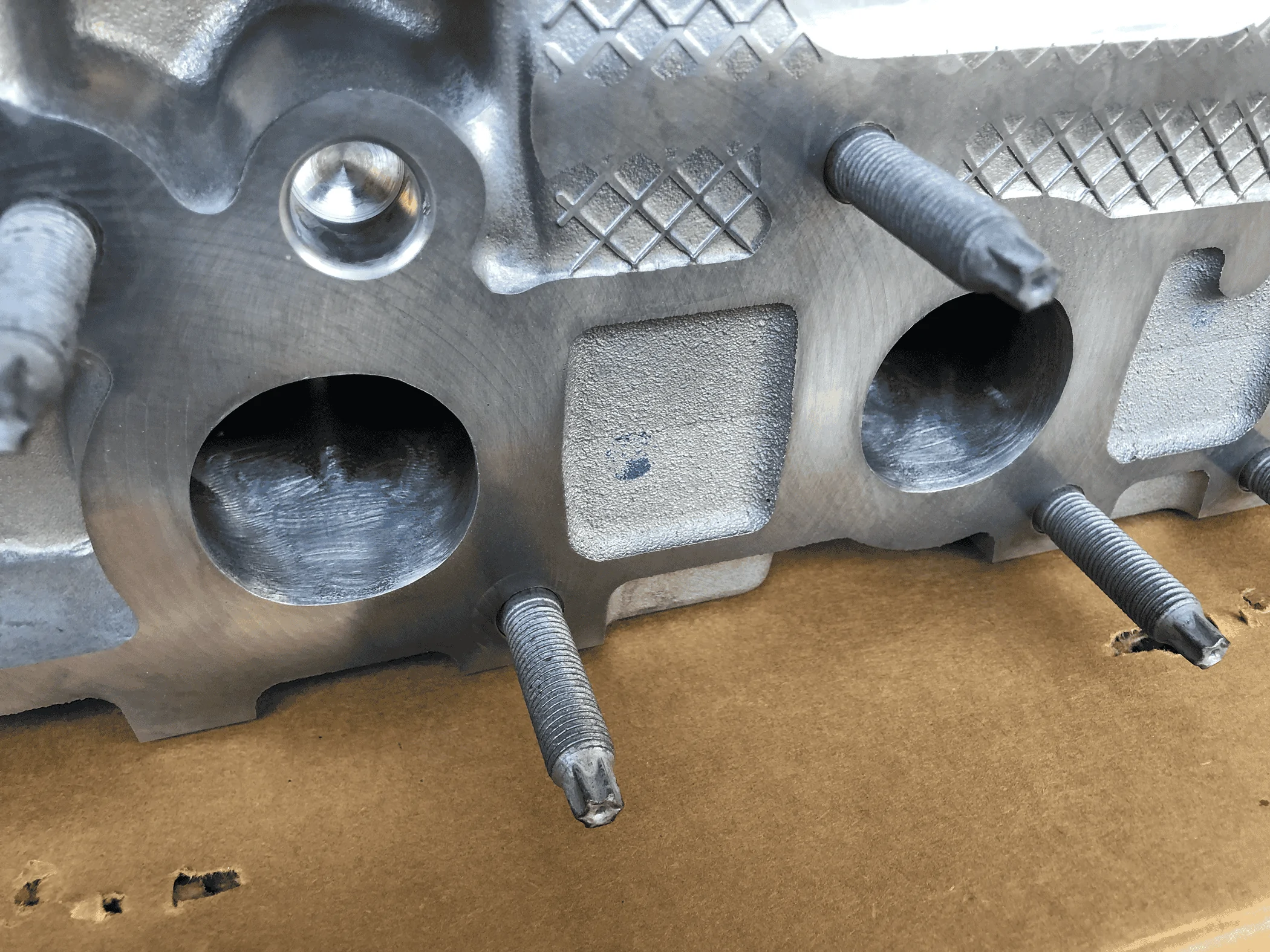

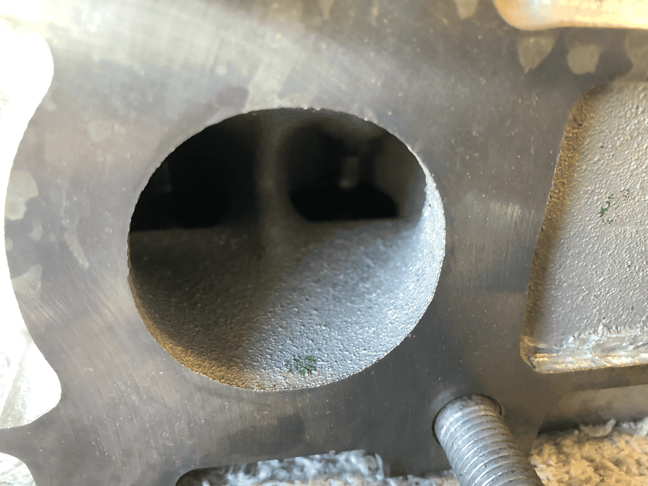

Remember, the 18+ mustang head ports are "cast" gt350 ports. Same port design, just "as cast" vs being CNC ported.
That said, they do have some casting flash in stock form. However, you can see the valves are already unshrouded pretty nicely from the factory and the casting flash is easily removed by hand in a few hours max.

That said, they do have some casting flash in stock form. However, you can see the valves are already enshrouded pretty nicely from the factory and the casting flash is easily removed by hand in a few hours max.
Ahhh yes. Did you know that roughness in the port actually keeps the fuel suspended ? However t's worth polishing the exhaust port to limit carbon build up. Leave the intake un-polished to aid atomisation.
