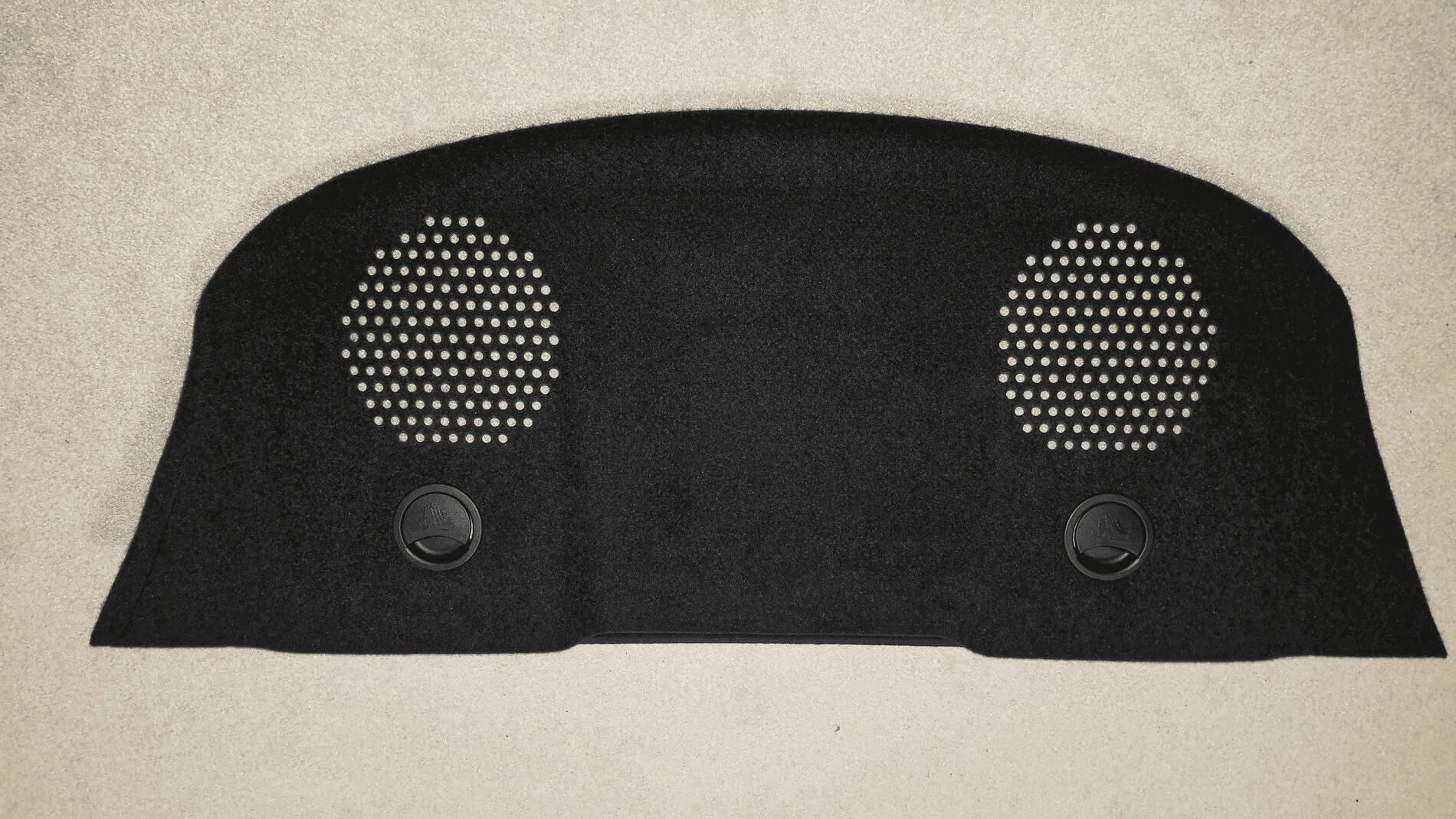

Face woofers to the rear and remove the rear deck speakers to serve as ports to allow the sound to enter the cabin without having to lower the rear seat backs.
Isn't that going to cause lack of audio? Removing the 2 speakers? It's a base speaker system so I don't have 9 speakers like the premiums have.

No, the rear speakers don’t do much at all. I only removed one of mine, but I should have removed both. If I ever have to remove the interior trim panels again, it will come out. I removed my center channel speaker as well and that was also an improvement.

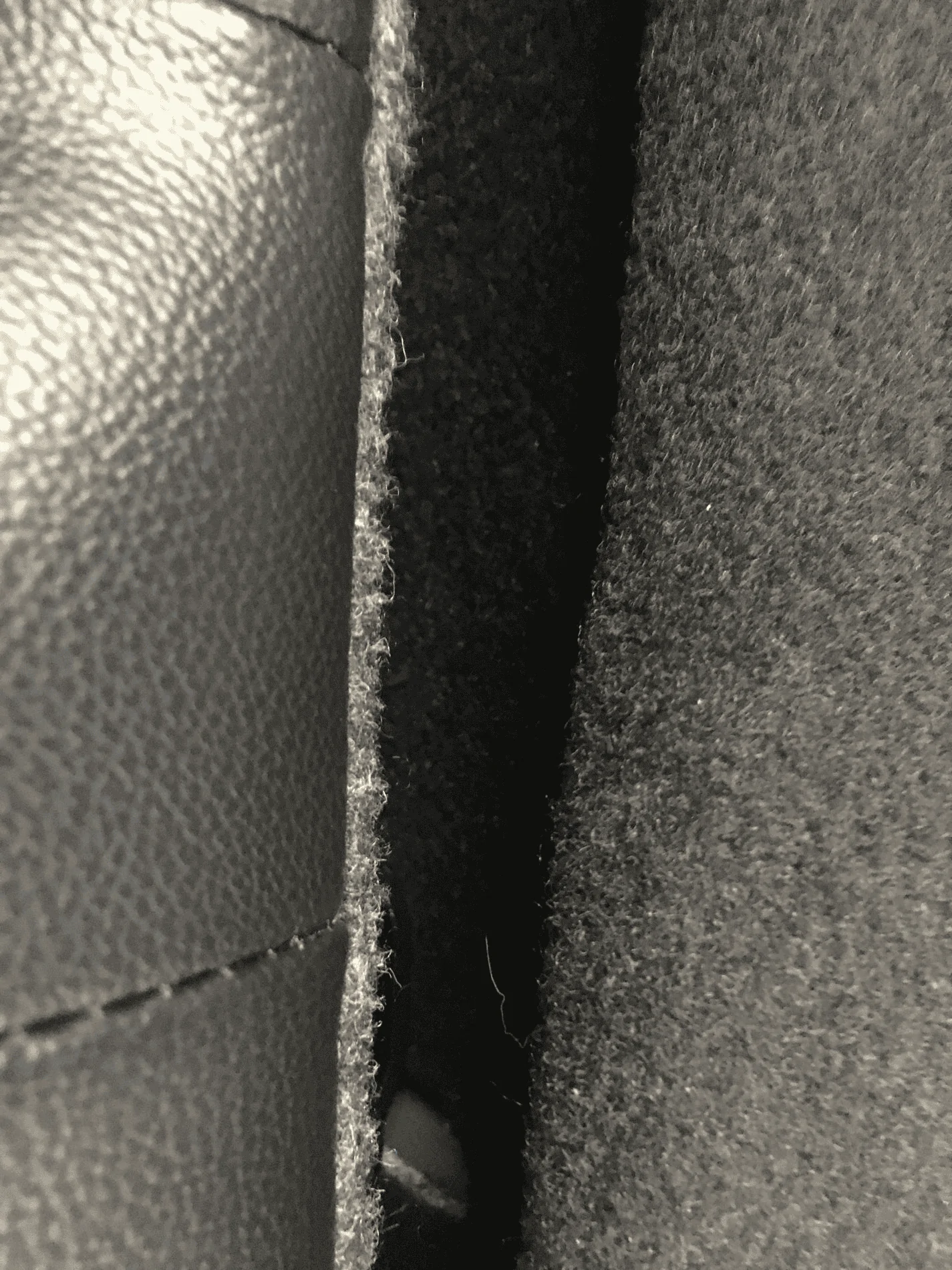

Subs should face the rear when you have rear seats. The rear seats will kill the output from the subs (unless you create a gap for the rear seats using spacers under the latch). See: Best way to get bass to pass into cabin . If you do a rear seat delete then the best way is subs facing forward for and you can upgrade your rear speakers. The OEM ones back there absolutely suck and the carpet over them doesn't help matters.
The rear deck also kills the output from the subs. The whole back of the car chokes off the sound (I measured the effects) so you need to open up the rear deck and do what I did regardless if you want rear speakers or not. IMO any rear speakers are a waste of money: Forum Post

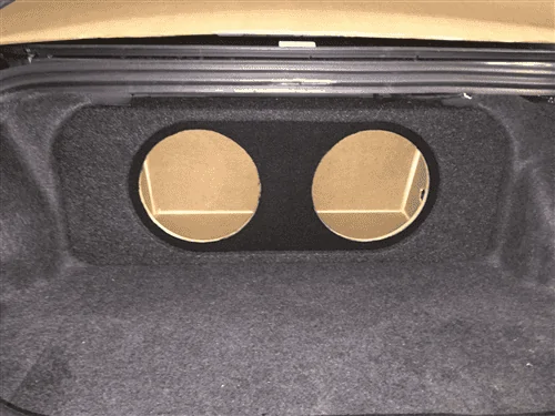

Also, zenclosures have pre-made boxes for the Mustang. Members who have purchased them say they fit tight and don't move around.
