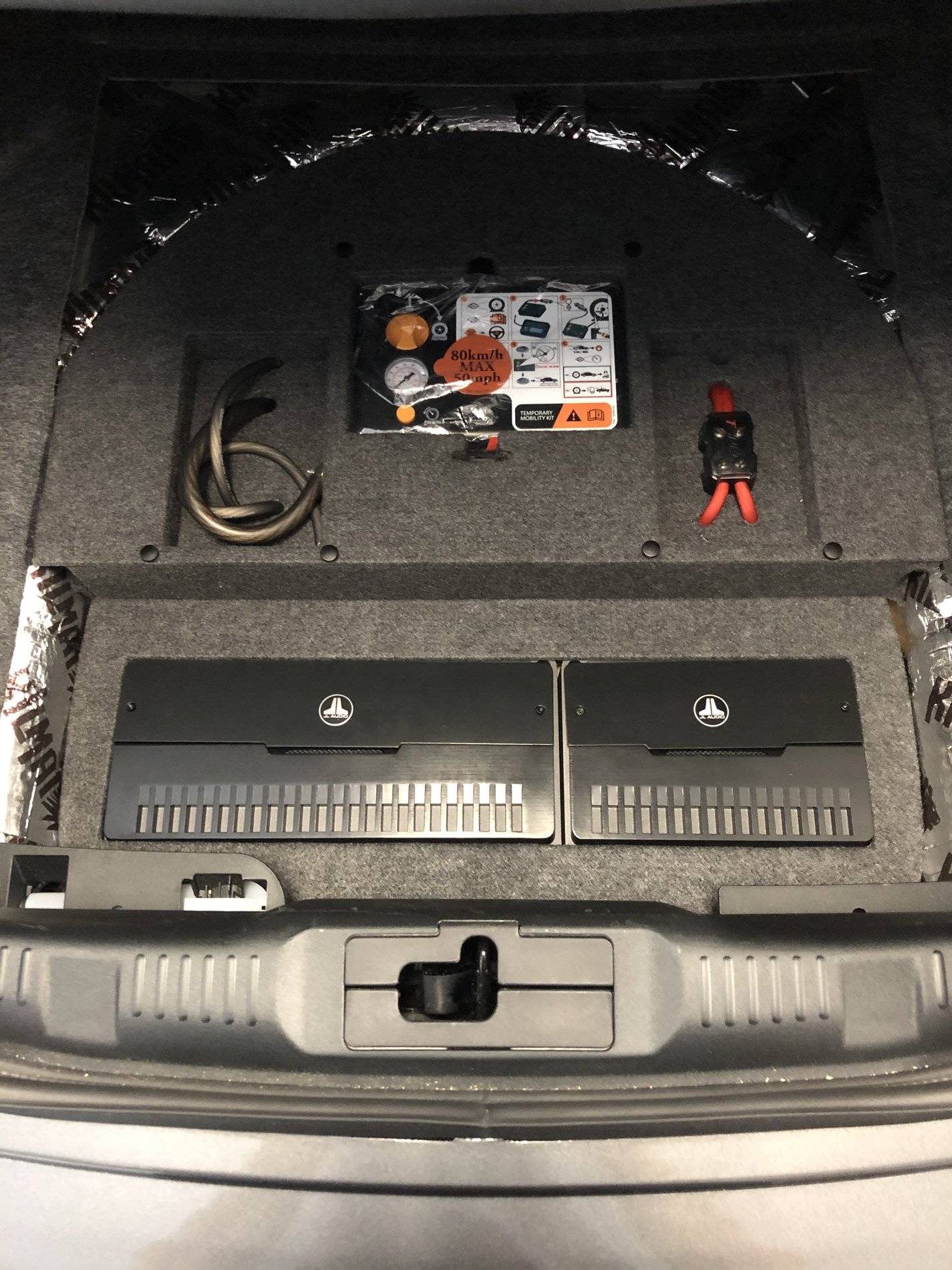

I just finished an amp rack and I used charcoal gray felt from JoAnn Fabrics. I used the same felt in my ‘15 V6 when I built a fiberglass sub enclosure. It’s real close to the OEM carpet in the trunk, and easy to work with because it doesn’t have a backing on it.

Nice job. Most people don't bother to hide the wiring in the trunk. I like how you did that. Do you have any more info on your build? I'm currently doing mine and I am now at the stage of pulling the trunk panels and adding the dampening (a have a huge box of Killmat) and I am still deciding if I want to take the extra effort to have it all neat and pretty or just basic and functional.

Thanks StangTime. I bought the same huge box of Kilmat because of your post! :) I plan to post a build thread sometime today. I think I did a couple of unique things that I haven’t seen done before, so hope to help out where I can.

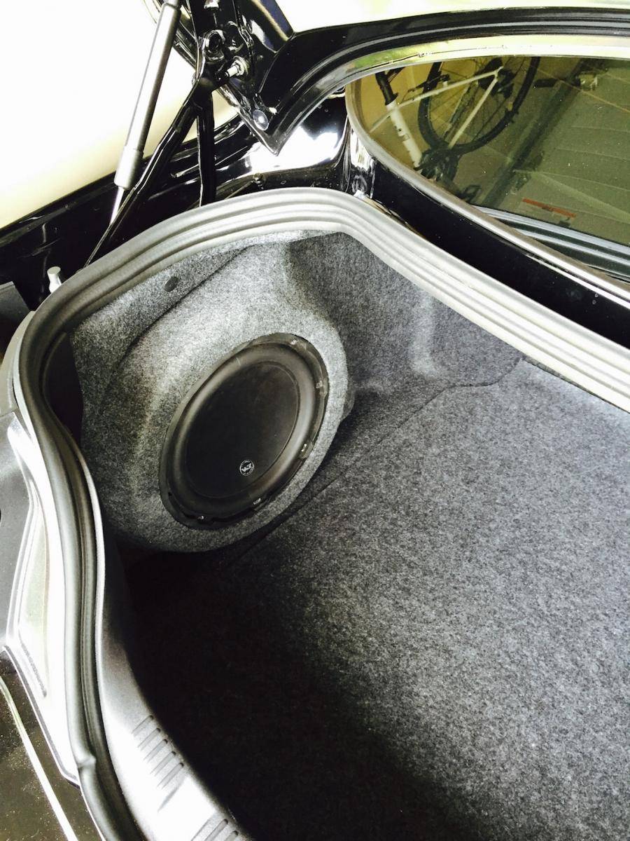

This is the fiberglass enclosure I built with the charcoal gray felt, up against the stock trunk carpet. Hopefully that gives you a better idea of what it would look like. I thought it it was pretty darn close.

That looks great! Charcoal gray felt from JoAnn Fabrics, huh. And it looks like it stretched over the contours pretty nicely. I'll have to run over there and see if they have the same thing at my local JoAnn's. Pretty easy to work with? Glued it in place?

Yes, it’s really easy to work with because it has no backing- it easily stretches around contours, corners, etc. I used 3M spray adhesive to glue it down. Got that from Home Depot.
