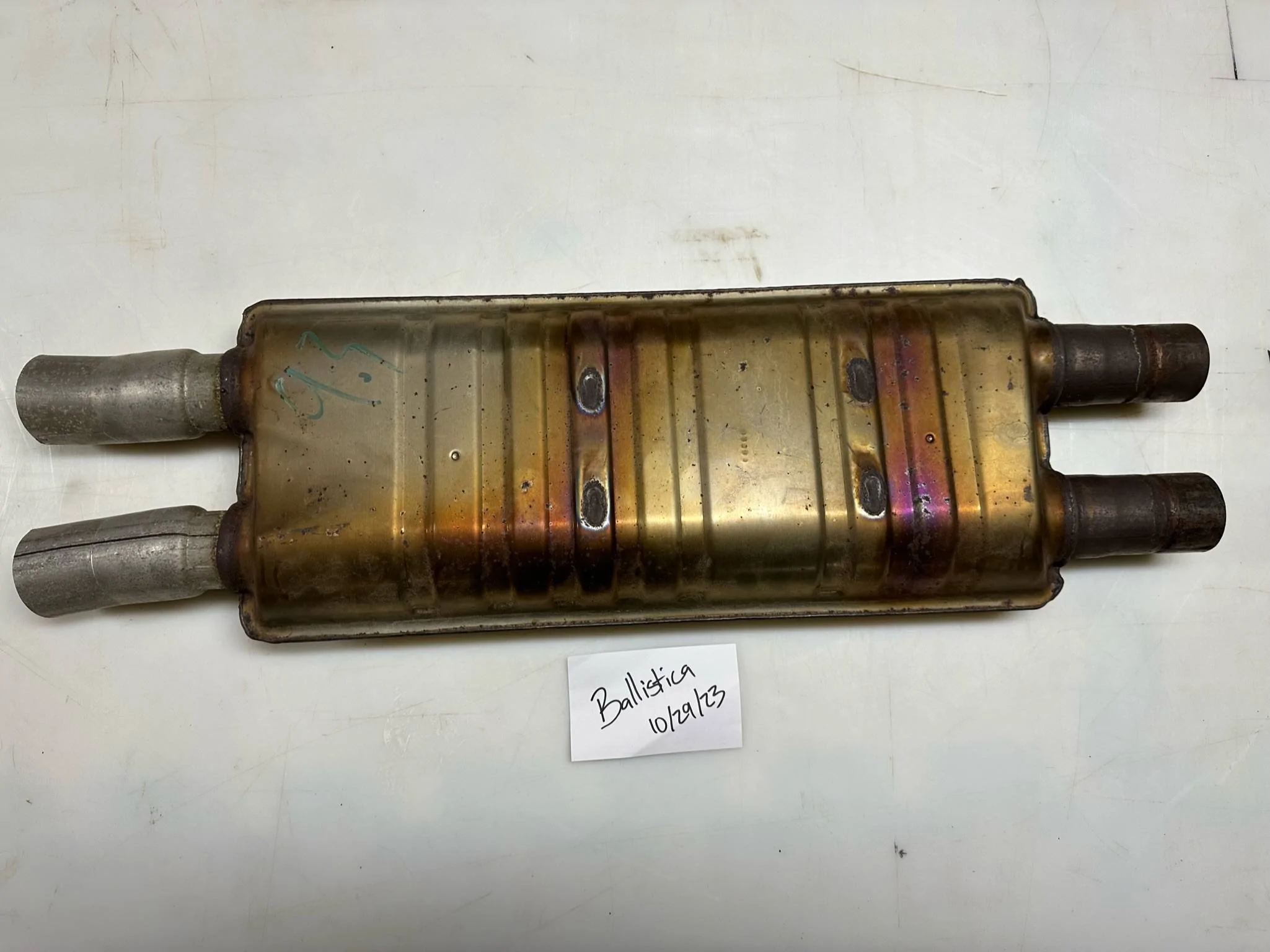

There is a (easily removed) 2.0” restriction in the GT (and Mach)
WD :like:
15-17 only
Gen3 18+ received a size increase in that area.
I'm a 2020 ... ?
I know I'm a euro, but we get the active exhaust which is a single piece (so defo a facelift part).
The mufflers are identical to a USDM as I checked the stamped part numbers to other photos I had found on here.
I still have the resonator, so we can cross check that part number with a USDM car (if it's important) :like:
WD :like:

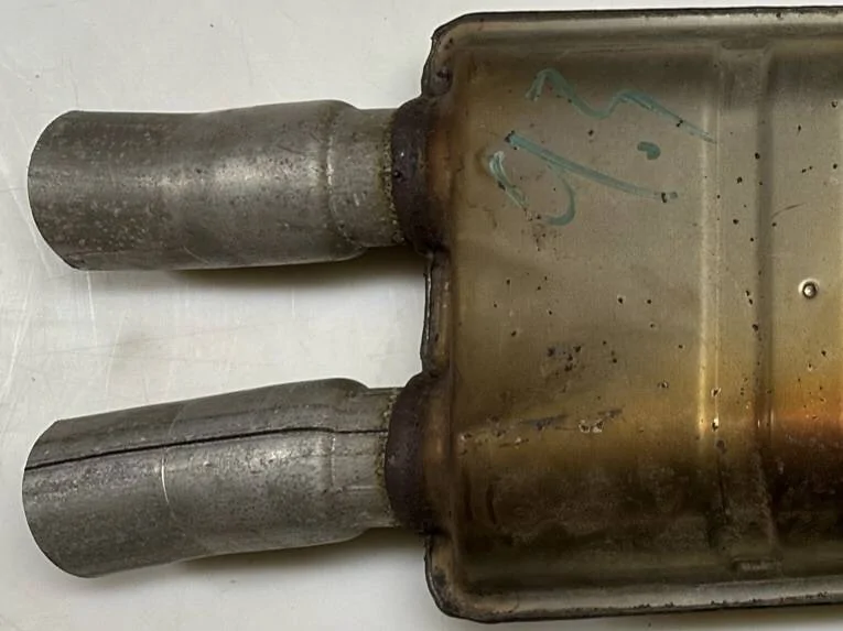

I’m referencing the diameter of the front flex joint. Are you referring to another area reduced to 2.0” ?
Yes, from my post above :
"Diameter at resonator outlet joint = 2.00" (removed with resonator delete)"

By chance, I came across this in the classifieds from @Ballistica - removed from his USDM 2021 GT PP1 :
This is the 2.0” pipe section (same as my 2020 euro GT) :
