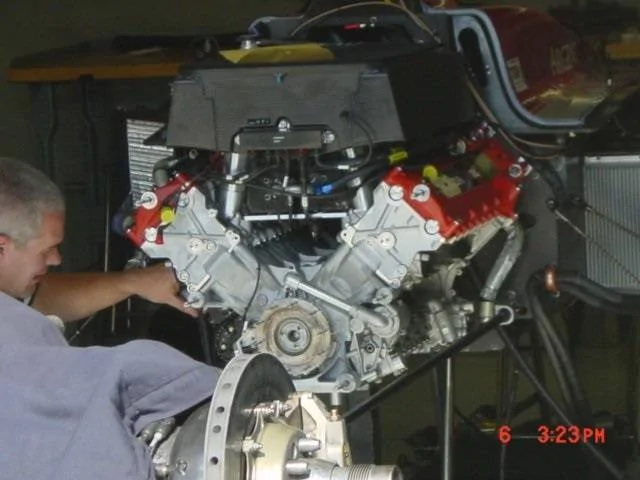

When I worked at Mazak they brought their sponsored Indy car into the Florence Ky factory for some kind of shin ding. We got to inspect it real close. We also set up a multi tool CNC machine that fully machined engine blocks. It was cool watching it work on the test blocks.
This was before cell phones and camera's were not allowed.
