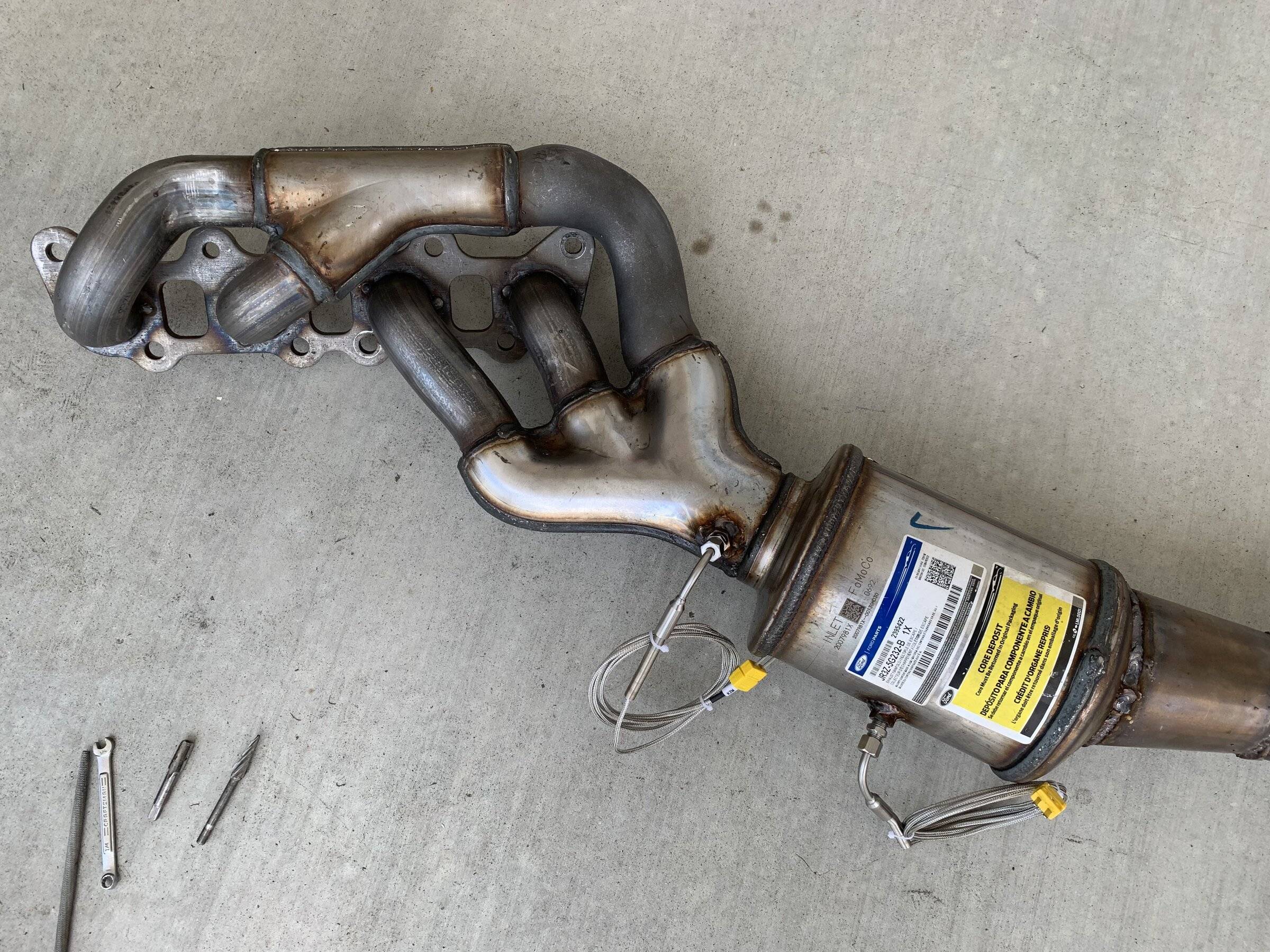

If I read the graph correctly you lost 5 psi of back pressure by using the 4x3 on the cat along with getting rid of the 2.5 inch pipe.
At what mass flow rate is this?

Did you take a wiz wheel and cut off the cap on the cat?
How much did this reduce pressure through the cat?
Last, can it be done on the car?
I'd like to just dump the cats but my extended warranty requires all emmissions to be installed and working.
The first time, I cut the cat using a band saw then cleaned up the hole with a bur bit. The second time I used a cutoff wheel to cut the prior weld. You have to fit up the reducer at the desired angle then mark it and cut it. Can’t be done on the car; at least not by me. In fact, it requires several iterations…cut small pipe off, install cat, fit up reducer and mark cat, remove cat, cut factory reducer, install cat, tack on 4x3 reducer, remove cat, weld out reducer, install cat. However, on these cars, pulling either cat and re-installing is super easy. The hardest part is getting the driver’s side of the car high enough.
The last test data was on a Whipple and 3.375 pulley, about 15 psi boost and well over 90 lb/min flow. 1.8-1.9 load at 7400 rpm.
